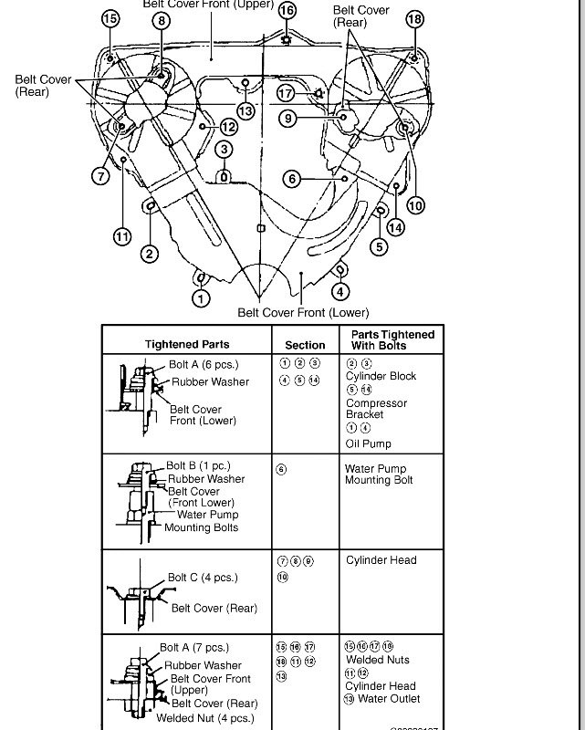

I have a leak coming from the water pump! How can I fix this? Thank you!

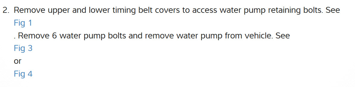

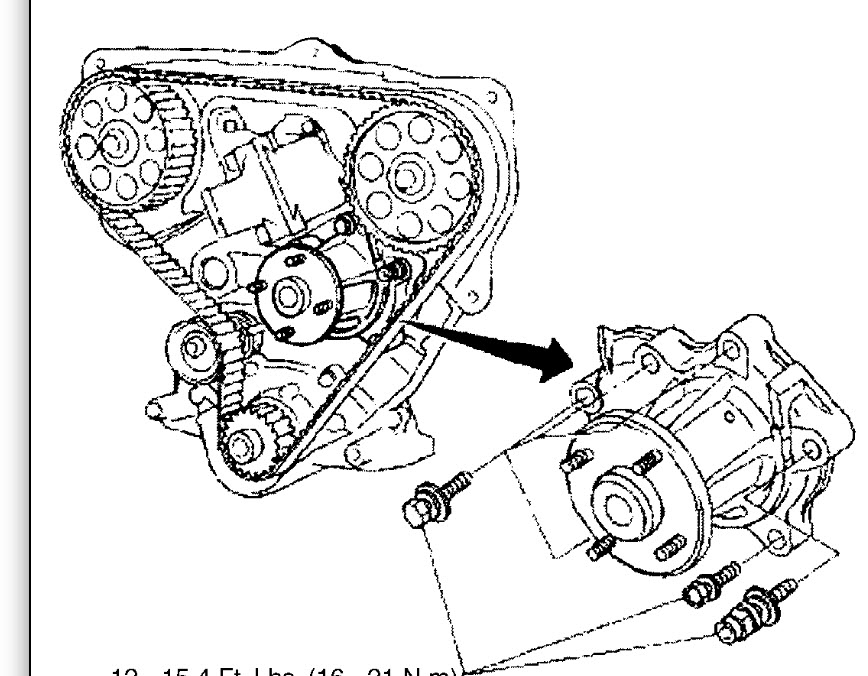

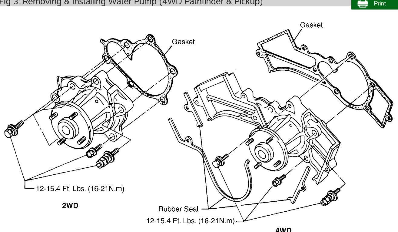

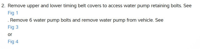

if it leaks then it should be replaced. see pics for instructions, install is reverse of removal. Check out the diagrams (Below). Please let us know if you need anything else to get the problem fixed.
