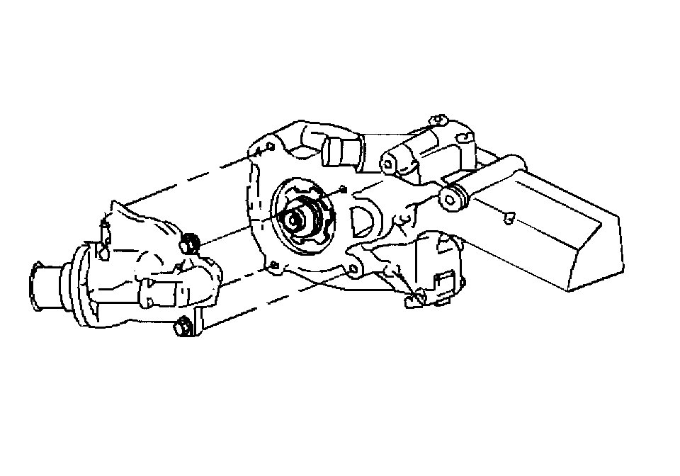

I managed to remove the waterpump on my car with minimal issues and used the special tool to accomplish this. On the flip side, installing the new water pump has been most challenging and I’d appreciate any feedback or tips that can help me get this done.
Using brand new OEM ac Delco water pump as replacement which is the correct replacement unit for my car listed above.
I am positioning the it at the 7 o’clock position (the tooth with the indent at 7) and turning counter clockwise.
I’ve used 2 ratchets, a breaker bar, and other different tools to install.
Today I used a additional bracket hold tool today and still a no-go.
Fasteners and rivets on the replacement and also on housing are not worn and still in good order (had to return 2 water pumps so far!).
Any help is greatly appreciated.
Thank you kindly,
Sonny

I'm not sure exactly what is happening. However, do me a favor. Here are the directions from my manual. See if anything there helps. The attached pics correlate with the directions.
_______________________________________________
1999 Cadillac DeVille V8-4.6L VIN Y
Water Pump Replacement
Vehicle Engine, Cooling and Exhaust Engine Water Pump Service and Repair Removal and Replacement Water Pump Replacement
WATER PUMP REPLACEMENT
Removal Procedure
- Tools Required
- J 38816-1A Water Pump Remover/installer
pic 1

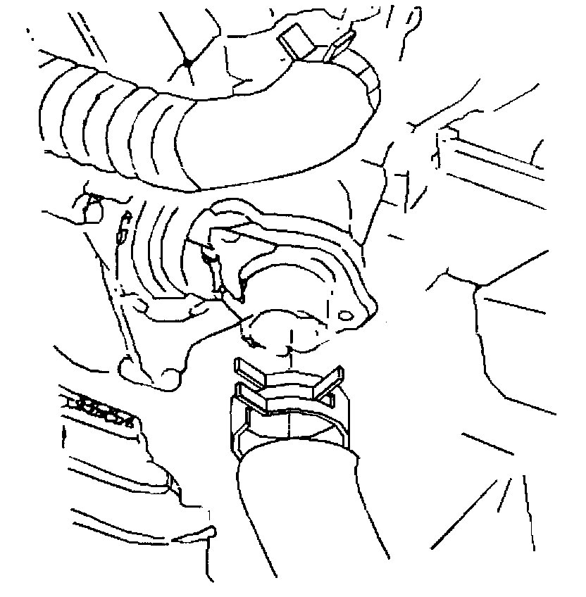

5. Remove the bypass hose.
pic 2
6. Remove the lower radiator hose from the thermostat housing.

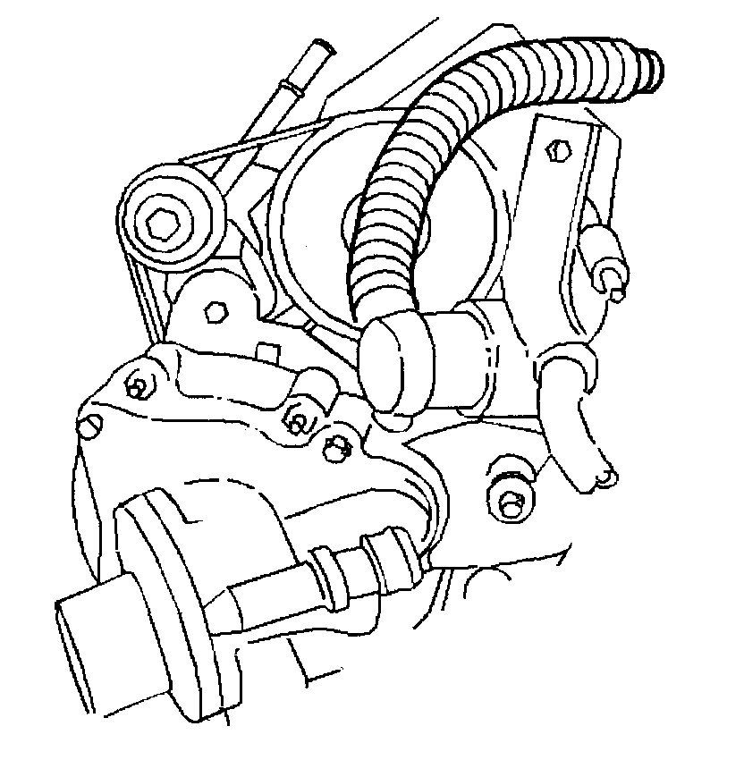

pic 3
7. Remove the bolts from the water pump cover.
8. Remove the water pump cover.

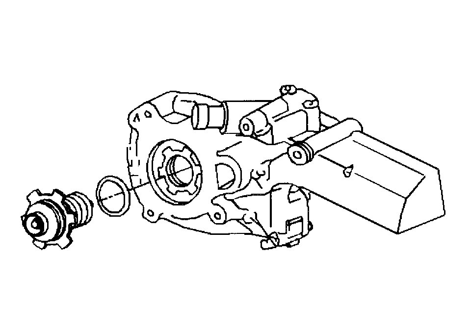

pic 4
9. Remove the water pump, the pump seal, and the gasket from the housing using the J 38816-1A. Turn the tool clockwise in order to remove the water pump.
10. Remove the water pump from the vehicle.
11. Clean the water pump and the pump cover sealing surfaces.

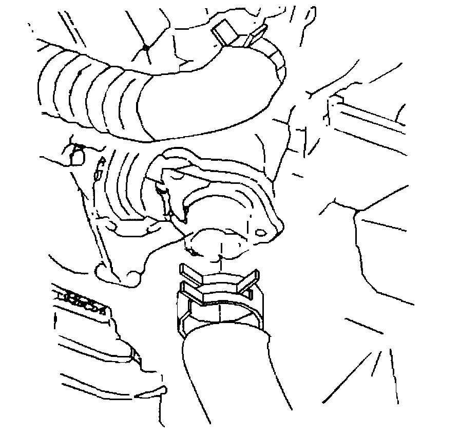

pic 5
1. Install the water pump using J 38816-1A. Turn the tool counterclockwise in order to install the pump.
- Tighten the water pump to 100 Nm (73 lb ft).
