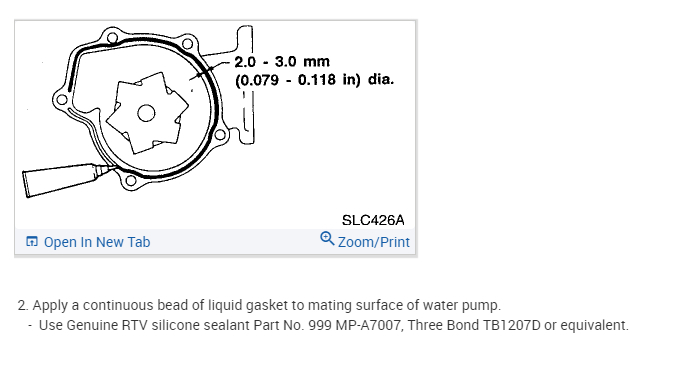

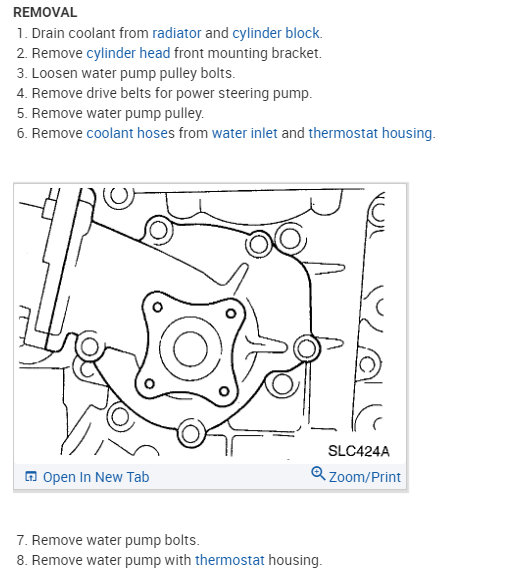

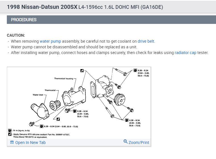

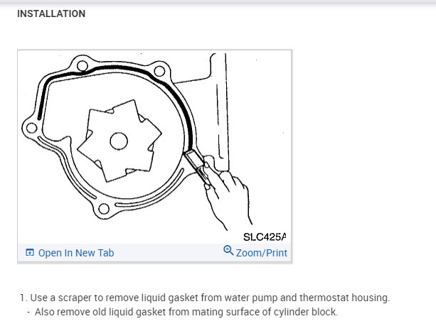

As far as your specific vehicle, I attached the directions below. I hope they are helpful for you.
