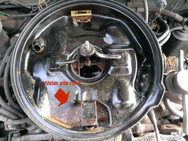

hi i have a problem with water and oil mix (cream) mostly water under the air filter after driving in cold weather around 8 Celsius or bellow it coughs & splutters then stops . i open the air filter sponge out About a tablespoon of water, after about a minute restarts fine run well for little while ( about 1 hour) .then i repeat the proses . thought it was head gasket put in chem i weld (copper based sealer) thinking that it would fix it but problem still there.

may be coming rom engine from pipe in arrow. check filter if there is one and try a different brand of oil. the valve cover or where ever pipe comes from may not have enough blockage for fumes there.
