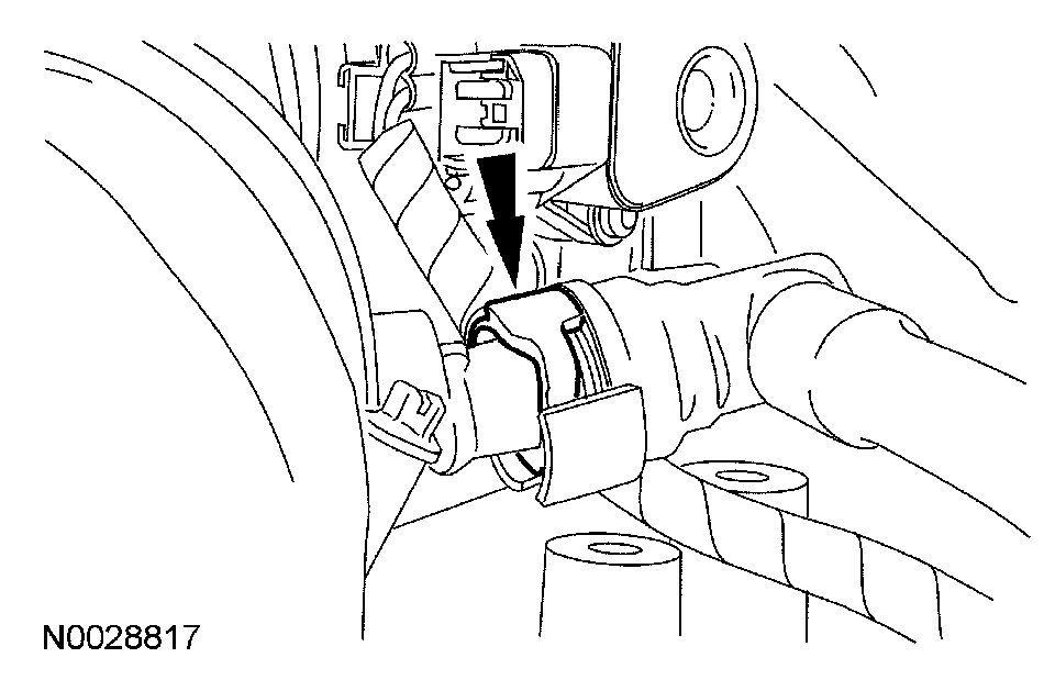

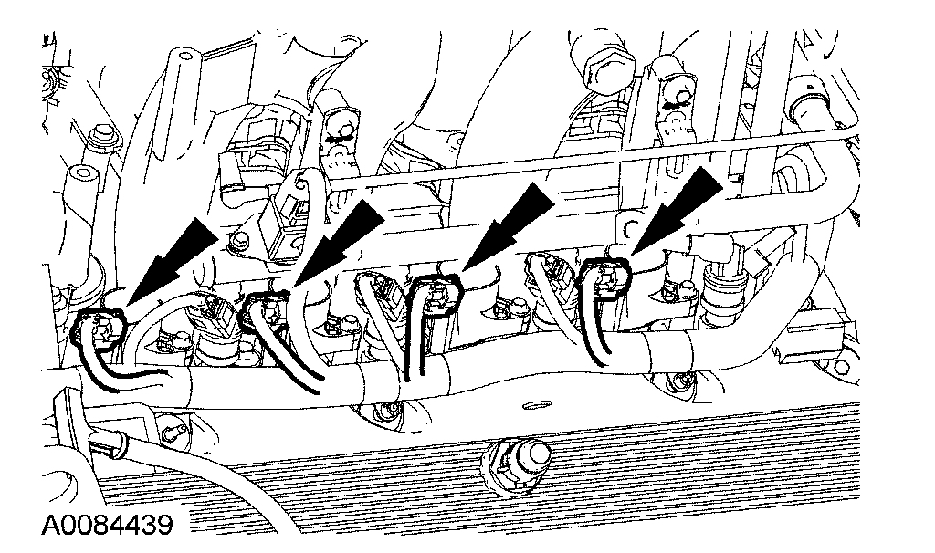

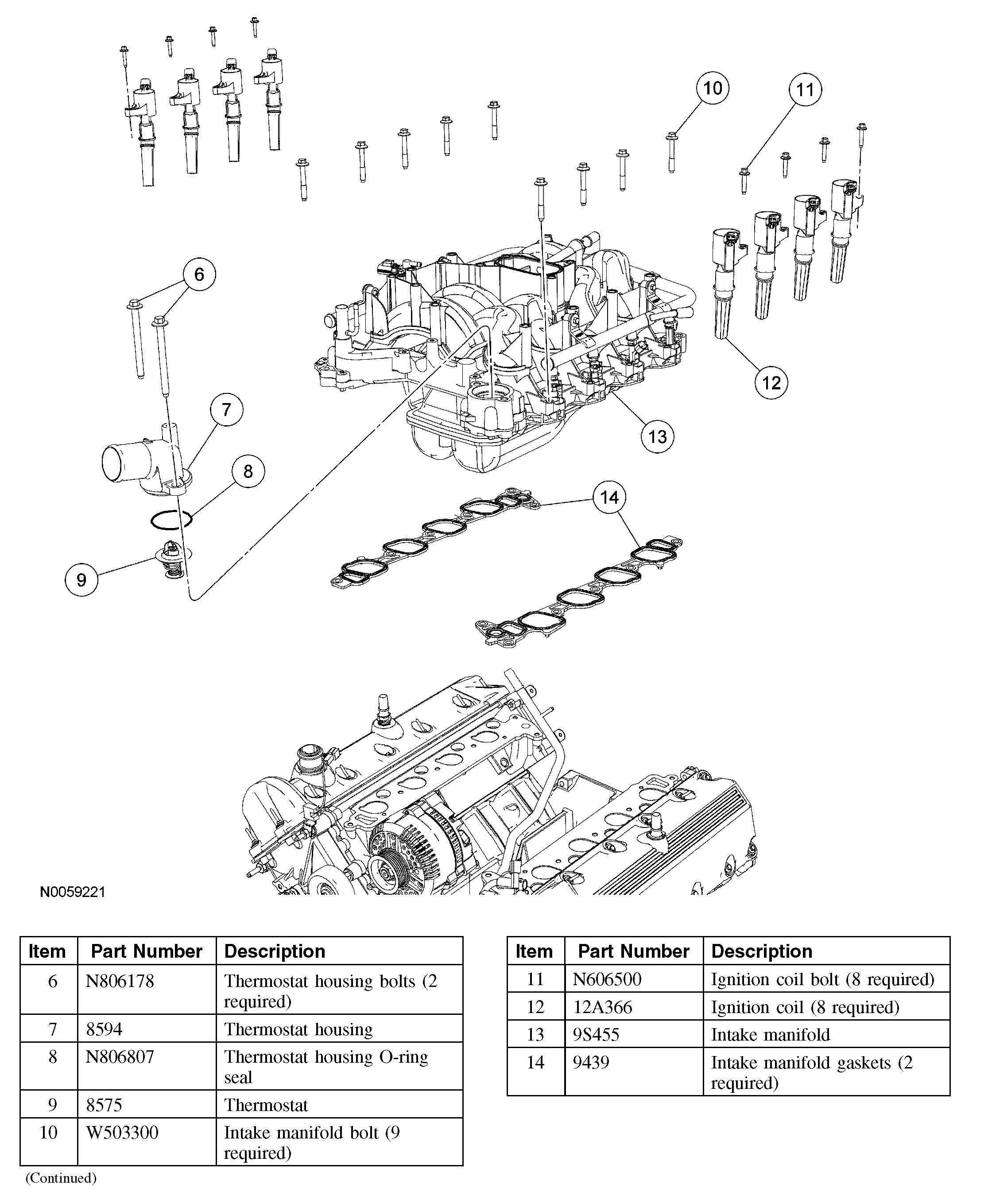

Citing all possible symptoms and circumstances as I noticed them.
First, left the key on and in the ignition which drained the battery. Jumped it and started fine, let run for 35 minutes. Two days later it cranks over fine but continues to crank having a hard time starting. I push the pedal a bit for motivation, it starts. Does this every time it starts with each time starting harder eventually I notice smoke from tailpipe probably because of the depressed pedal for start.. A day or two after initial hard start I noticed the instrument cluster temp sensor not climb as I knew it should. In fact it had not moved other then it's initial movement with the key.
Up until this point there have been no dash indicators, so I slept on it. Next day start it to drive and the red water temperature light stayed on abnormally long before it shut off maybe a total of 1 or 2 minutes. Driving again and still no response from the in dash gauge. This leads me to believe with it's old age and not having it from new it might be time to change some sensors. Is there a more simple solution then changing every sensor. Current plan of action is to change thermostat, ect and cht. I'm having trouble and seeing mixed data on where both ect and cht are located for this 2007 E-series 5.4.

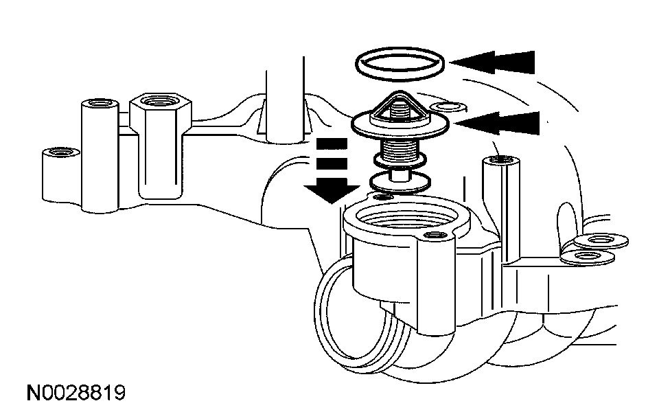

Here is what I believe is happening:
First, the idea that you need to press the throttle for it to start indicates to me that the vehicle is flooded. When you press the pedal on this vehicle, it shuts down the injectors to clear a flooded engine.
Next, the idea that you saw smoke indicates a rich fuel mixture. Was the smoke black? If it was, that supports what I said about a flooded engine.
The idea that the temp gauge isn't working is the final part. The cylinder head temp sensor is used by the computer to determine the air fuel mixture delivered to the engine. If it is stuck on cold, it could be telling the computer it's -40°F which would demand a very rich fuel mixture to run the engine. I suspect you are not in those conditions.
_______________
Here is what I suggest: The easiest thing to do is to get a live data scan tool and see what the temp sensor is indicating. The temp should be close to the ambient temp outside. If it stays cold, replace the sensor.

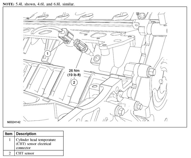

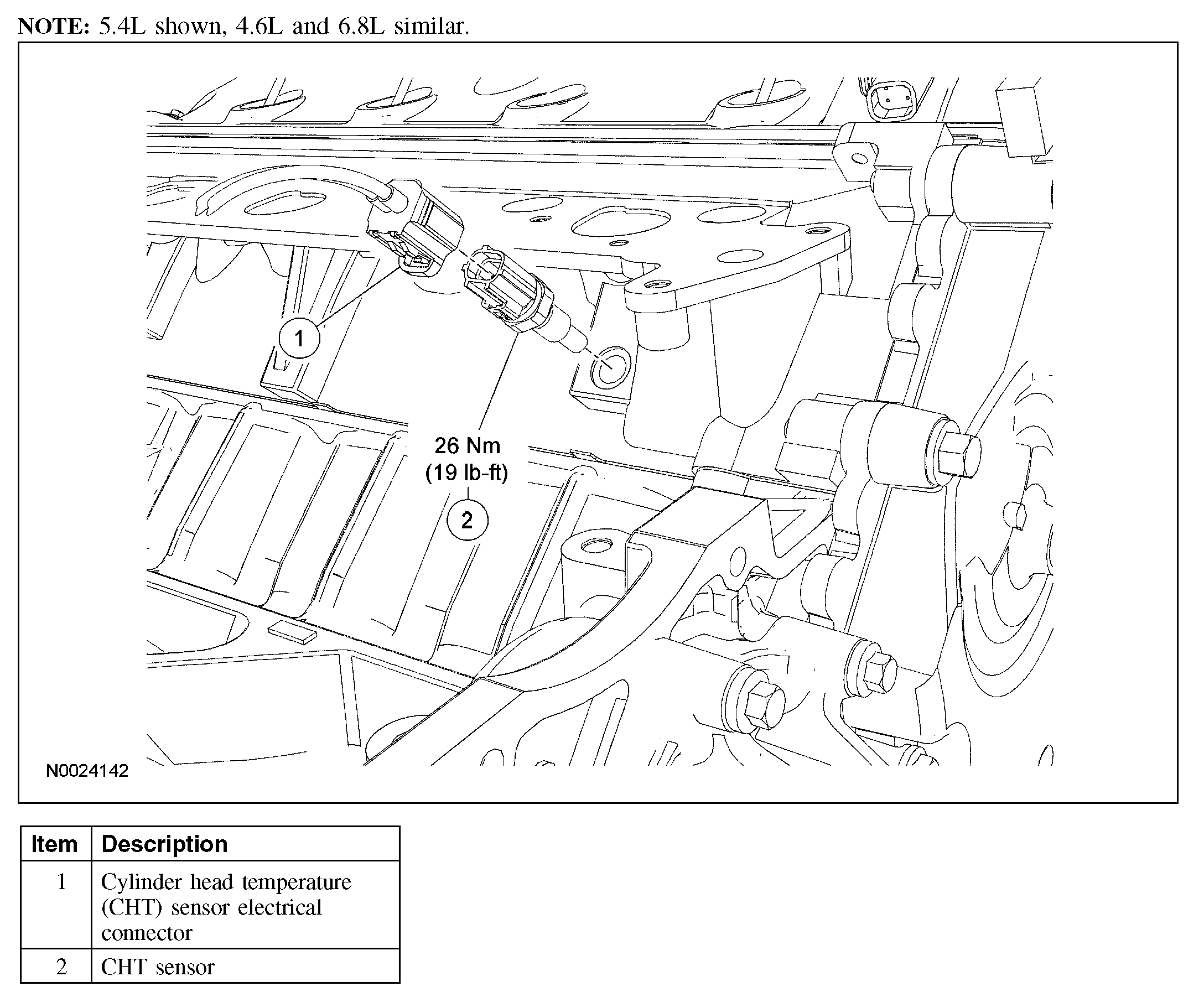

I attached a pic of it's location (pic 1). It may require the removal of the intake manifold to access. You will need to check if it is accessible on a van.

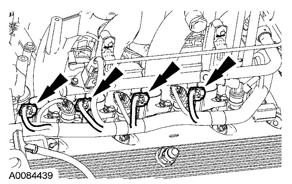

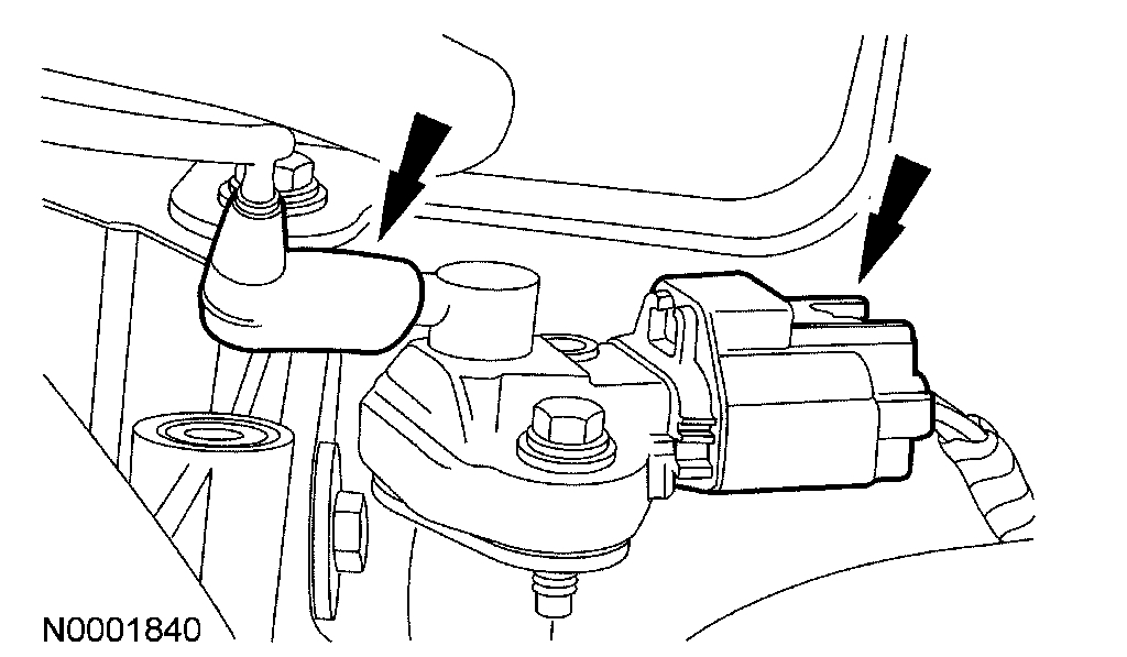

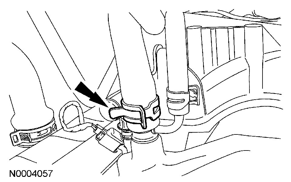

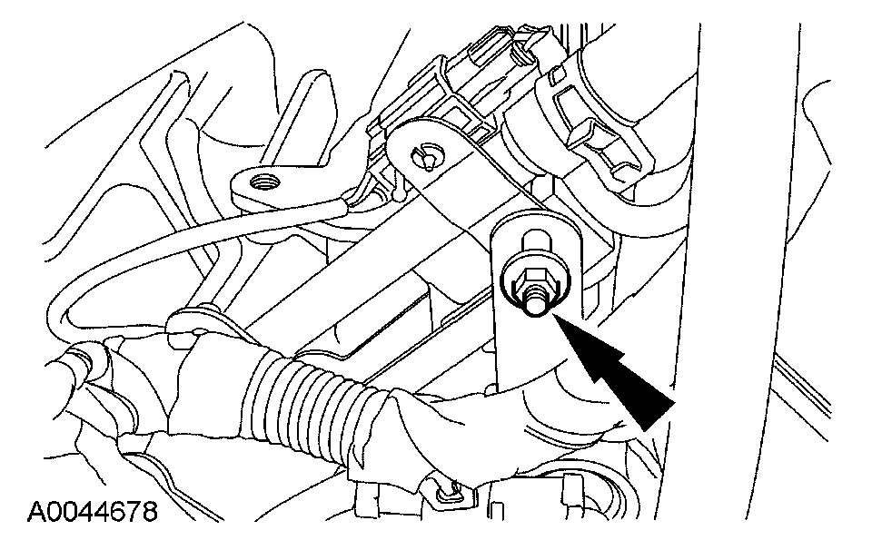

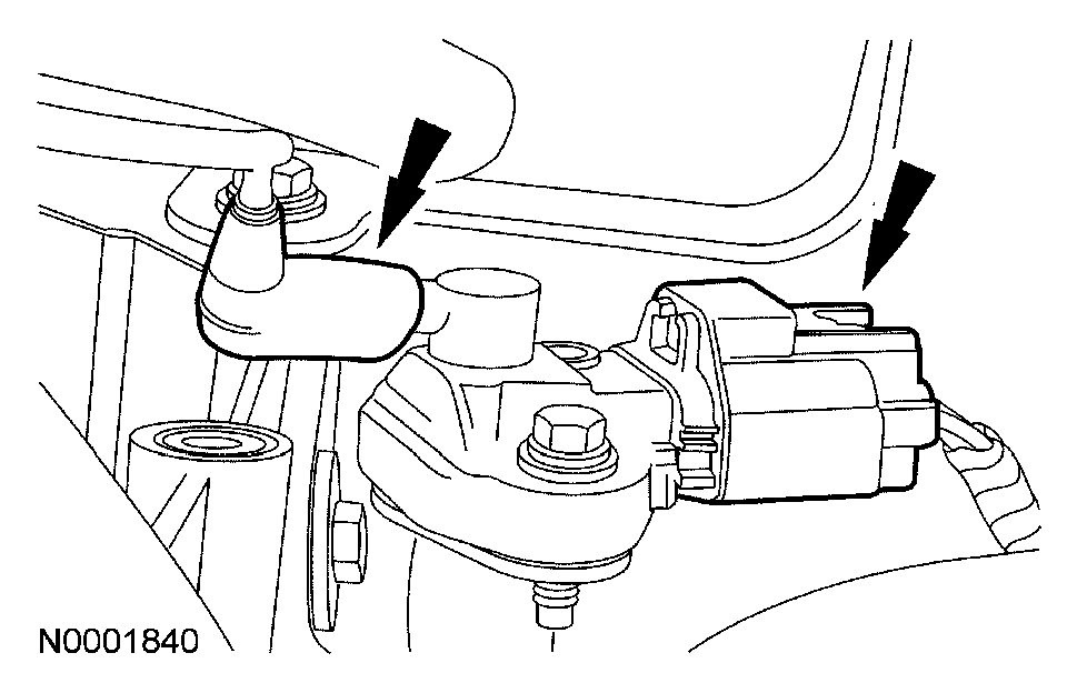

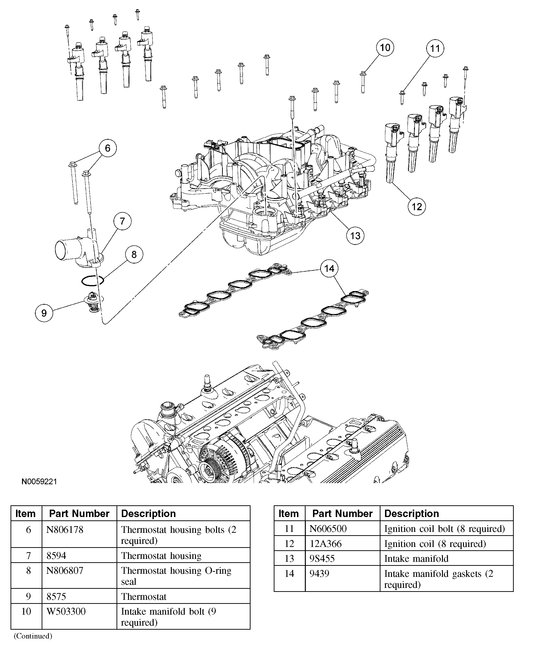

If you need to remove the intake, here are the directions. The remaining pics correlate with the directions. I don't recommend going to this much trouble unless you confirm the sensor is bad.
____________________________________________
2007 Ford Truck E 150 V8-5.4L
Removal and Installation
Vehicle Engine, Cooling and Exhaust Engine Intake Manifold Service and Repair Procedures Removal and Installation
REMOVAL AND INSTALLATION
Intake Manifold - 5.4L

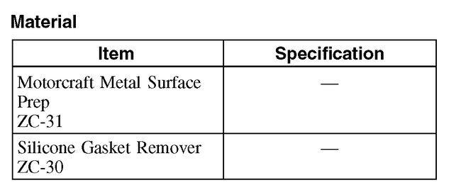

Material

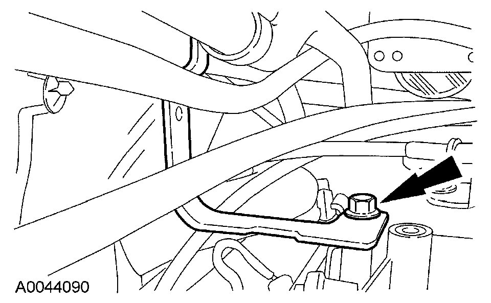

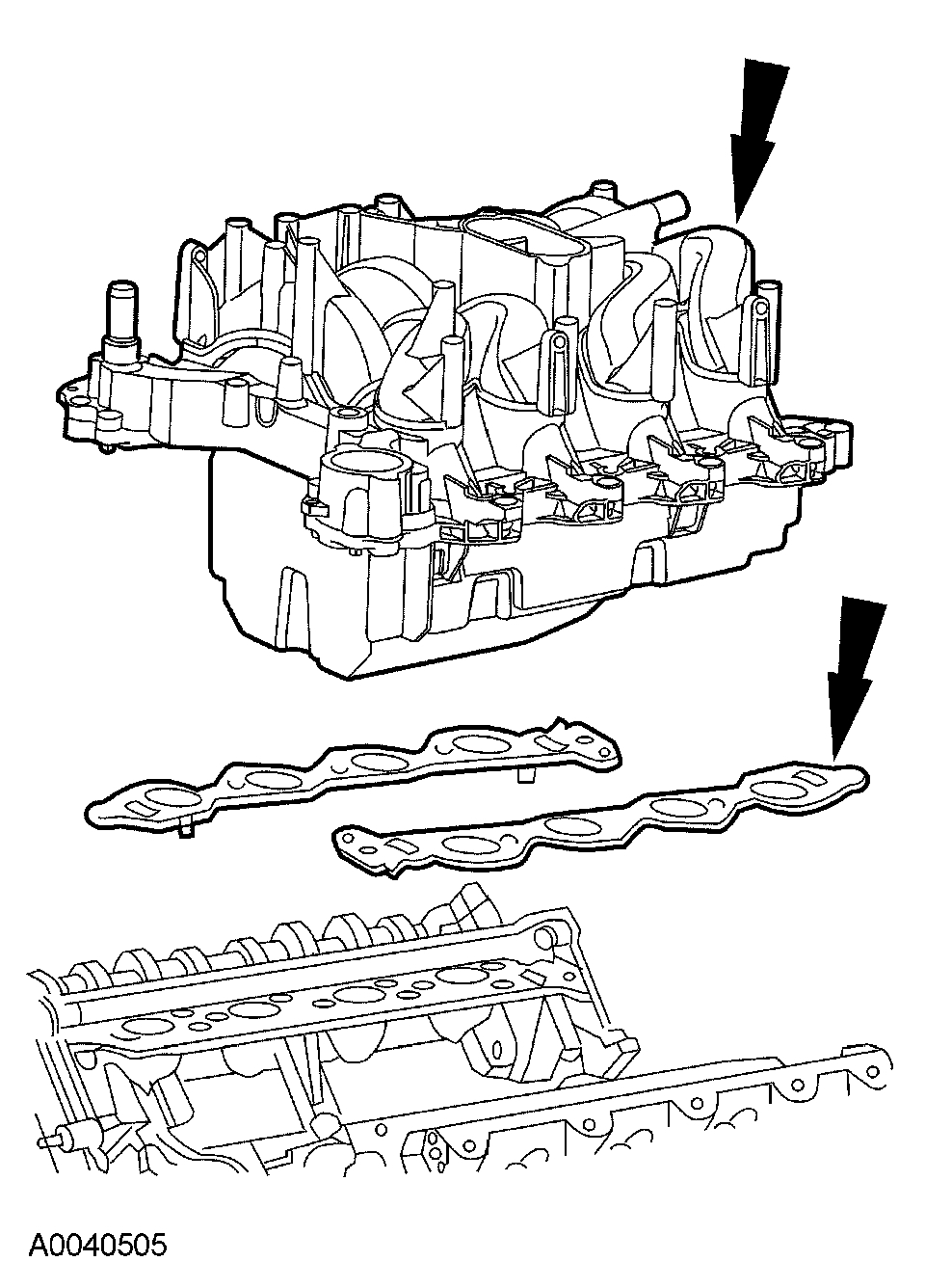

pic 2

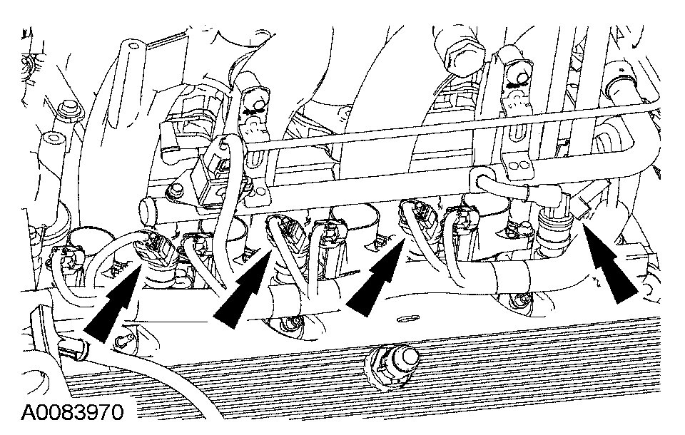

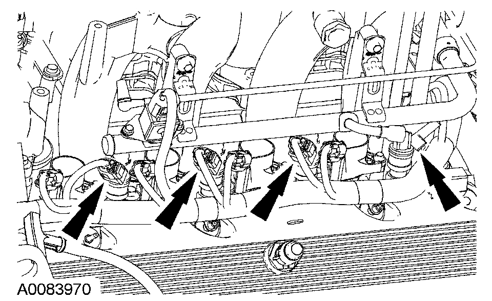

pic 3

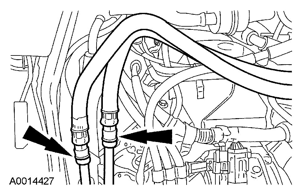

pic 4

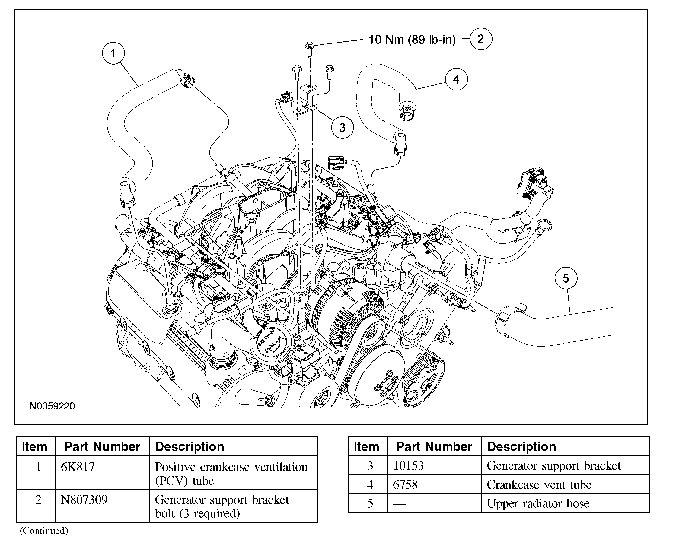

1. Remove the engine cover.
2. Disconnect the fuel supply tube spring lock coupling. For additional information, refer to Fuel Delivery and Air Induction.
3. Disconnect the battery ground cable. For additional information, refer to Battery.
4. Drain the cooling system. For additional information, refer to Cooling System.
5. Remove the throttle body (TB) spacer. For additional information, refer to Fuel Delivery and Air Induction.

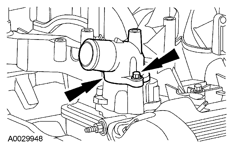

6. Compress and slide the hose clamp and disconnect the upper radiator hose.
7. Disconnect the coolant hose.

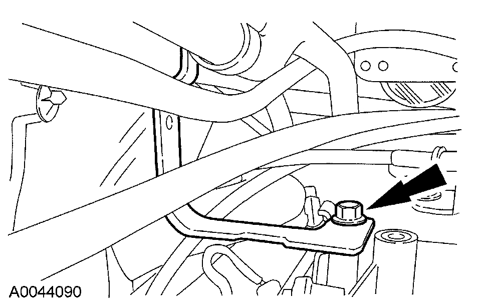

pic 5
8. Remove the 3 bolts and the generator upper support bracket.

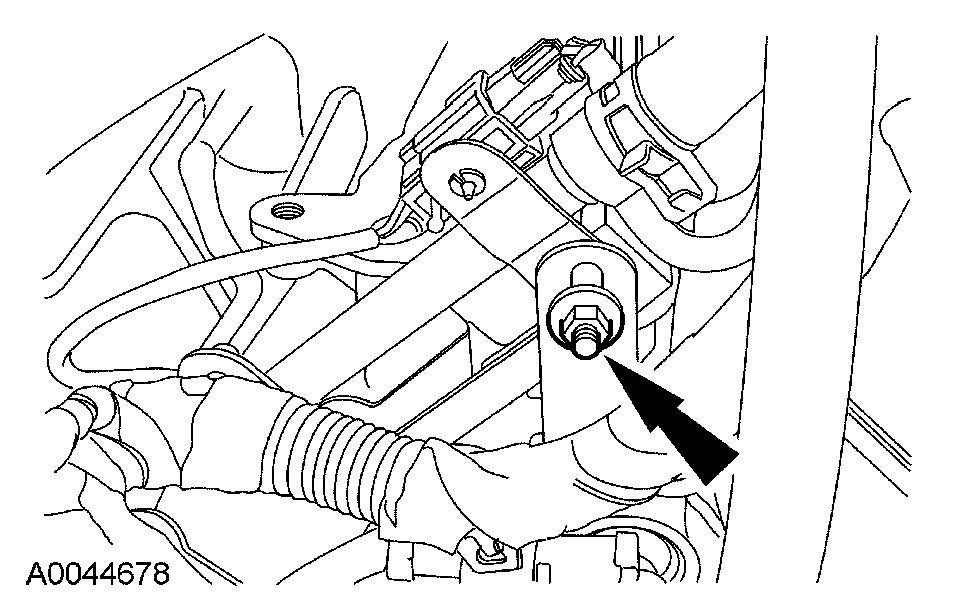

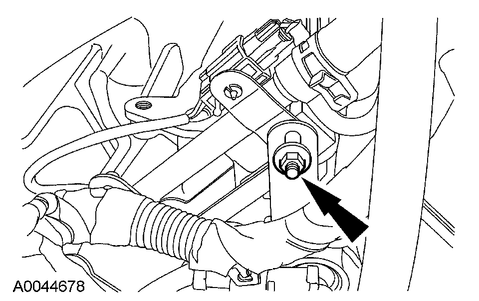

9. Remove the transmission fluid indicator and tube support bracket bolt.

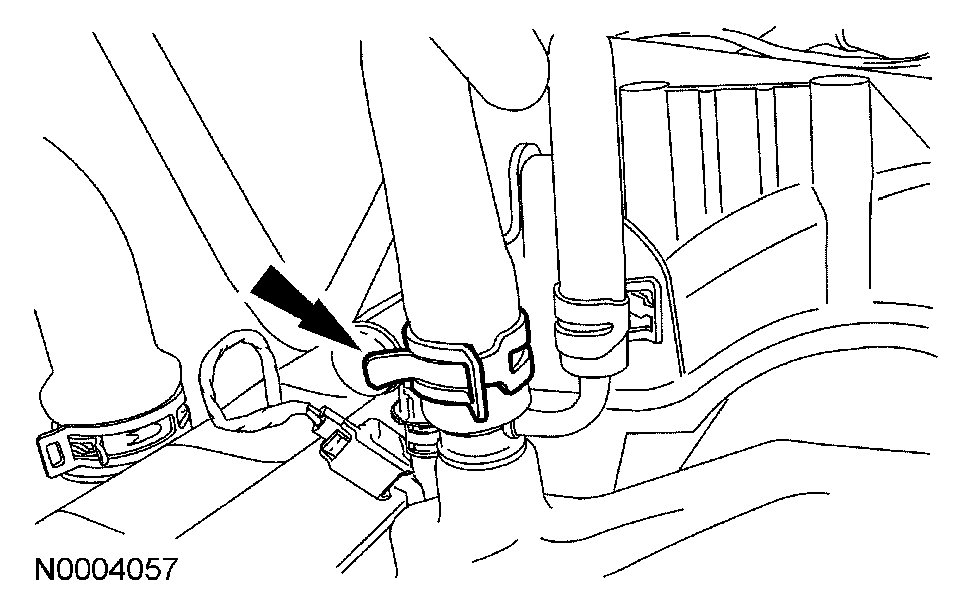

pic 6
10. Remove the nut and position the transmission fluid indicator and tube aside.
pic 7

Disconnect the 8 ignition coil electrical connectors.
pic 10

Disconnect the 8 fuel injector electrical connectors.
pic 11
17. Remove the 8 bolts and the 8 ignition coils.
18. Remove the 2 bolts, the thermostat housing and the thermostat.
^ Discard the O-ring seal.

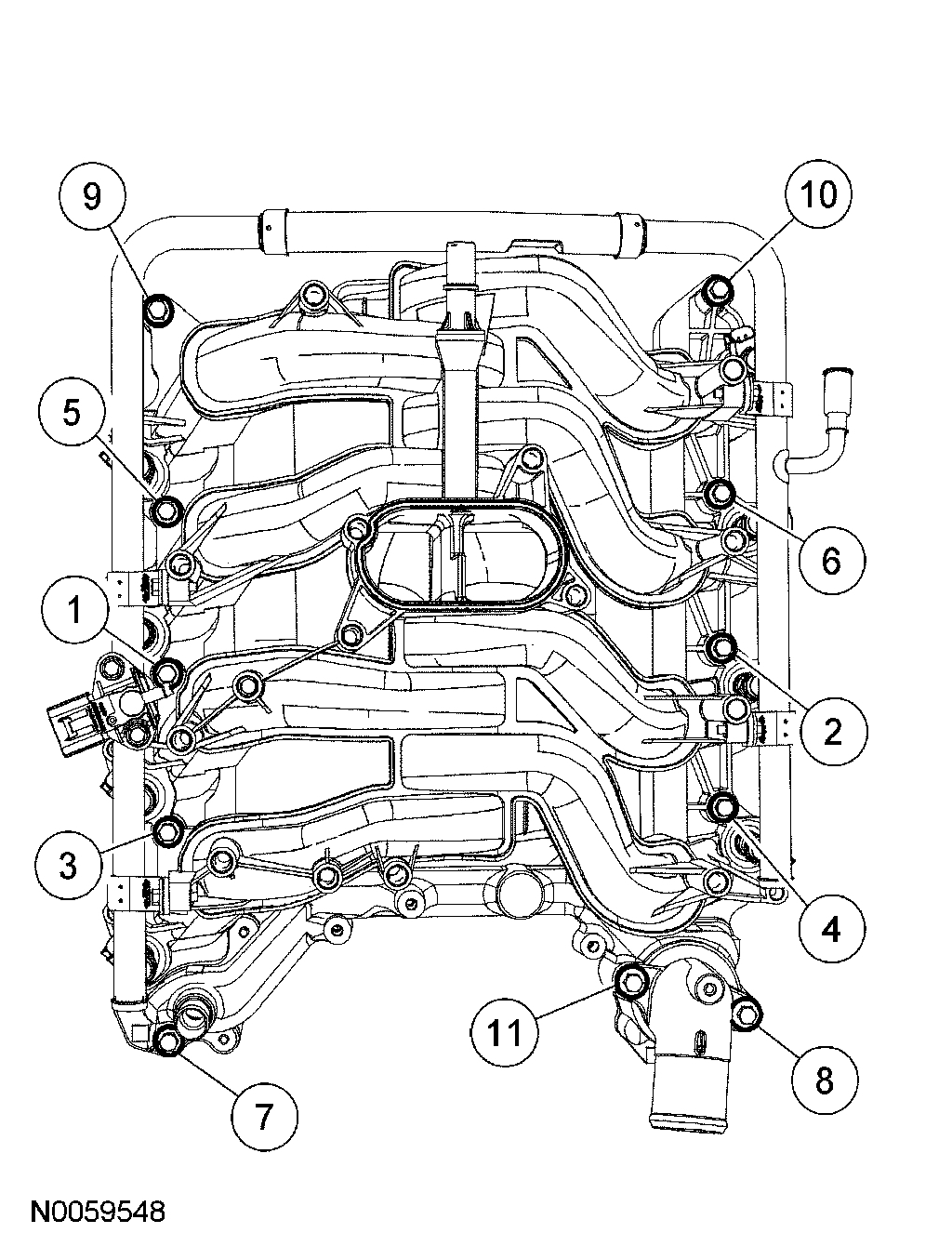

19. Remove the 9 bolts, the intake manifold assembly and discard the intake manifold gaskets.

1. CAUTION: Do not use metal scrapers, wire brushes, power abrasive discs or other abrasive means to clean the sealing surfaces. These tools cause scratches and gouges which can cause leak paths. Use a plastic scraping tool to clean sealing surfaces.
Clean and inspect the sealing surfaces with silicone gasket remover and metal surface prep. Follow the directions on the packaging.
2. Position new intake manifold gaskets, the intake manifold and loosely install the 9 bolts.

5. Tighten the 11 bolts in 2 stages in the sequence shown.
^ Stage 1: Tighten to 2 Nm (18 inch lbs).
^ Stage 2: Tighten to 25 Nm (18 ft. lbs).

Before doing this, again, confirm it is bad. If it checks good, then we should check fuel pressure next.

Quick update, code kicked the light on this morning p1289 confirm both your and my assumption of cylinder head sensor. I will attempt replacement without removing intake. I will update my efforts or struggles. An additional question is, engine coolant temperature a maintenance item I have it in my possession and have a mind to replace. Even if it's not a maintenance item would you be so kind to provide its location and procedures as well. I appreciate what you do and this site as whole it's a blessing.
Feb 13, 2021 at 9:50 AM
  • 110,194 POSTS
It doesn't have a traditional ECT. The cylinder head temp sensor is what needs replaced. As far as a traditional, if it does have one, it may be on the radiator itself, but I think it has just the CHT. Maybe that is what you have.
