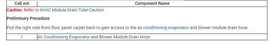

Once a press the gas I hear a sloshing sound in the dash board of the car. Almost like water coming into my lap.
Oct 25, 2019 at 10:01 PM
Good morning,

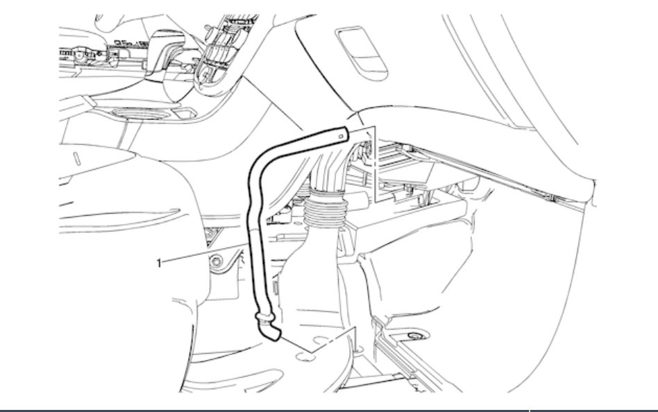

When you have the AC system running, does the water exit to the ground? It may be a clogged drain for the evaporator system causing the water to back up in the case.
I attached a picture and procedure for you to follow for the drain line.
