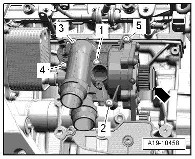

can you get me the spec on the 5 bolts on the water pump bolts?

All 5 bolts are torque to 9nm. please click the diagram below.

Side note, keep in mind If you take off the belt pulley that bolt is reverse threaded. So to loosen is clockwise as to not break the belt. the belt pulley bolt torque is 10 nm plus 1/4 turn or 90°, but if you loosen it then it recommends replacing it with a new one.

Thanks. Ya i remember the bolt being reverse thread. thanks
