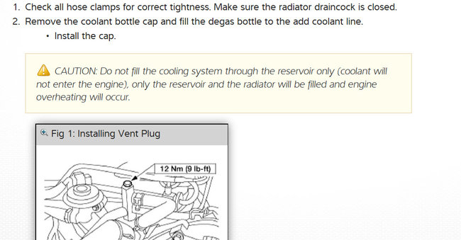

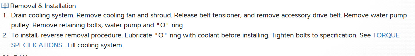

The water pump seal is bad so I would like complete instructions (with pictures) how to change the water pump and how to refill the cooling system properly so there is no air captued. Thank you.

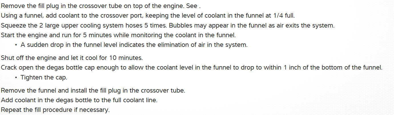

Thanks for the reply. It is a Mustang Cobra SVT 4.6 4valve motor. Would appreciate instructions with pictures if possible to change the water pump and refill with coolant properly. I've been told the cooling system must be bled to get rid of air trapped in the system. A link to a manual could be very helpful. Thanks again. Notapromike

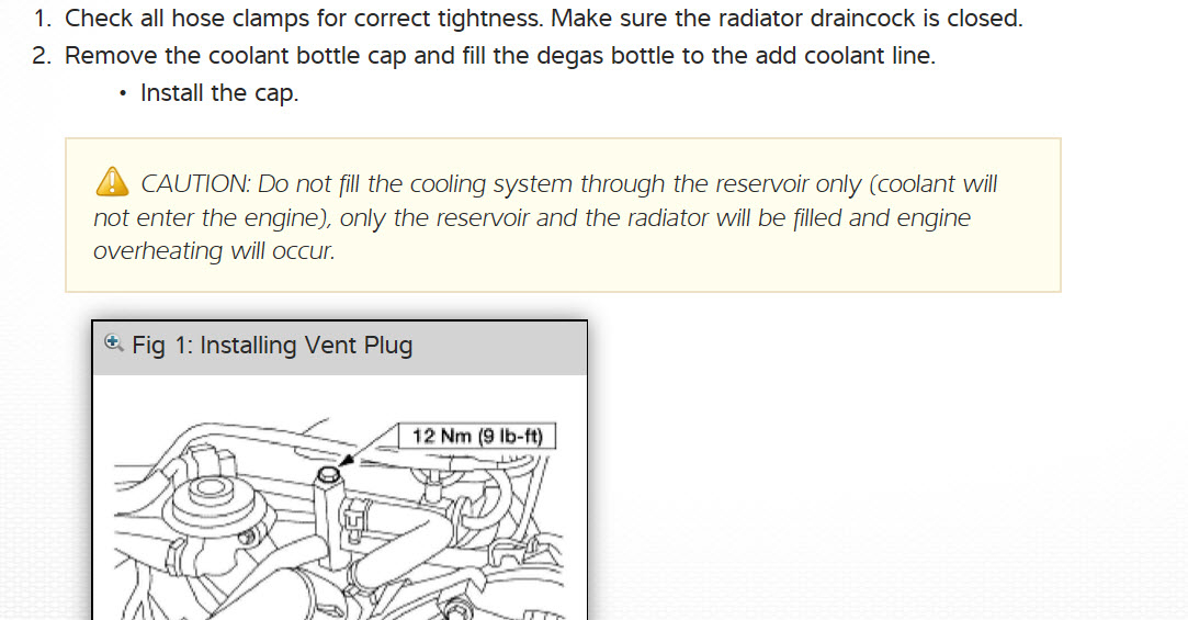

we have no pics on the water pump but it's pretty straight up. see pics fro removal and bleeding
