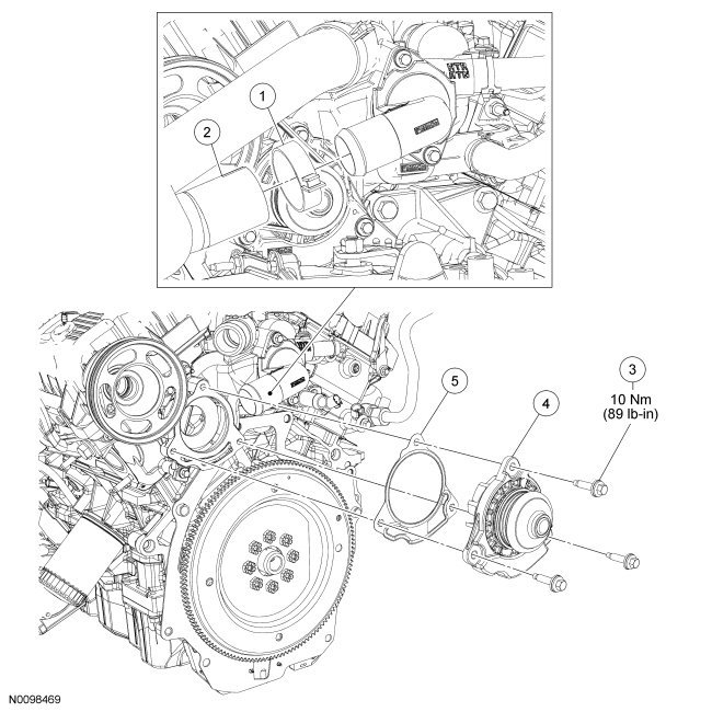

My water pump is shot, so my antifreeze is just kind of being sprayed out of the pump rather than circulating. I need to replace the pump and possibly the thermostat as well but I'm not the most familiar with cars. I will have another somewhat familiar helper and another who works on cars regularly, but if anyone has advice or a step-by-step breakdown on how to fix the issue it would be greatly appreciated.

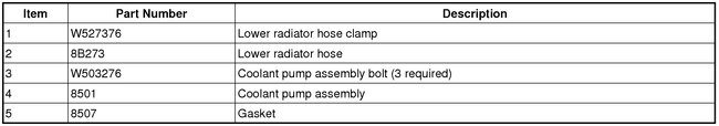

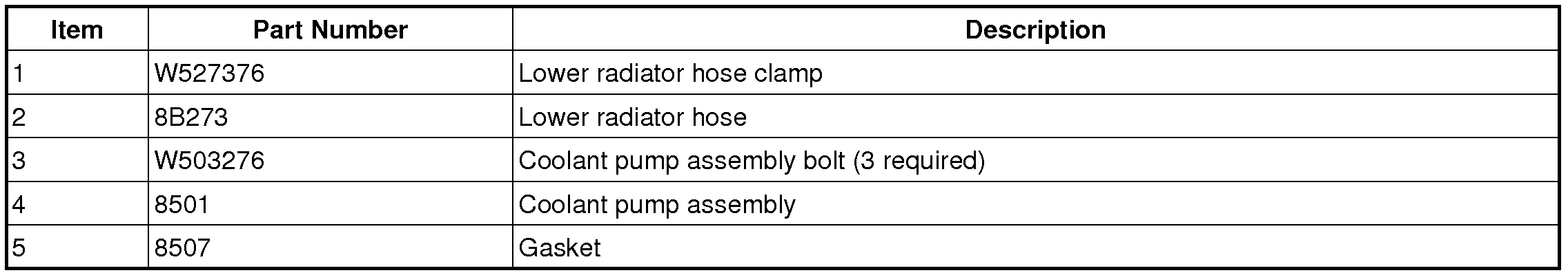

1. Drain the cooling system. For additional information, refer to Cooling System Draining, Filling and Bleeding See: Cooling System > Procedures > Cooling System Draining, Filling and Bleeding.
2. Remove the Air Cleaner (ACL) outlet pipe. For additional information, refer to Section 303-12B See: Fuel Delivery and Air Induction > Components > Fuel System.
3. Disconnect the lower radiator hose from the thermostat housing.
4. Remove the coolant pump belt. For additional information, refer to Section 303-05B .
5. Remove the 3 bolts and the coolant pump.
- Remove and discard the gasket.
- To install, tighten to 10 Nm (89 lb-in).
6. To install, reverse the removal procedure.
- Install a new gasket.
7. Fill and bleed the cooling system. For additional information, refer to Cooling System Draining, Filling and Bleeding See: Cooling System > Procedures > Cooling System Draining, Filling and Bleeding.
