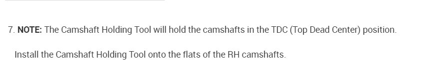

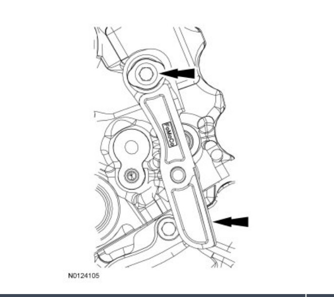

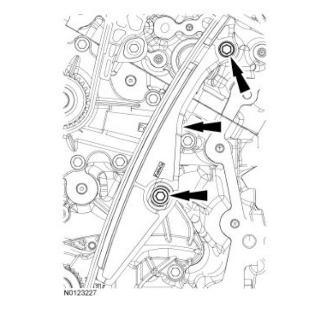

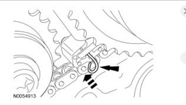

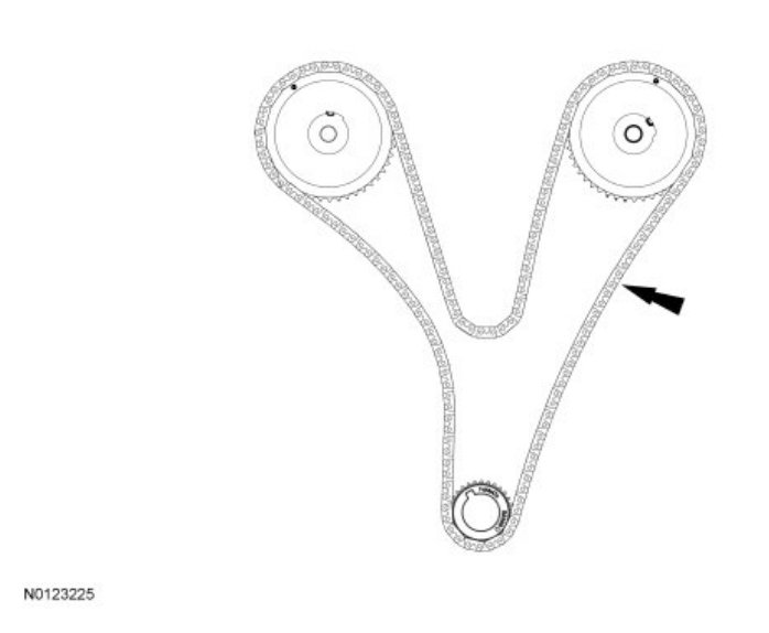

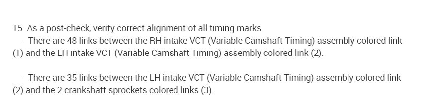

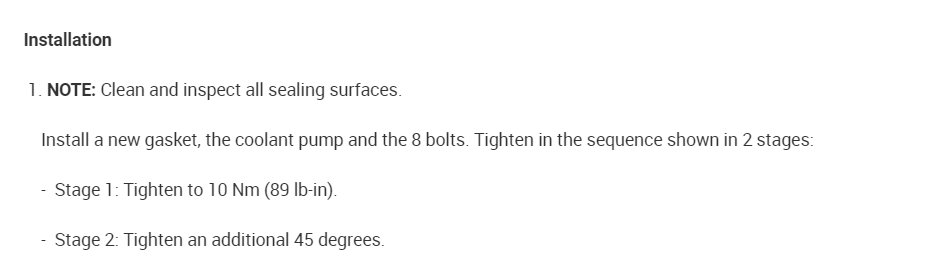

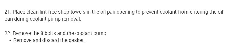

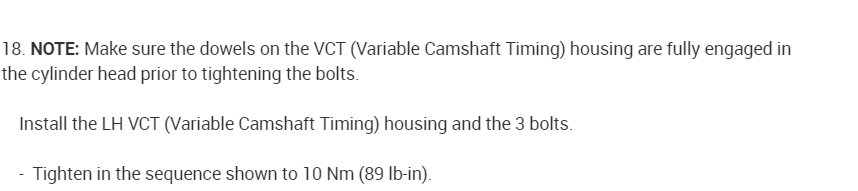

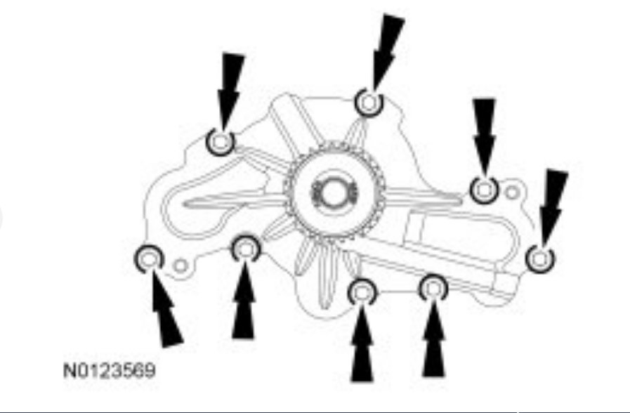

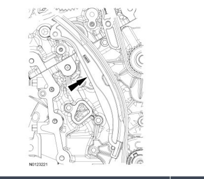

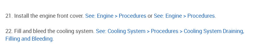

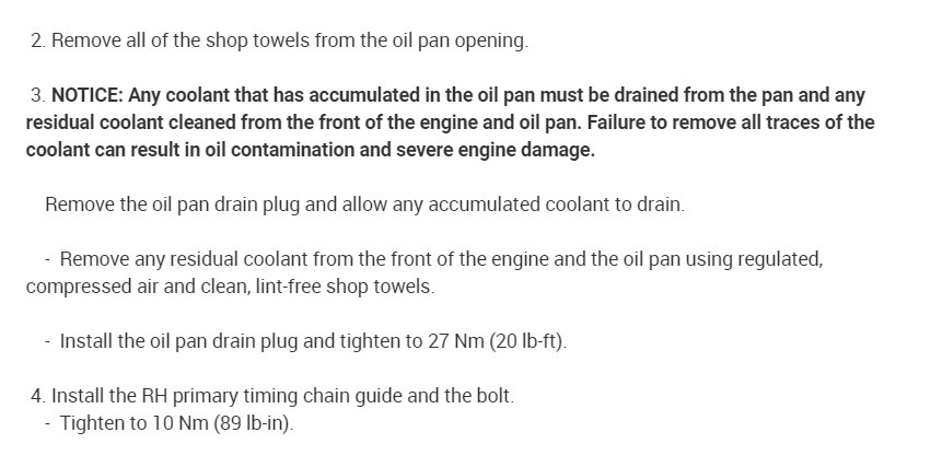

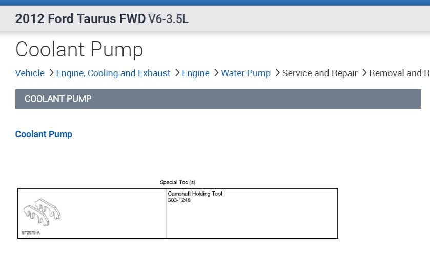

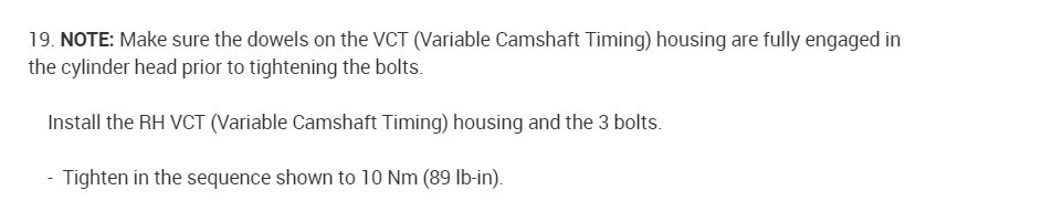

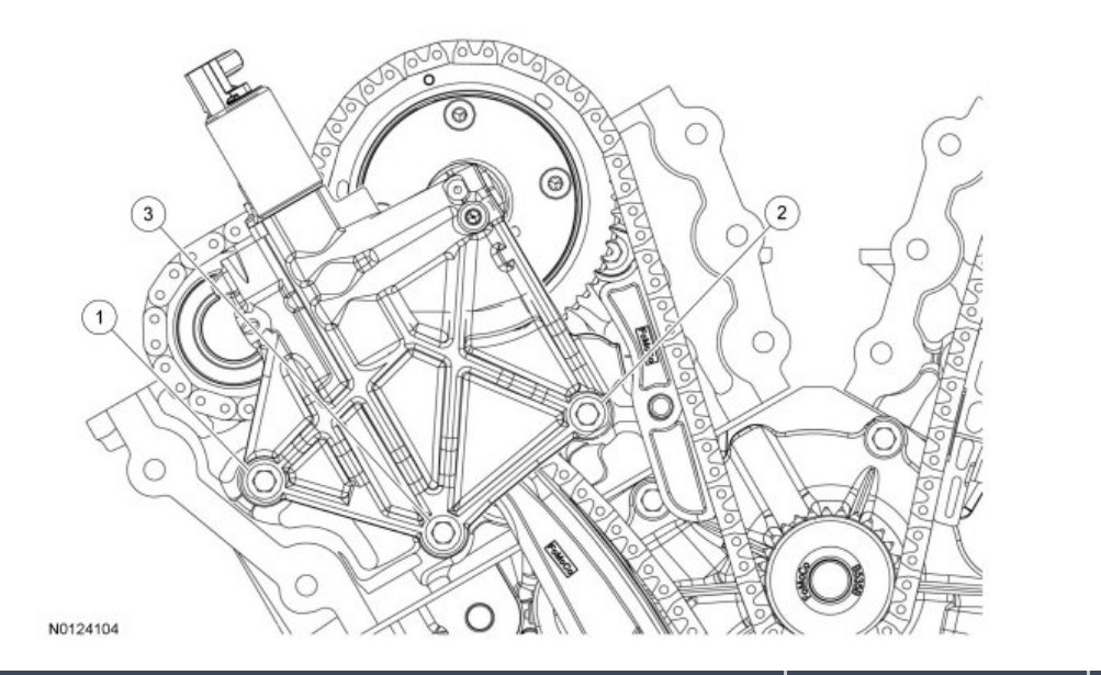

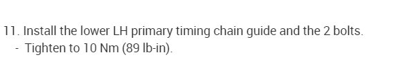

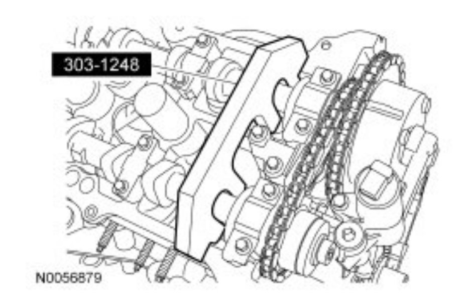

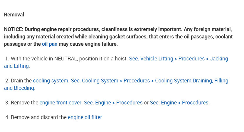

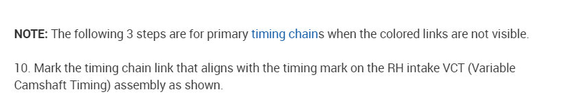

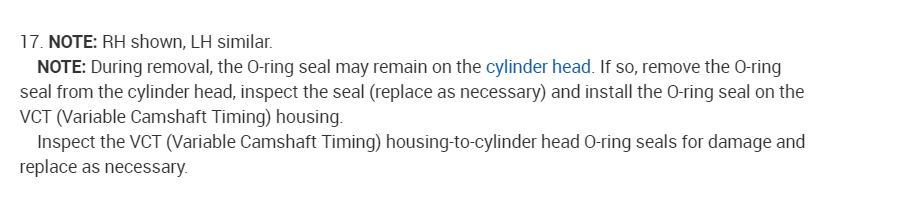

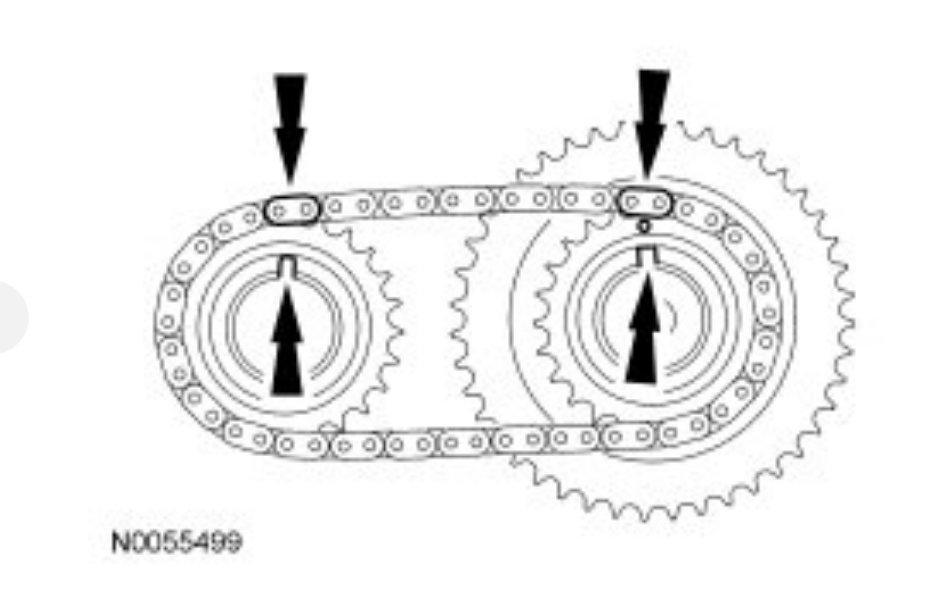

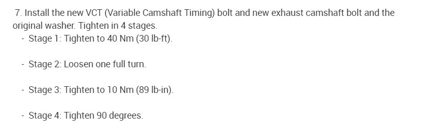

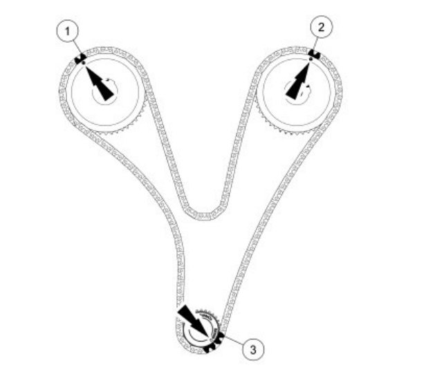

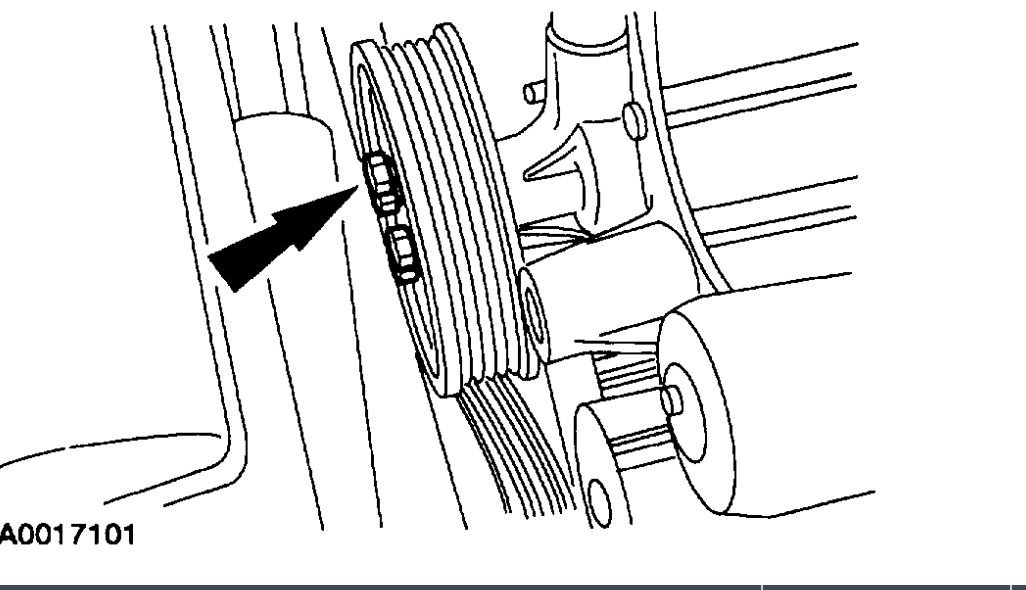

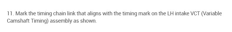

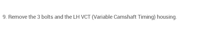

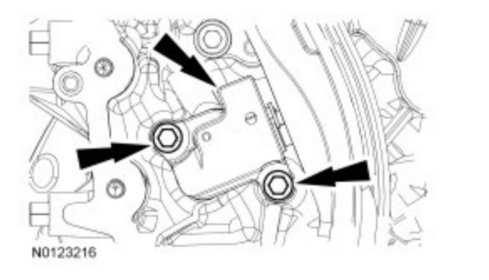

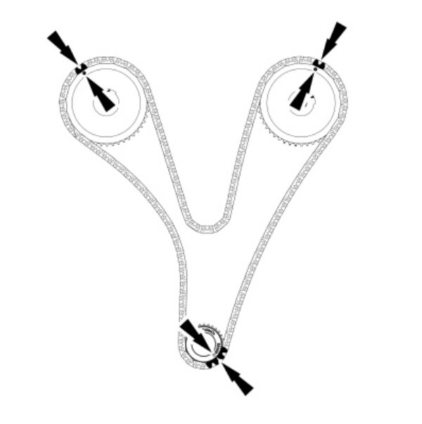

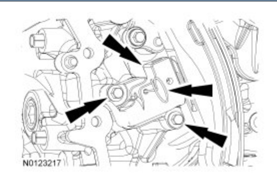

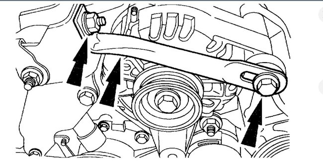

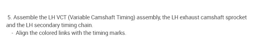

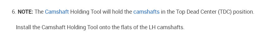

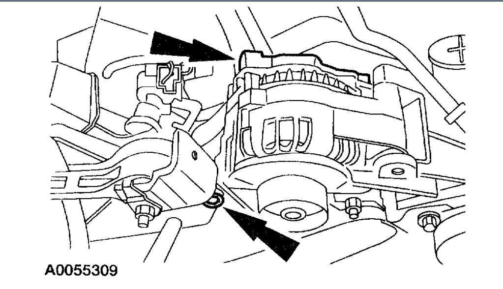

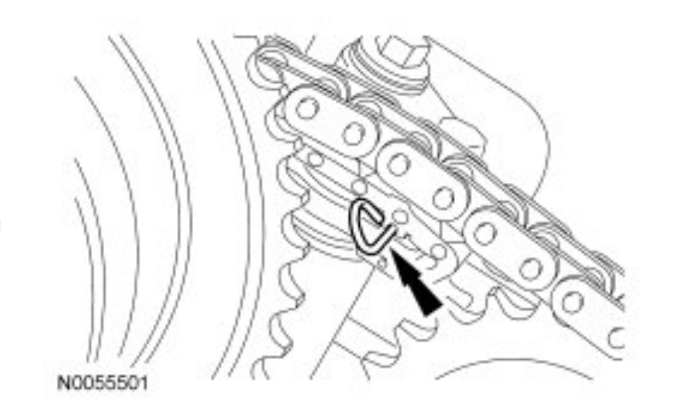

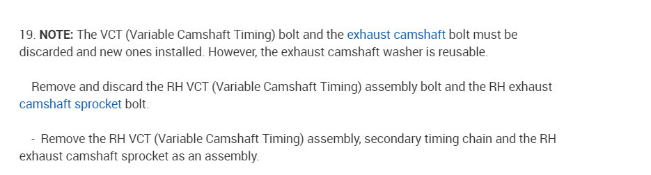

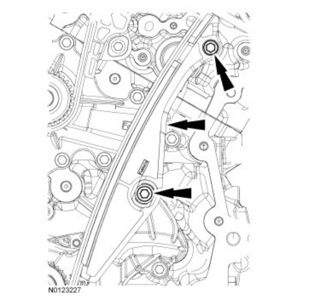

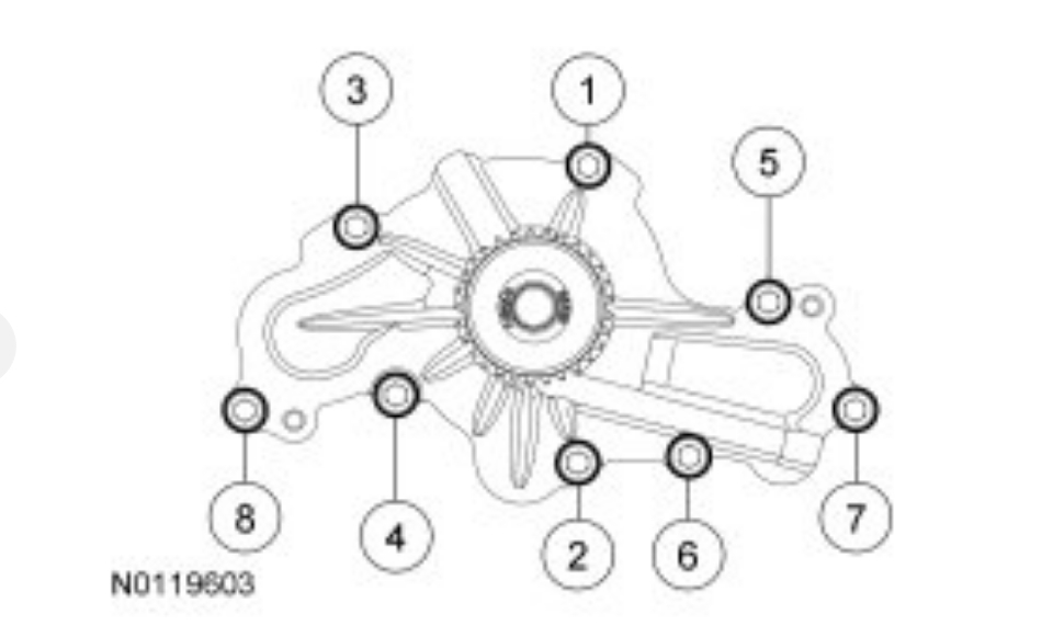

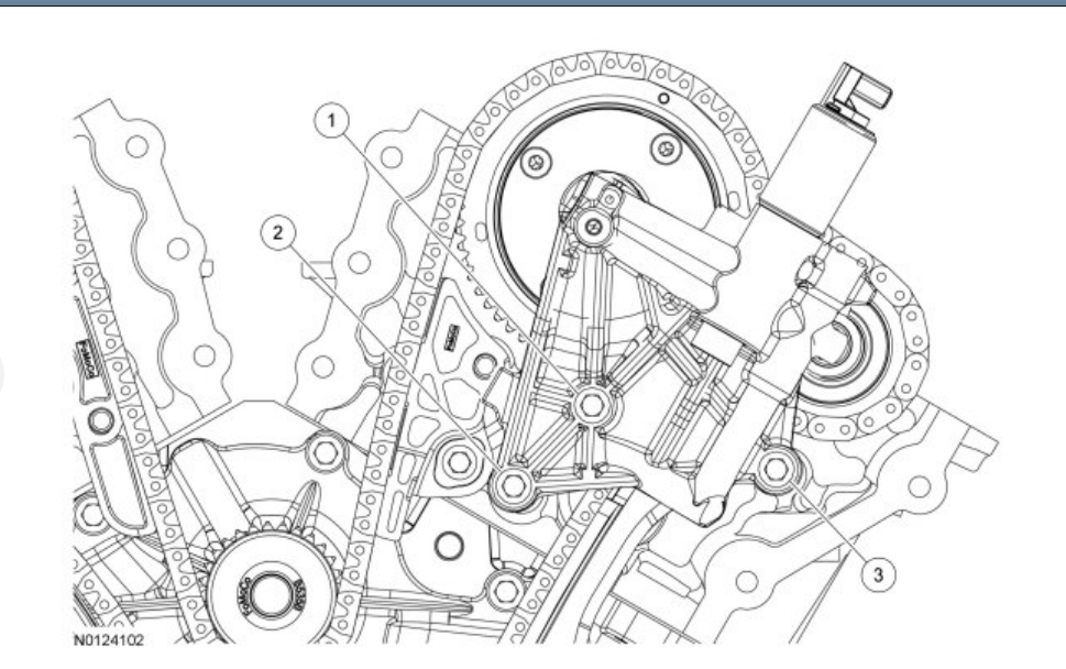

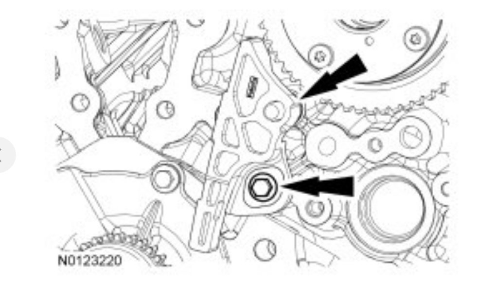

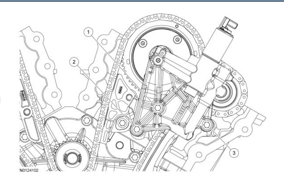

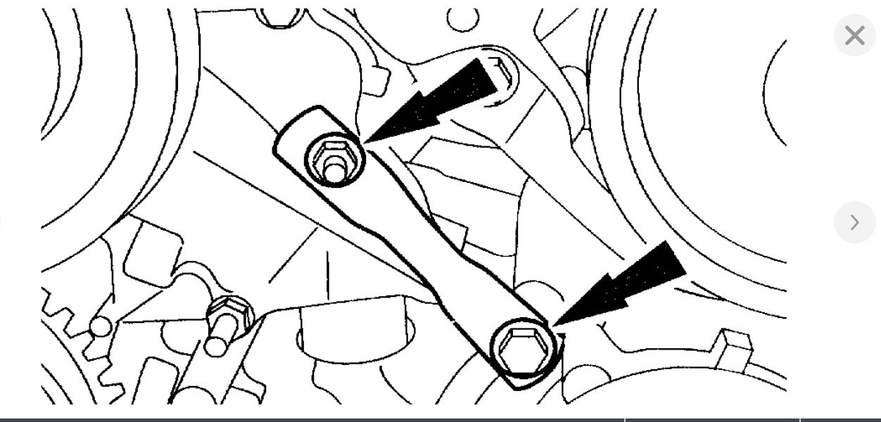

I need to replace the water pump. I am trying to come up with a list of all the parts i need to replace during the process. I also am confused does the motor have to be pulled or can i get away with just loosening the motor mount jacking the motor up so i can gain access to the water pump?
May 26, 2019 at 10:02 PM
SCGRANTURISMO
  • 4,897 POSTS

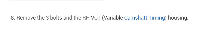

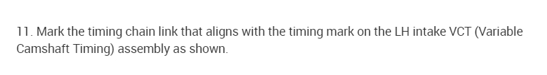

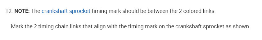

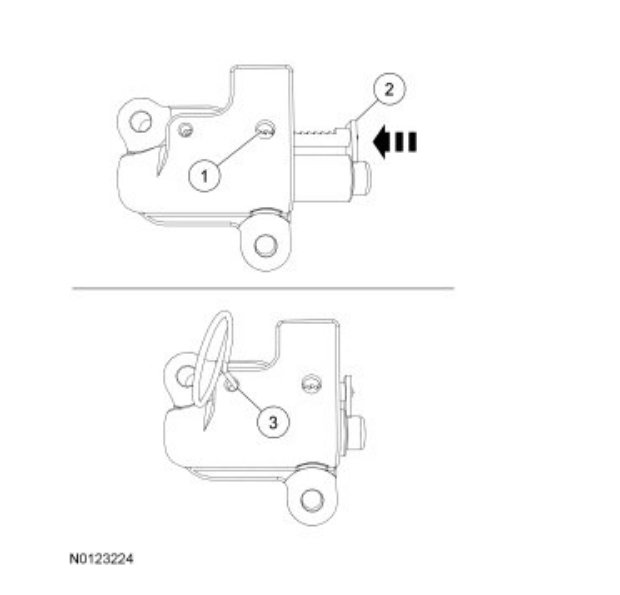

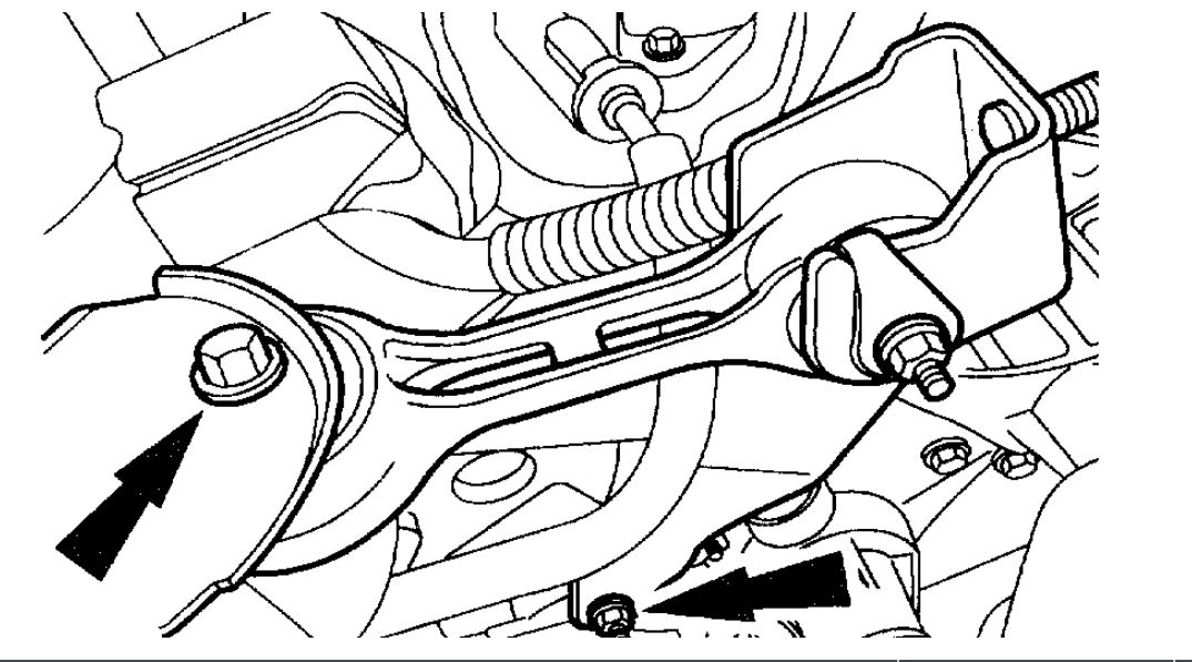

I have included in the diagrams down below the first part of the directions for the removal and installation of your vehicle's water pump. The directions are quite extensive, so I am sending along the first 50 diagrams below. I will sent the remainder in the next reply that I send to you.
Thanks,
Alex
2CarPros
May 27, 2019 at 1:00 AM
SCGRANTURISMO
  • 4,897 POSTS

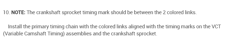

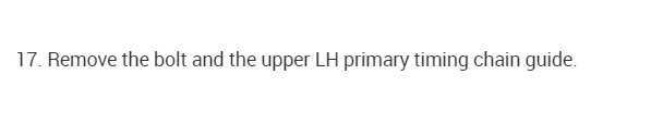

Hello again,
Here is the rest of the instructions for the removal and installation of your vehicle's water pump. They are in the diagrams down below. Please go through them and get back to us with how everything turns out.
Thanks,
Alex
2CarPros

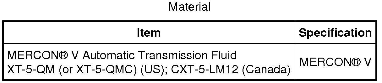

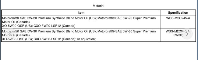

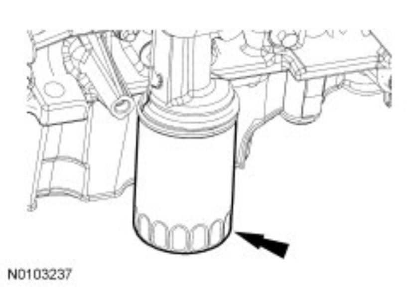

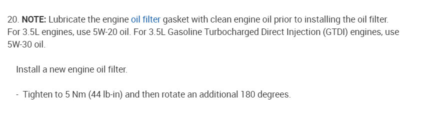

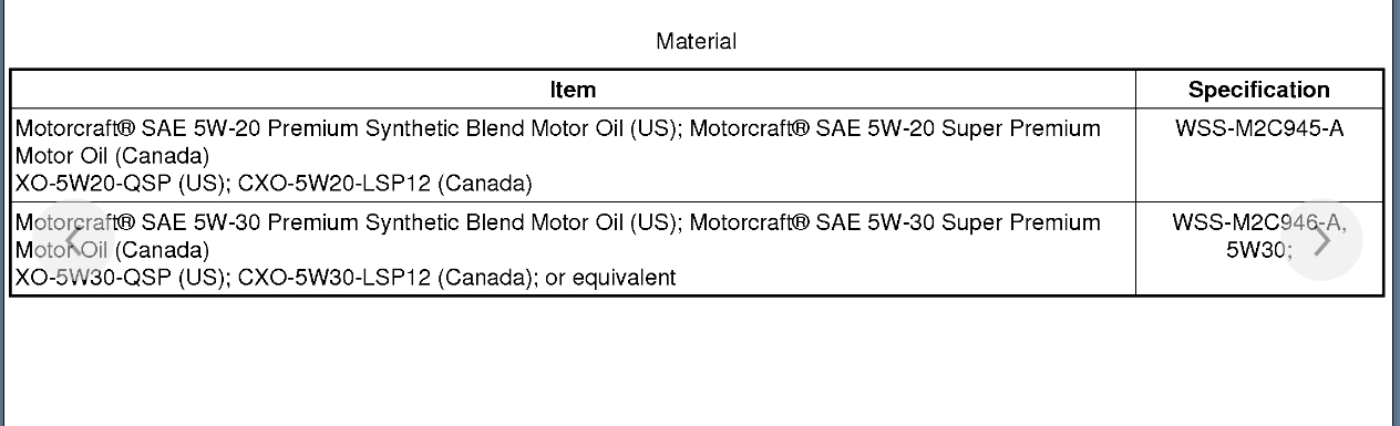

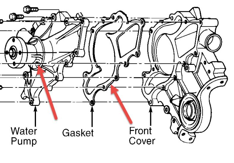

What other fliuds and other items should be changed out while it's disassembled?
Jun 13, 2019 at 8:33 AM
SCGRANTURISMO
  • 4,897 POSTS
Hello again,
I would recommend replacing the gasket, and then doing a flush and fill. As always, make sure you use the proper antifreeze in the cooling system to keep electrosis from happening. I have included in the diagrams down below the specs for your vehicle's cooling system.

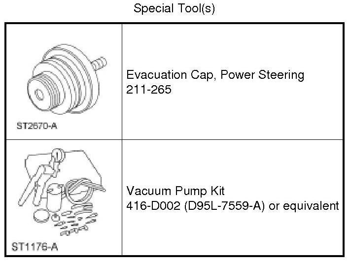

Replaced my water pump and timing components (all chains, guides and tensioners). Got everything back together and the car started right up and drives with zero performance issues. However, there is a whining noise on acceleration or just revving the engine in park. New belts were installed and a new power steering pump since I dented the pulley and further damaged the pump trying to replace the pulley. Everything was torqued to specs and cam tools were used to ensure timing was correct. Did all of the work myself since I can't afford a mechanic and I'm afraid I will have to tear the whole thing apart again. Is there something I should check before assuming I did something wrong inside the motor?

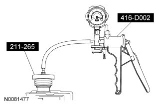

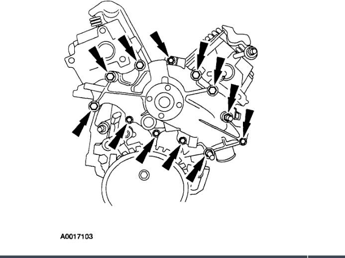

Does the noise sound like it could be the power steering pump? Did you bleed the new pump? Take a look through these directions for purging the power steering pump. I would suggest trying this. Most likely this is where the noise is coming from. I will also tell you that from experience, aftermarket or re-manufactured pumps commonly make noise.
__________________________________________
The attached pictures correlate with these directions.

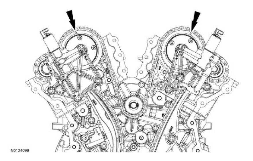

Power Steering System Purging
Vehicle Steering and Suspension Steering Power Steering Power Steering Bleeding Service and Repair Procedures Power Steering System Purging
POWER STEERING SYSTEM PURGING

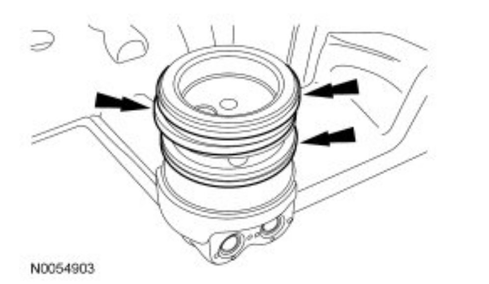

picture 1
picture 2
NOTICE: If the air is not purged from the power steering system correctly, premature power steering pump failure may result. The condition may occur on pre-delivery vehicles with evidence of aerated fluid or on vehicles that have had steering component repairs.
1. NOTE: A whine heard from the power steering pump can be caused by air in the system. The power steering purge procedure must be carried out prior to any component repair for which power steering noise complaints are accompanied by evidence of aerated fluid.
Remove the power steering reservoir cap. Check the fluid.
2. Raise the front wheels off the floor. Refer to the appropriate information for the procedure.

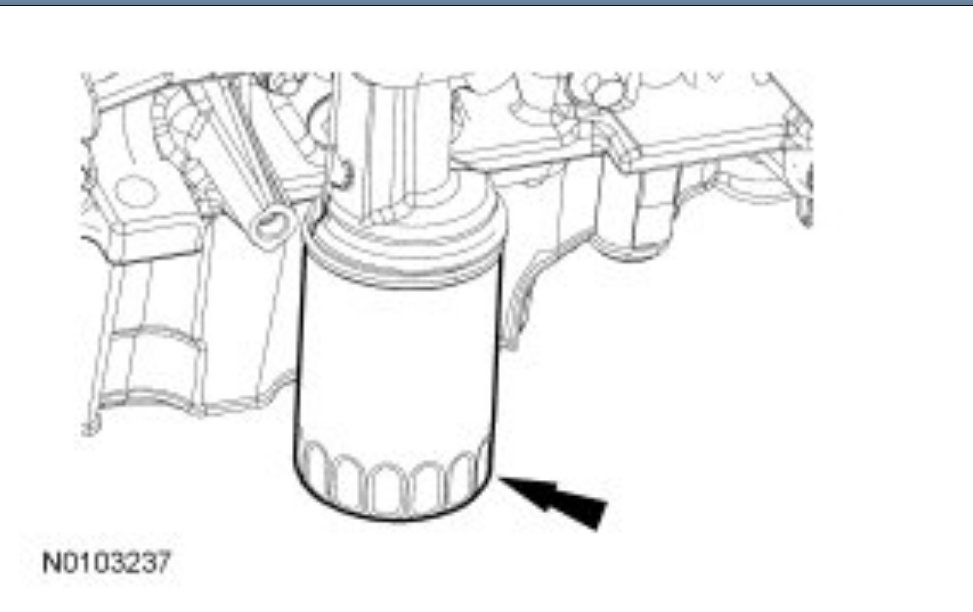

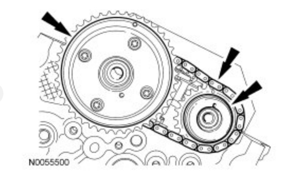

3. Tightly insert the Power Steering Evacuation Cap into the reservoir and connect the Vacuum Pump Kit.
picture 3
4. Start the engine.
5. Using the Vacuum Pump Kit, apply vacuum and maintain the maximum vacuum of 68-85 kPa (20-25 in-Hg).
- If the Vacuum Pump Kit does not maintain vacuum, check the power steering system for leaks before proceeding. For additional information, refer to Power Steering Fluid Leak Test. See: Steering > Component Tests and General Diagnostics > Component Tests
6. If equipped with Hydro-Boost(R), apply the brake pedal 4 times.
7. NOTICE: Do not hold the steering wheel against the stops for an extended amount of time. Damage to the power steering pump may occur.
Cycle the steering wheel fully from stop-to-stop 10 times.
8. Stop the engine.
9. Release the vacuum and remove the Vacuum Pump Kit and the Power Steering Evacuation Cap.
10. NOTE: Do not overfill the reservoir.
Fill the reservoir as needed with the specified fluid.
11. Start the engine.

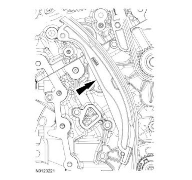

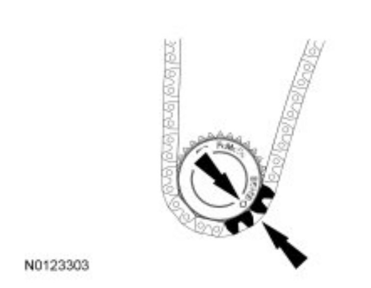

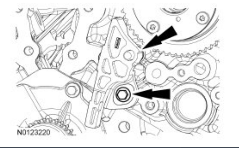

12. Install the Power Steering Evacuation Cap and the Vacuum Pump Kit. Apply and maintain the maximum vacuum of 68-85 kPa (20-25 in-Hg).
picture 4
13. NOTICE: Do not hold the steering wheel against the stops for an extended amount of time. Damage to the power steering pump may occur.
14. Stop the engine, release the vacuum and remove the Vacuum Pump Kit and the Power Steering Evacuation Cap.
15. NOTE: Do not overfill the reservoir.
Fill the reservoir as needed with the specified fluid and install the reservoir cap.
16. Visually inspect the power steering system for leaks.

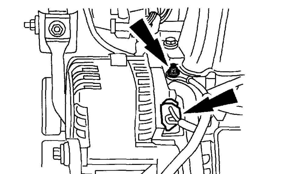

Good afternoon,
https://www.2carpros.com/articles/water-pump-replacement
Below is the procedure and some pictures
Water Pump-3.0L (2V)
Removal
1. Drain the engine cooling system.

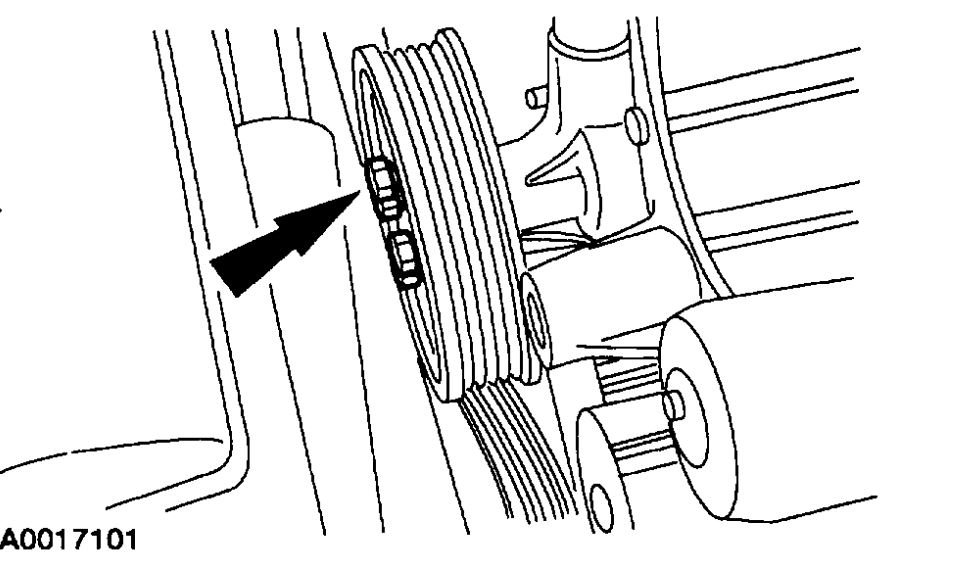

2. Loosen the water pump pulley.
3. Remove the accessory drive belt.
4. Remove the degas bottle.
5. Disconnect the battery ground cable.
6. Disconnect the generator B+ cable and the voltage regulator electrical connector.
7. Remove the nut, the bolt and the generator brace.
8. Remove the generator mounting bolt and the generator.
9. Remove the bolt and the nut, and position the roll restrictor bracket out of the way.
10. Remove the bolt and the accessory drive belt tensioner.
11. Remove the nut, the bolt and the support bracket.
12. Remove the bolts and the water pump pulley.
13. Disconnect the water pump inlet hose and the crankshaft position sensor electrical connector.
14. Remove the bolts and the water pump, and clean the sealing surfaces.
Feb 15, 2021 at 6:42 AM (Merged)

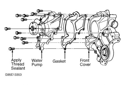

i need a manual for repair on my 2001 ford taurus waterpump

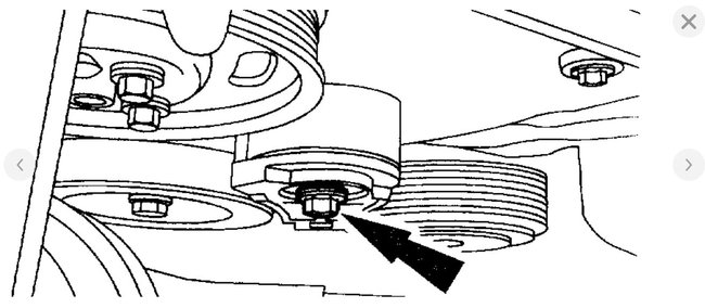

BMRFIXIT
  • 19,053 POSTS
WATER PUMP Removal Disconnect negative battery cable. Drain cooling system. Loosen water pump pulley bolts. Remove accessory drive belts. Remove automatic tensioner. Disconnect coolant hoses from water pump. Remove retaining bolts, water pump and gasket. . Installation To install, reverse removal procedure. Lightly oil all bolt and stud threads, except bolt requiring Thread Sealant (D8AZ-19554-A), before installing. Apply Contact Adhesive (D7AZ-19B508-AA) on gasket and install on water pump. Tighten bolts/nuts to specification. Refill cooling system. Check for leaks when finished.

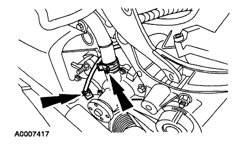

BMRFIXIT
  • 19,053 POSTS
3.0L V6 - VIN U & 2 -2001 Ford Taurus WATER PUMP Removal 1.Disconnect negative battery cable. Drain cooling system. Loosen water pump pulley bolts. Remove accessory drive belts. 2.Remove automatic tensioner. Disconnect coolant hoses from water pump. Remove retaining bolts, water pump and gasket. See Fig. Installation 1.To install, reverse removal procedure. Lightly oil all bolt and stud threads, except bolt requiring Thread Sealant (D8AZ-19554-A), before installing. \ Apply Contact Adhesive on gasket and install on water pump. 2.Tighten bolts/nuts to specification. Refill cooling system. Check for leaks when finished. 3.0L V6 - VIN S & 1 -2001 Ford Taurus WATER PUMP Removal Disconnect negative battery cable. Drain cooling system. Release drive belt tensioner. Remove drive belt. Remove radiator hose and heater hose from water pump. Remove A/C compressor-to-water pump brace (if equipped). Remove water pump bolts and remove water pump. Installation Clean gasket mating surfaces. Tighten water pump bolts to specification. To complete installation, reverse removal procedure. Tighten bolts to specification. Fill cooling system. Start engine and check for leaks.

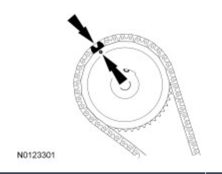

HMAC300
  • 48,601 POSTS
it cold be the seal which is inside the pump or the gasket where pump mates to engine timing chain arrows point to gasket and hole where water can leak with a bad seal
