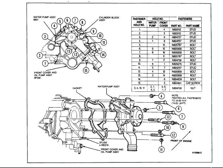

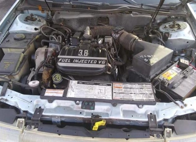

I bought the car listed above GS model last month. The lady I bought it from said I would have to replace the water pump. How do I do that?

Good afternoon,
I attached the procedure below with a couple of pictures.
https://www.2carpros.com/articles/water-pump-replacement

10. Remove water pump retaining bolts and pump. Discard old gasket.

1. Clean gasket surfaces on water pump and front cover.
2. Position a new gasket on water pump sealing surface.
Gasket and Trim Adhesive D7AZ- 1 9B508-B (ESR-M lip 1 7-A and ESE-M2G52-A) or equivalent is recommended to hold the gasket in position.
NOTE:
The threads of the No.1 front cover retaining stud must be coated with Pipe Sealant with Teflon D8AZ- 19554-A (ESG-M4G 194-A and ESR-M 1 8P7-A) or equivalent before installing.
3. Position water pump on the front cover. Install retaining bolts.
Tighten retaining bolts to 20-30 N.m (15-22 lb-ft).
