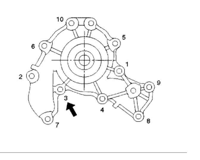

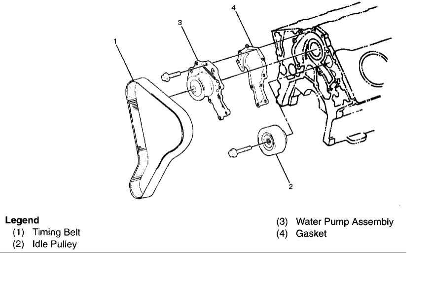

I have found some diagrams and a guide to give you an idea on what you are in for when doing the job.
You will need to disconnect the battery and drain the coolant to begin. You should jack the car up to make it easier to work on
Here is a generic water pump replacement guide.
https://www.2carpros.com/articles/water-pump-replacement
Timing belt and serpentine belt diagrams.
https://www.2carpros.com/diagrams/honda/passport/2001

No on the radiator, just has to be drained. Crank pulley not usually unless it is damaged, idler, tension-er and actuator get replaced. Take a look at the AISIN TKH012 or ACDELCO TCKWP303 or GATES TCKWP303 timing kit with water pump. It includes the parts you need.
It is not a super hard job just multiple steps involving the timing belt that have to be followed properly to avoid engine damage. I would also do a coolant flush and change the thermostat while you have it drained.
