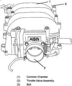

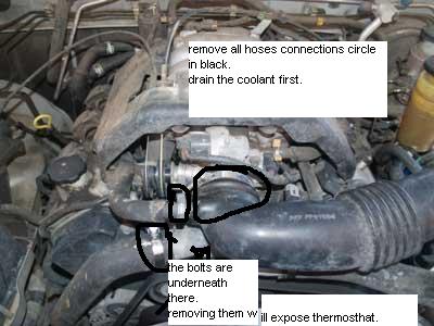

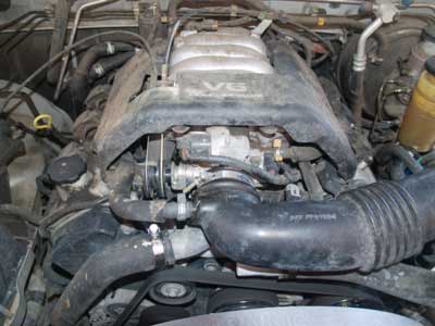

I need to replace the thermostat. Where can I find an exploded view of the intake manifold plenum, coolant tubes and thermostat? I need to see what I need to remove to get to the thermostat and it is buried under a lot of stuff. I looked at Haynes repair manual, but what they show cannot be right for my model. I have a V6-3.2L engine (RLV type). These cars are essentially Isuzu's with Honda logos as you know.
