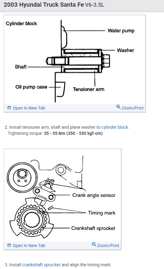

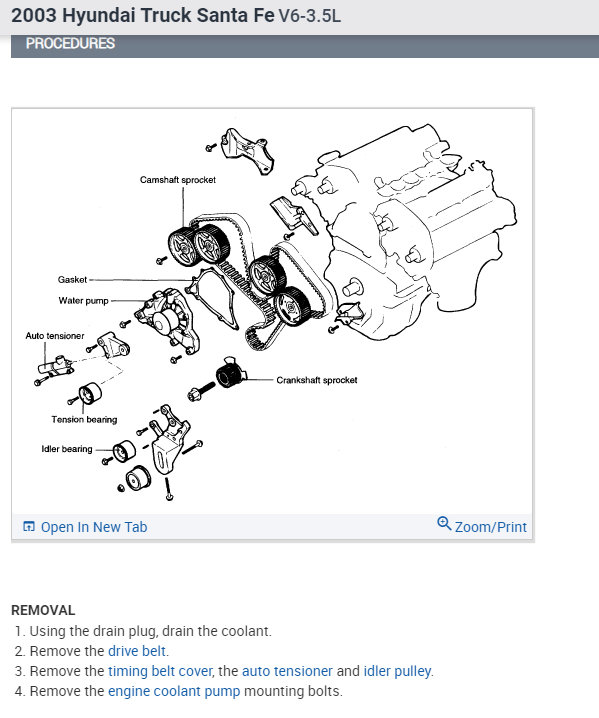

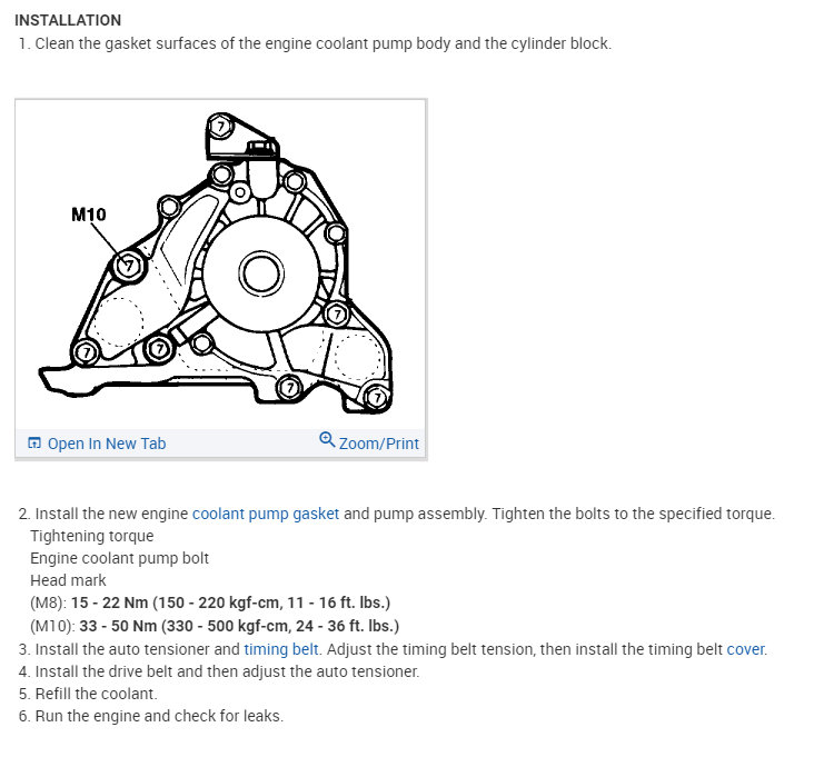

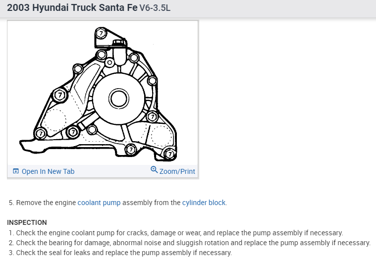

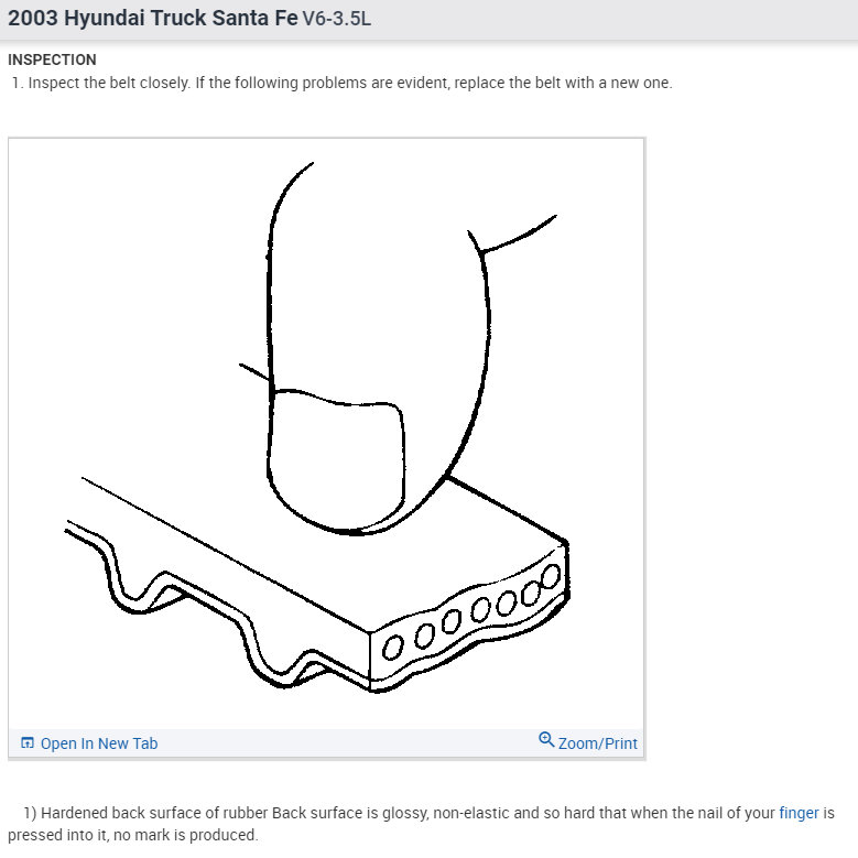

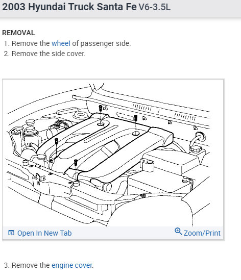

Water pump needs to be replaced and need to know the correct procedure.
Jan 23, 2022 at 9:37 AM
SQM
  • 6,383 POSTS

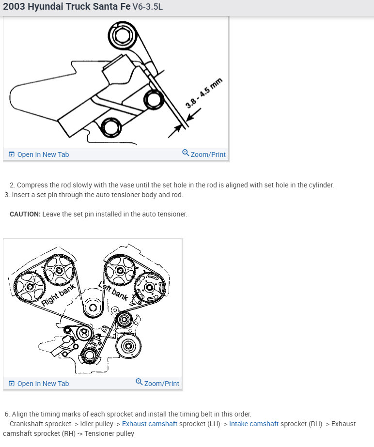

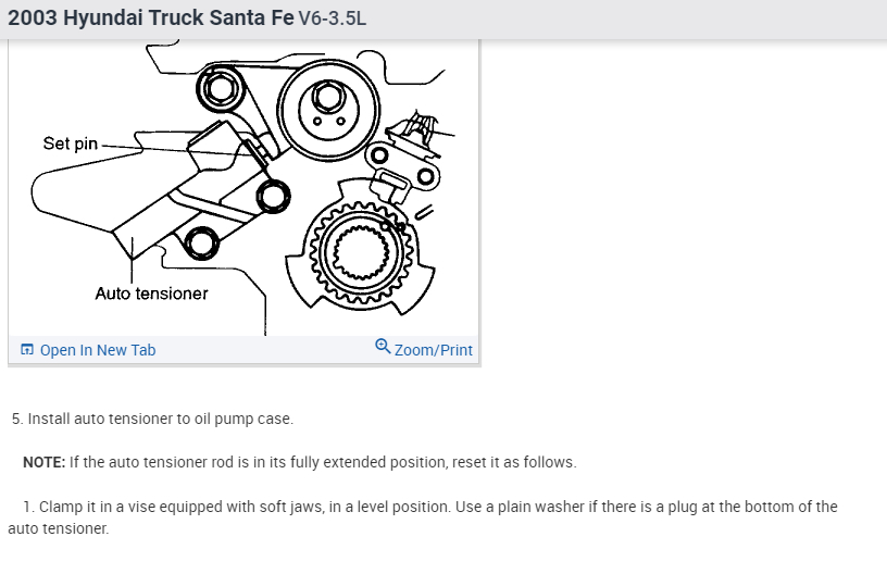

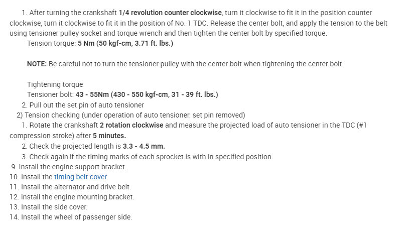

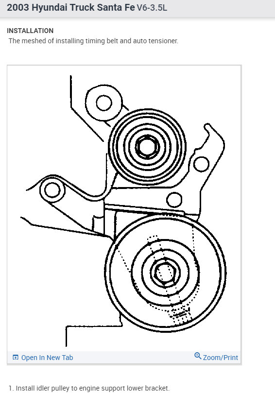

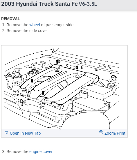

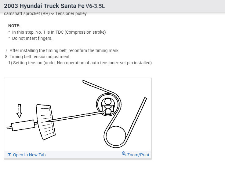

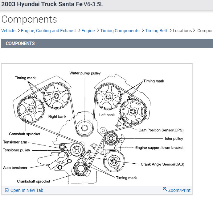

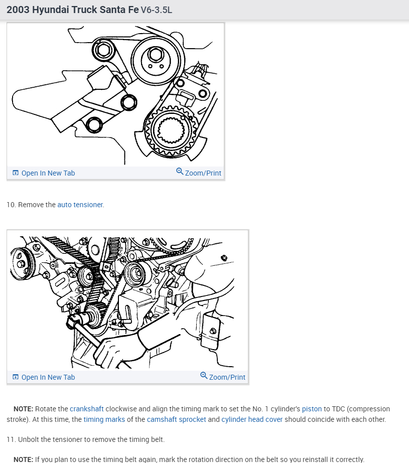

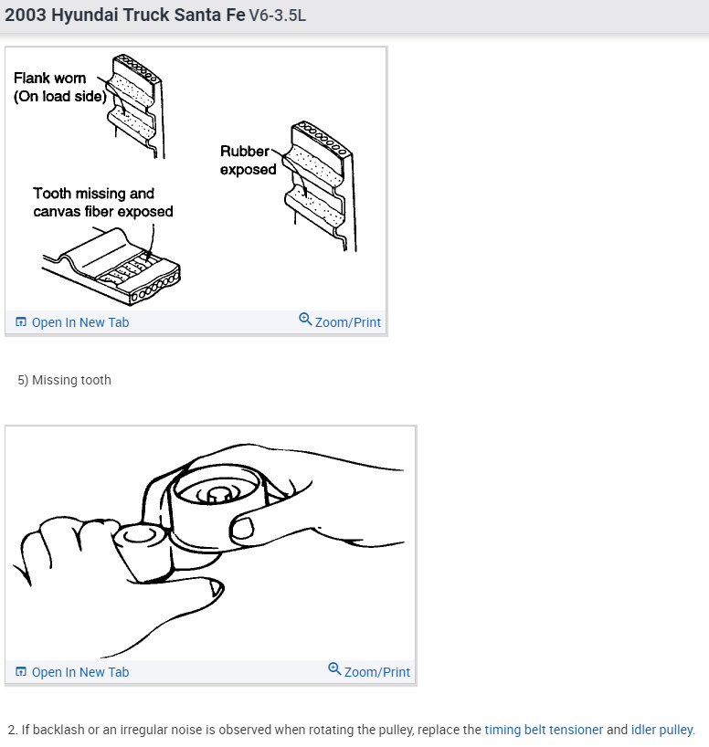

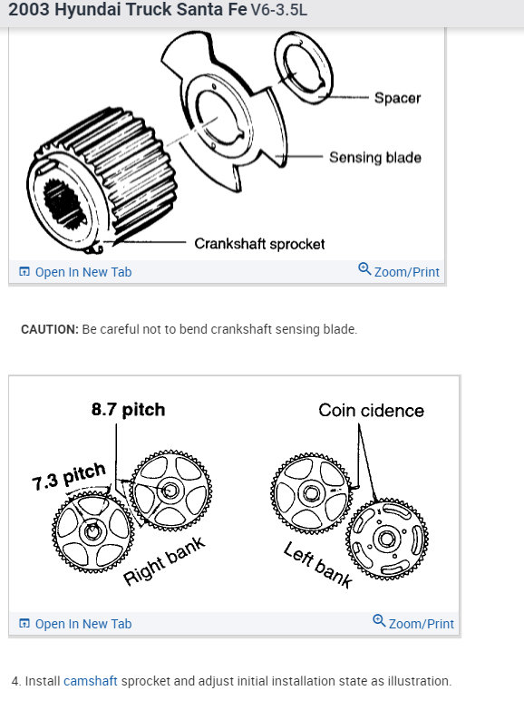

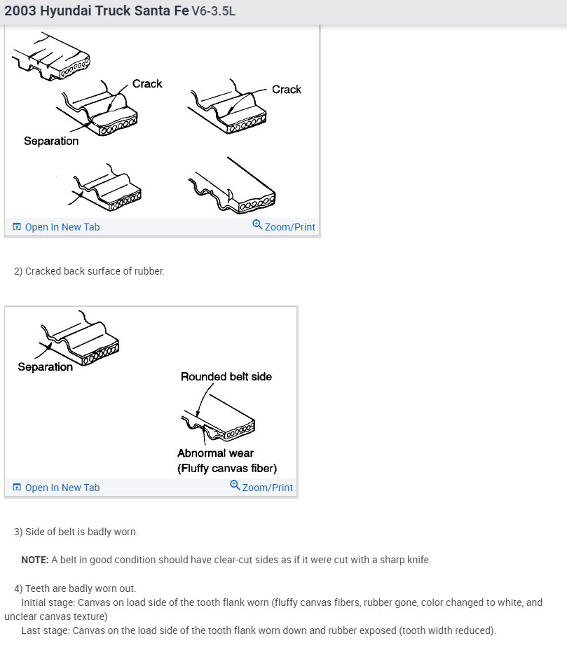

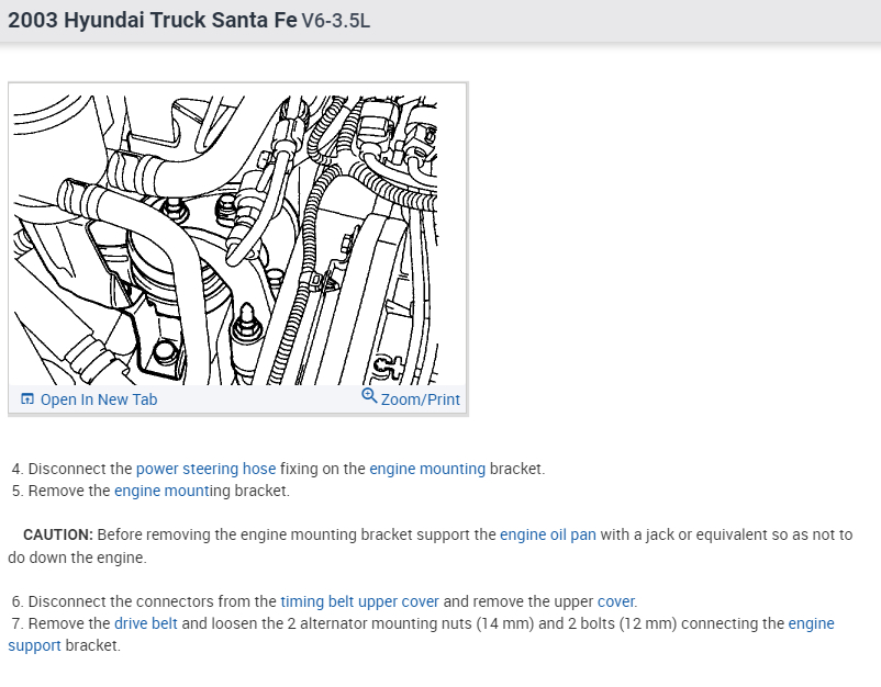

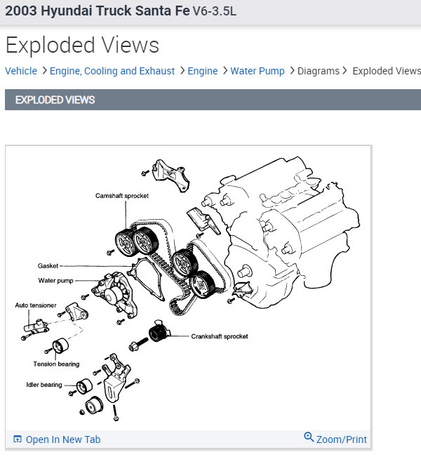

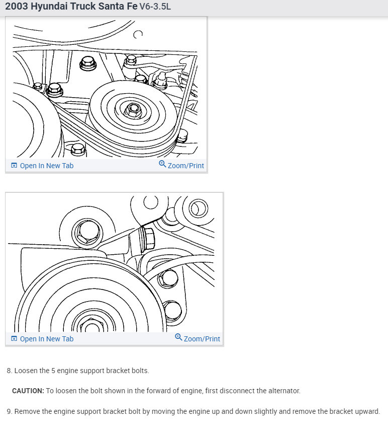

On this vehicle in order to replace the water pump, the timing belt and tensioner need to be removed as well.
It is always a good idea to replace the water pump, timing belt, tensioner all at the same time give the process that is involved with it.
I have attached the water pump along with the timing belt replacement procedure below.
https://www.2carpros.com/articles/water-pump-replacement
