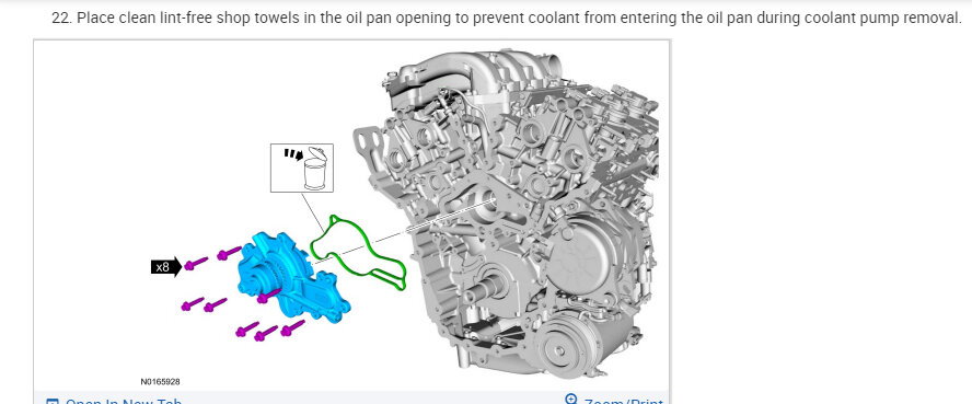

Leaking water pump.
Jun 4, 2023 at 1:39 PM
  • 110,251 POSTS

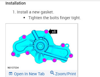

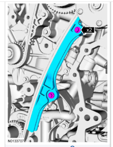

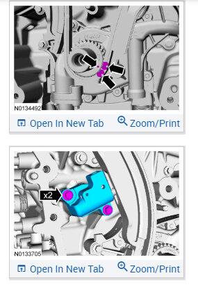

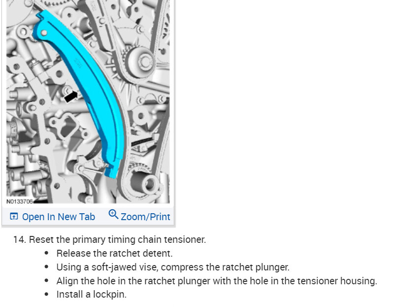

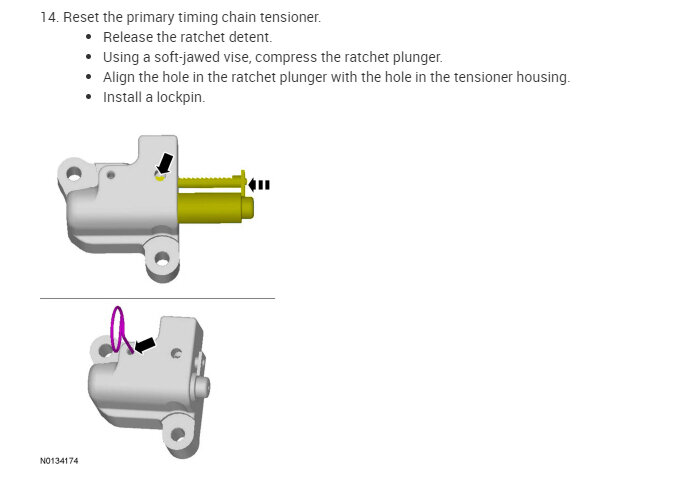

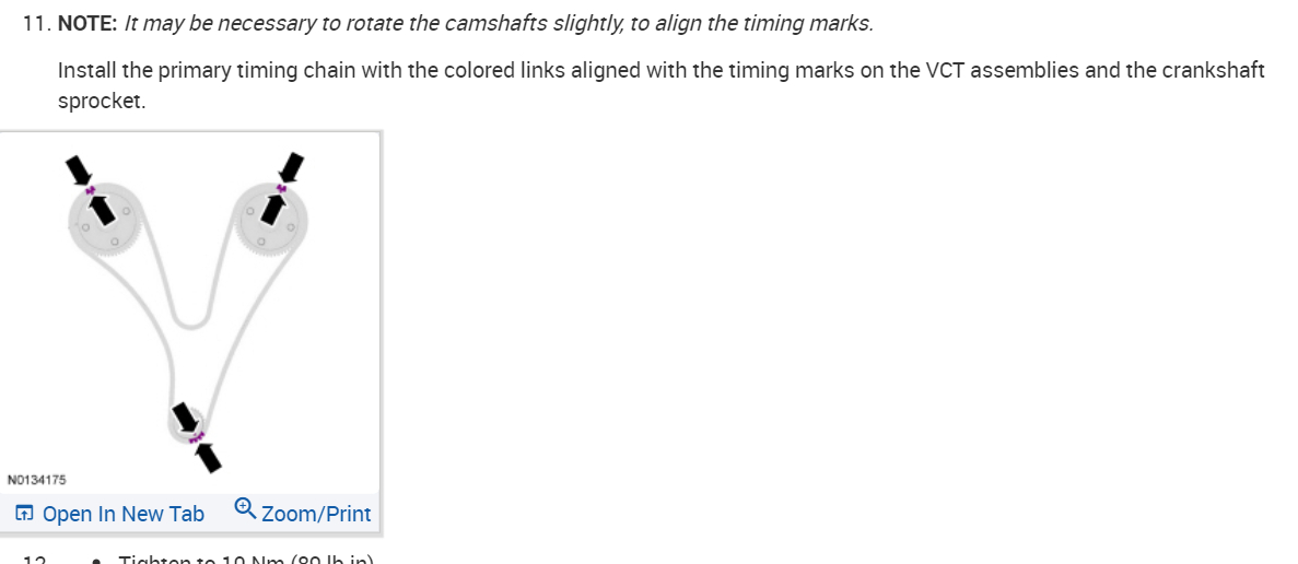

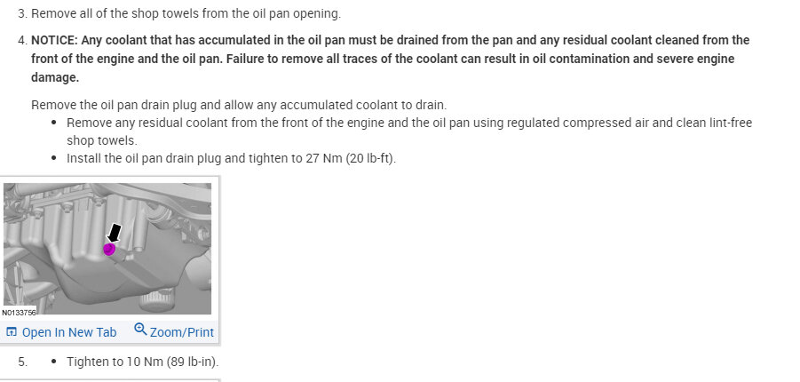

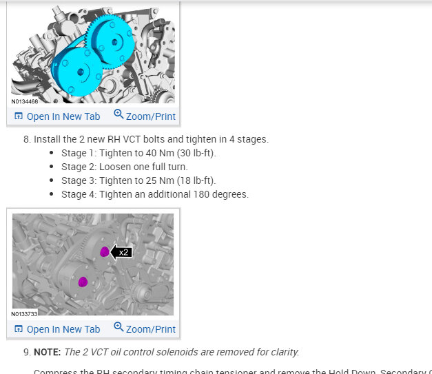

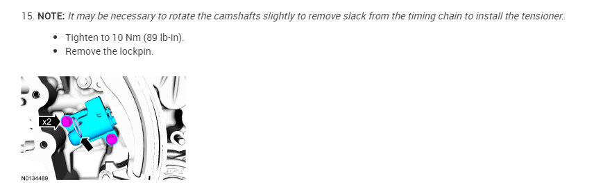

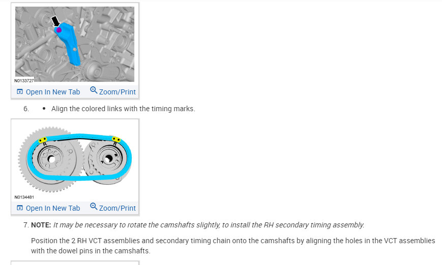

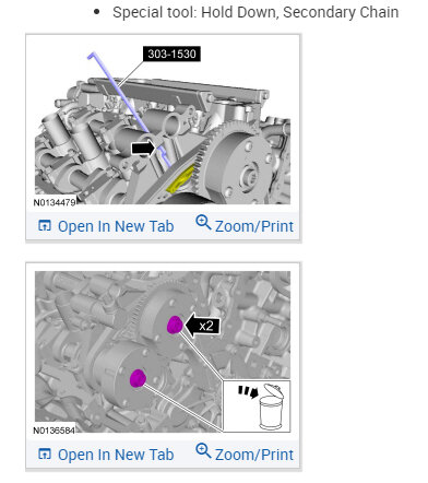

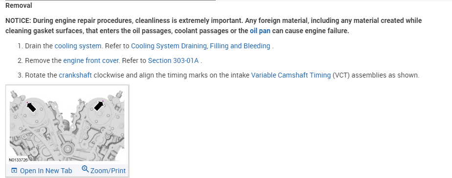

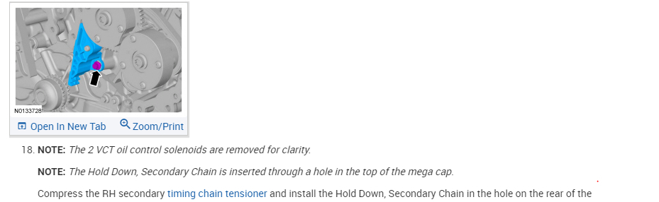

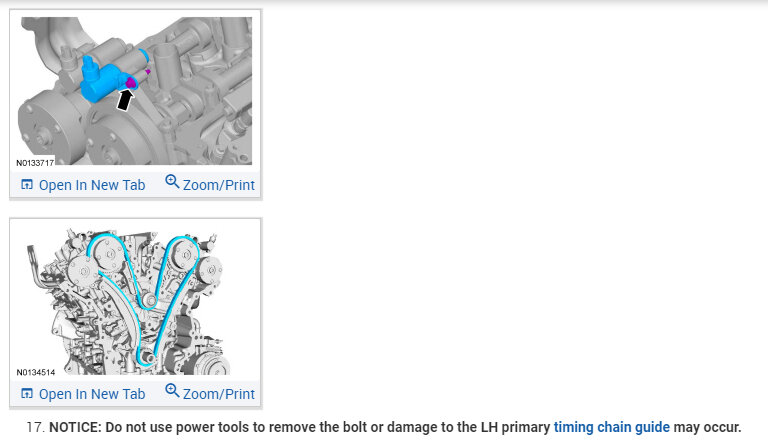

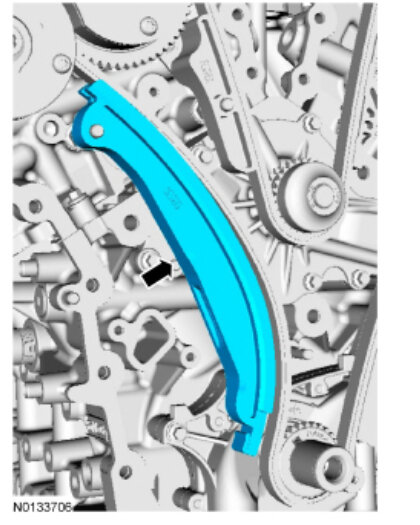

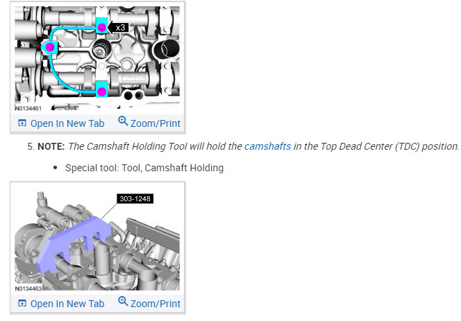

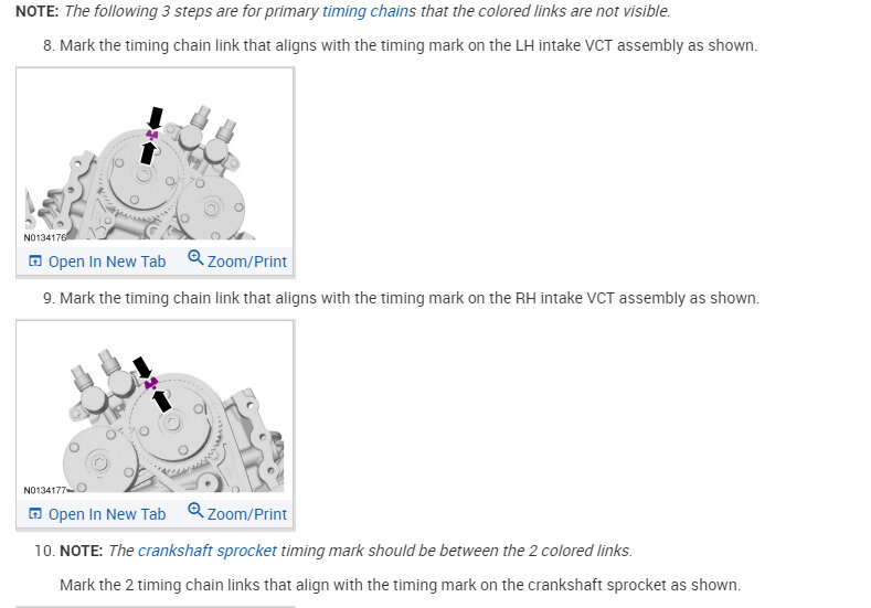

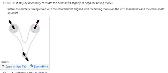

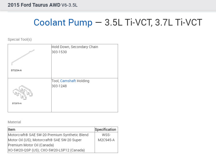

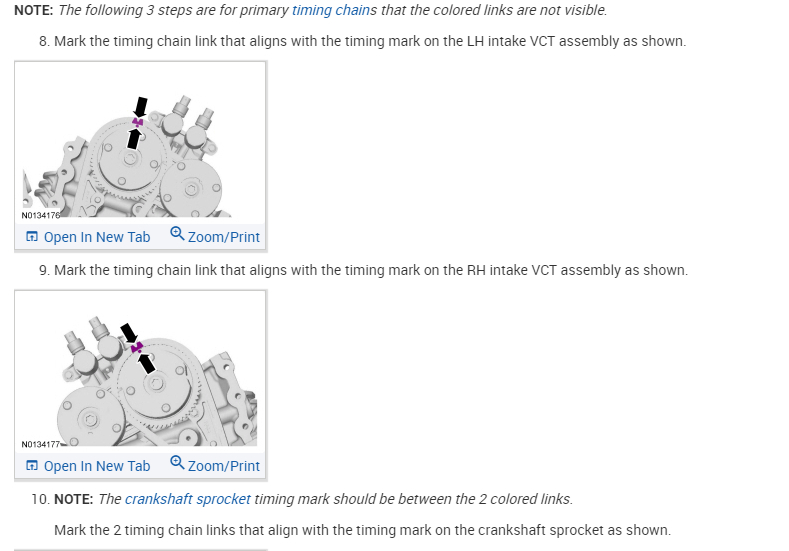

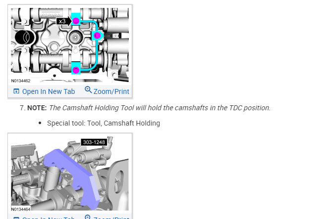

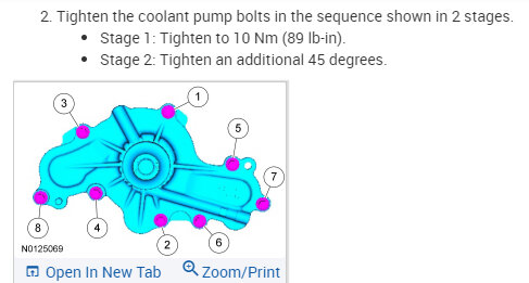

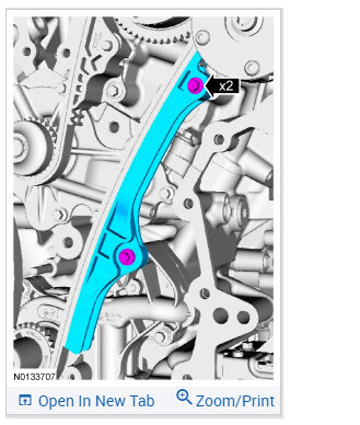

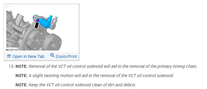

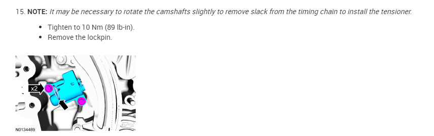

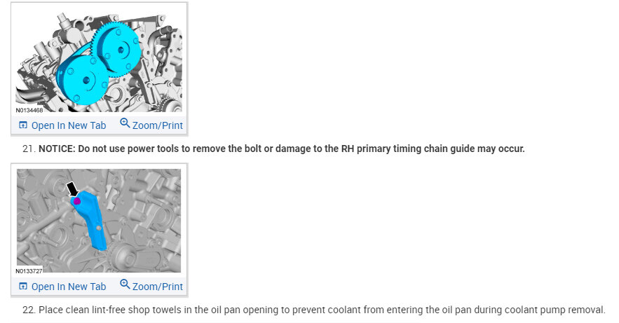

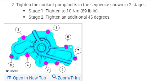

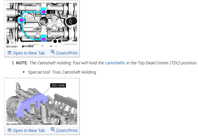

Replacing the water pump on this engine requires the removal of the timing chain, so it is somewhat involved.
If you look below, I attached the directions specific to this vehicle for pump replacement. Take a look through them and let me know if you have questions.
