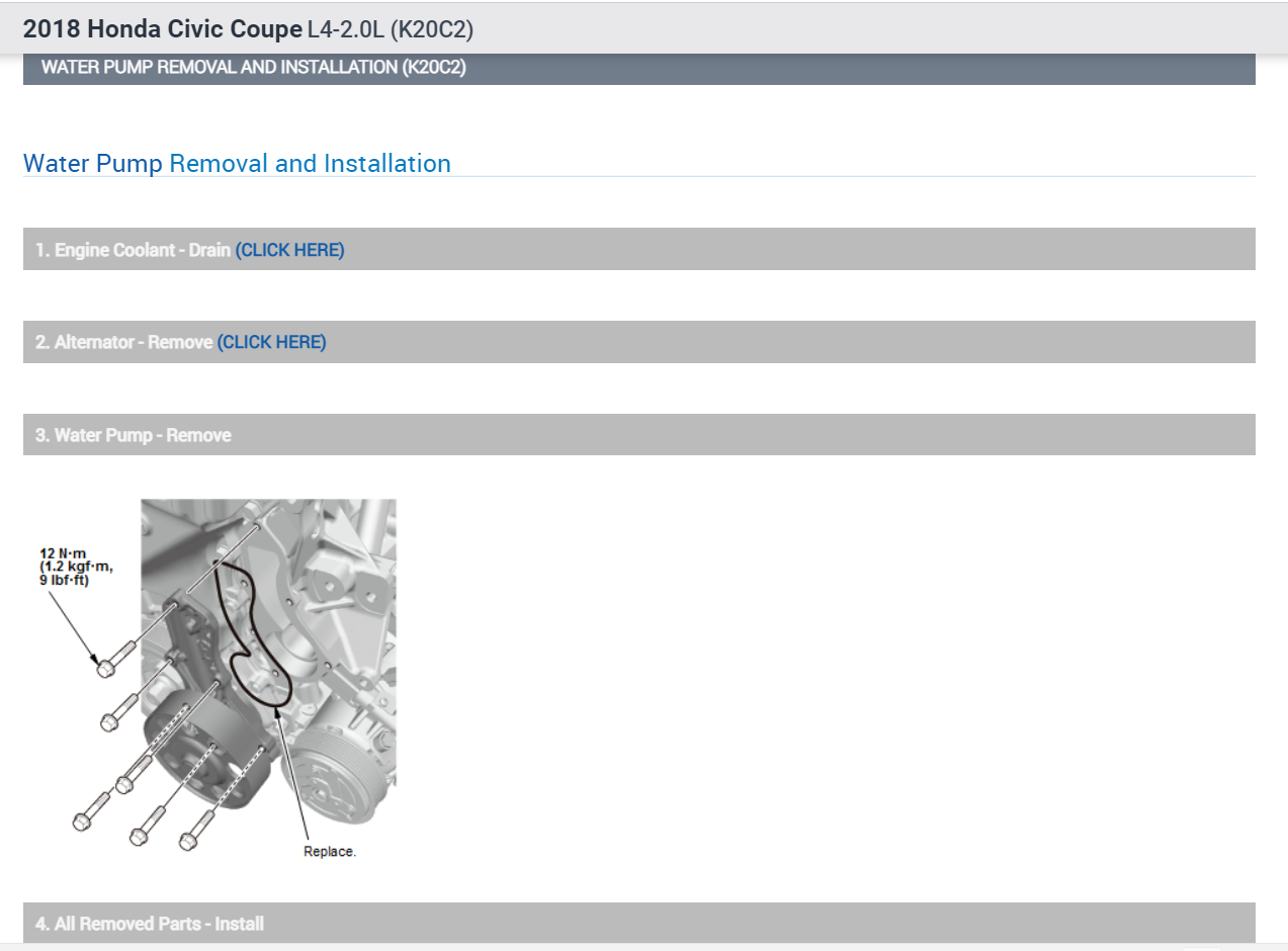

Just replaced the water pump because of a bad pulley. Ran coolant through and it is now overheating. I burped the lines as much as possible and don't understand what the issue could be. Any help would be great.

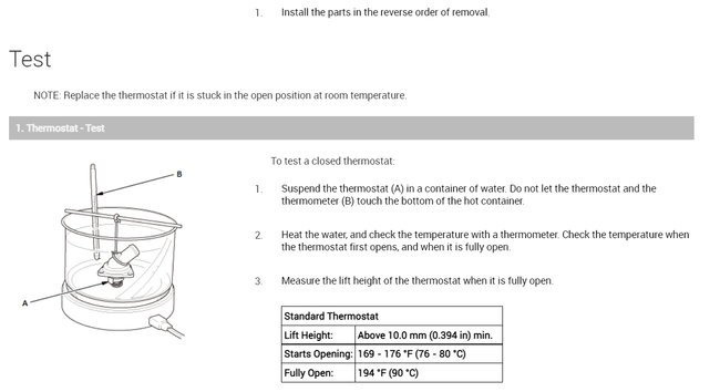

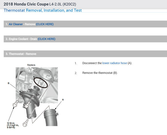

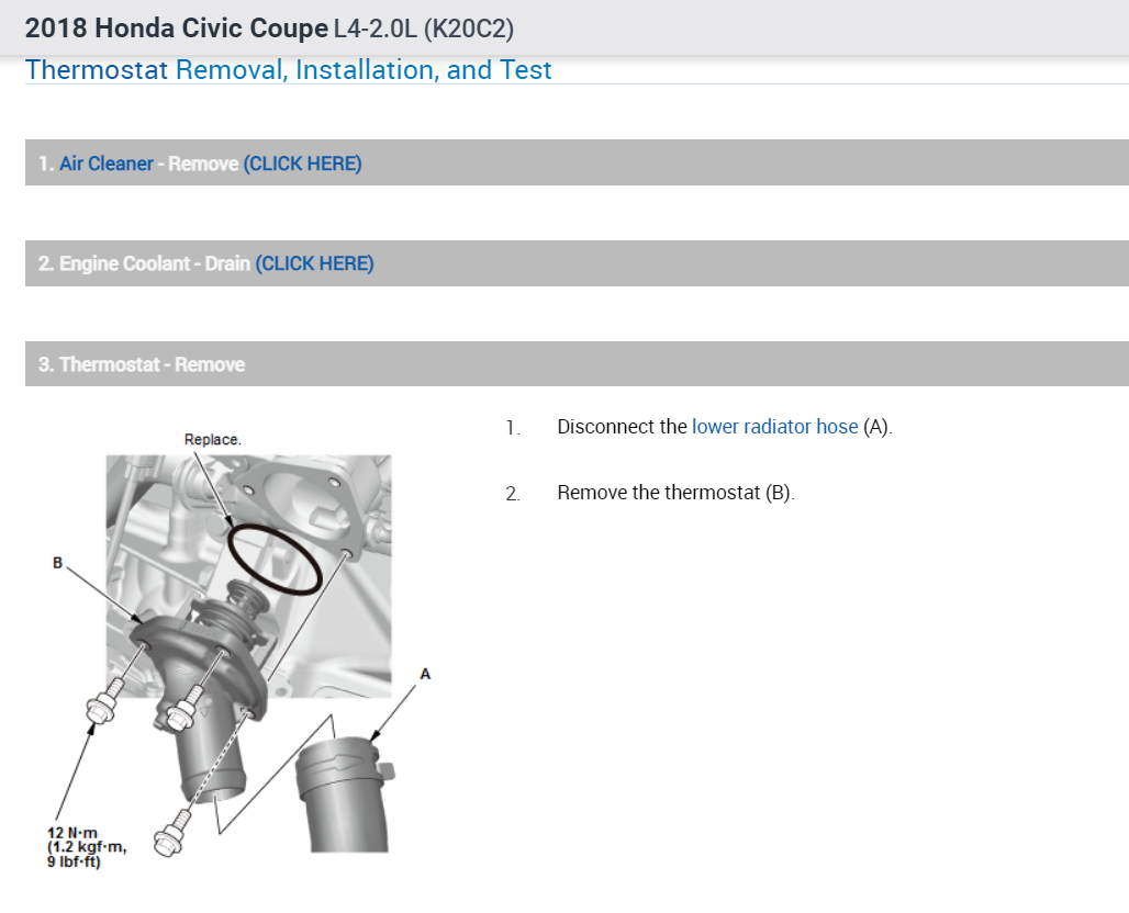

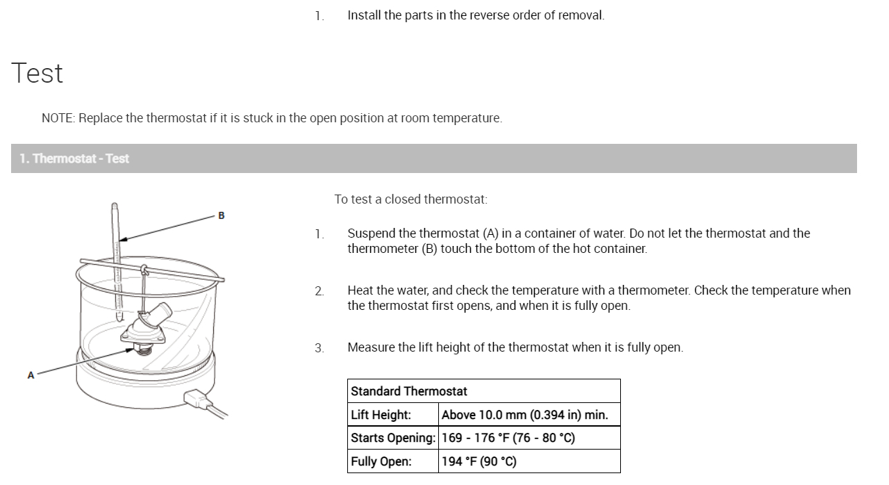

There are no special instructions on how to refill the system. How fast does it overheat? does it act like thermostat is stuck closed? With the engine cold I would remove the upper radiator hose and try to fill the system through the hose and directly into the radiator. If that does work here is how you can change the thermostat out in the images below. This guide can help as well:

Yep, air pockets can form which it takes a while to get out of the system I have heard of people jacking the rear and then the front of the car up while it is running to add coolant which helps.
