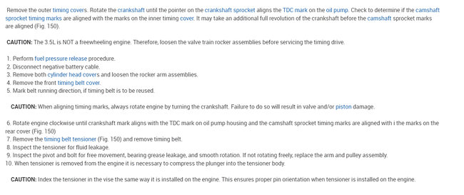

Brought the car used and got home and water started pouring out. Since the hose wasn't busted, I figured it was the water pump. Tried looking at videos on YouTube, but not helping, (says my vehicle but video works on another vehicle).
Mar 8, 2022 at 11:20 PM
  • 110,248 POSTS

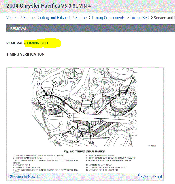

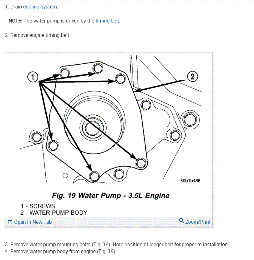

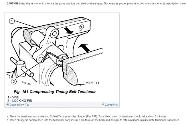

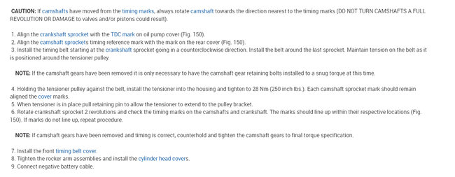

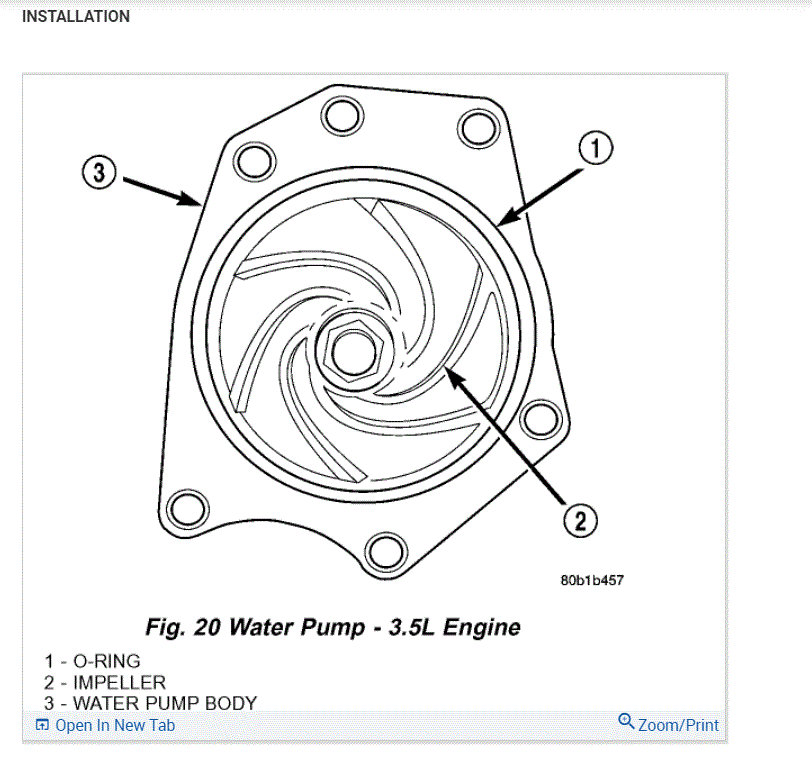

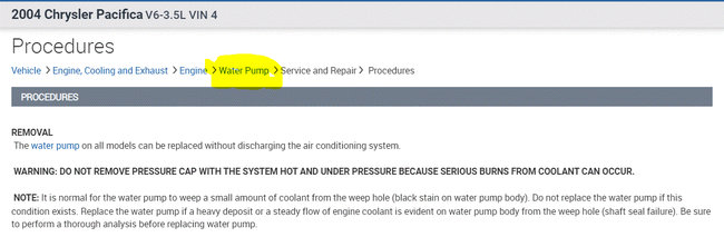

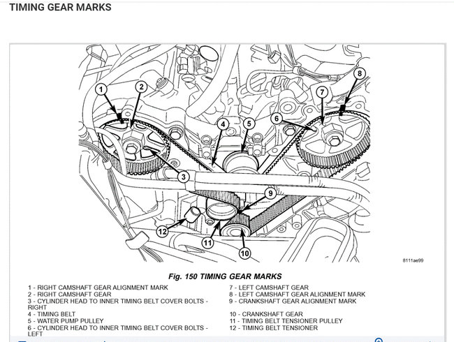

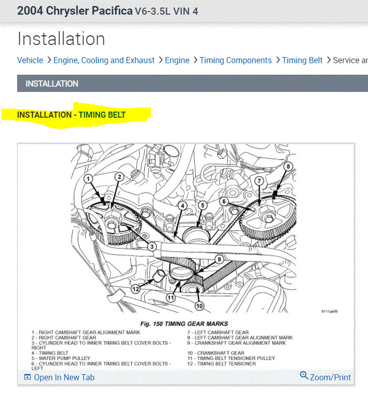

To replace the water pump on this vehicle, you will need to remove the timing belt. Unfortunately, it isn't a simple one to do.
If you look below, I start with the directions for the removal and replacement of the timing belt. At the end of those directions, I included the (at that point) simple directions for the pump replacement.

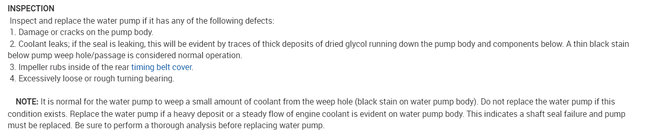

Please confirm the pump is bad prior to replacement. This is a larger than the average job.
Let me know if you have questions or if you have other questions.
