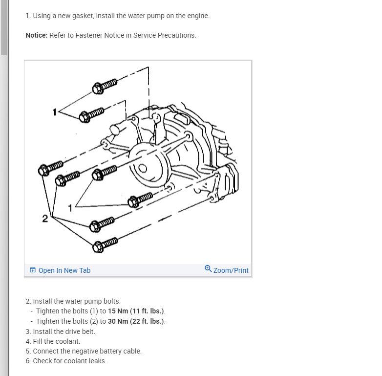

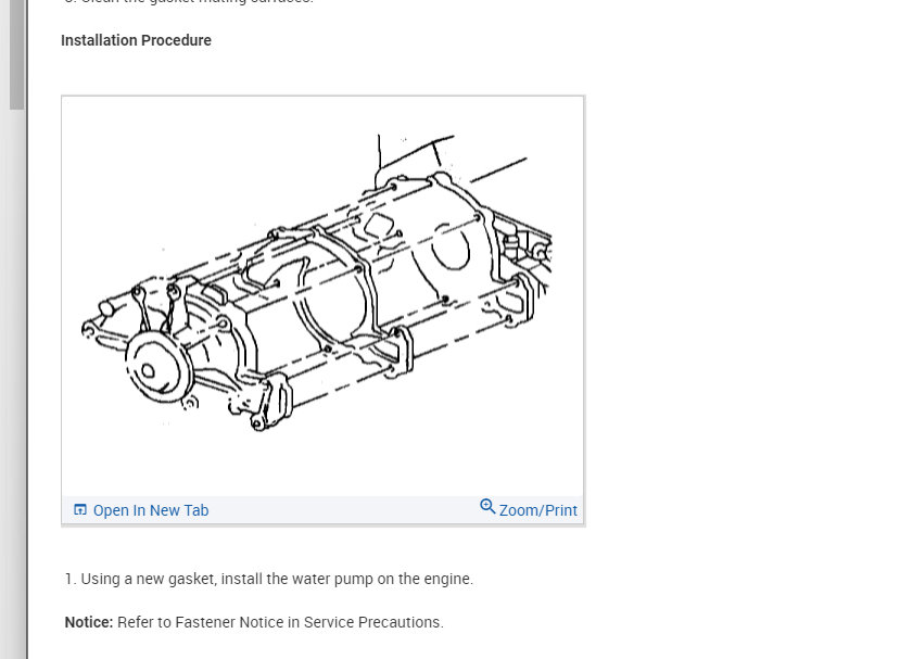

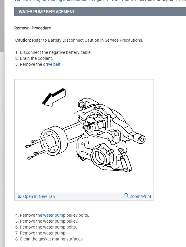

Leaking water out of water pump.
Mar 23, 2017 at 7:33 AM
I will attach the info below on how to replace this but here is a guide that will give some good info as well:
https://www.2carpros.com/articles/water-pump-replacement
Please run through this and then review the info below on how to replace this.
Please let us know if you need more info. Thanks
