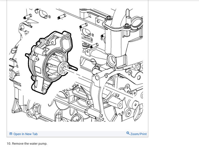

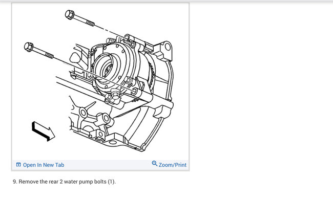

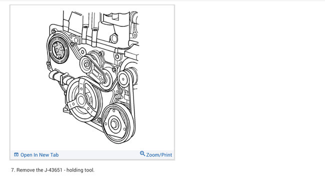

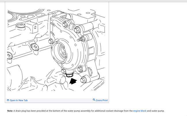

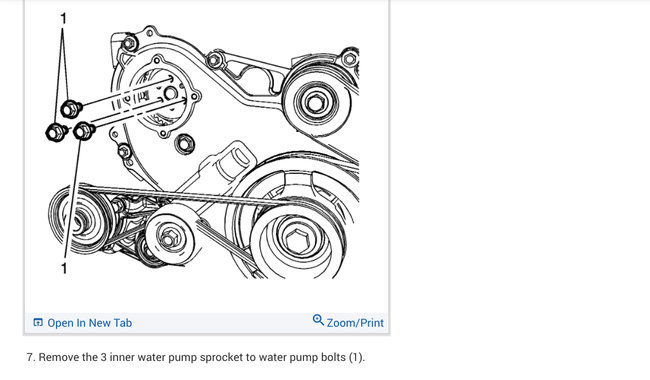

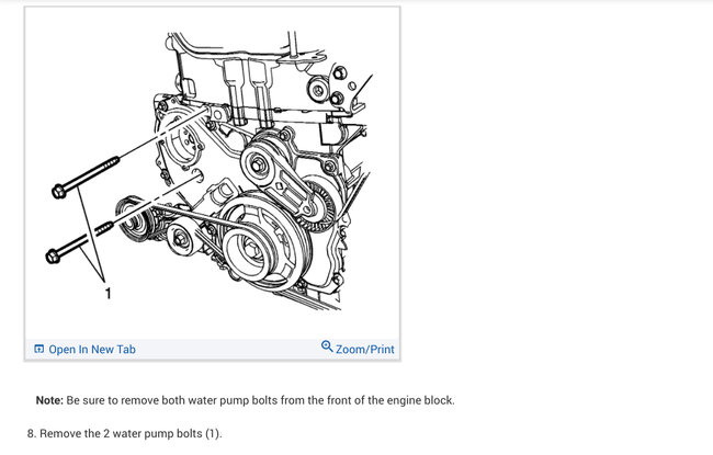

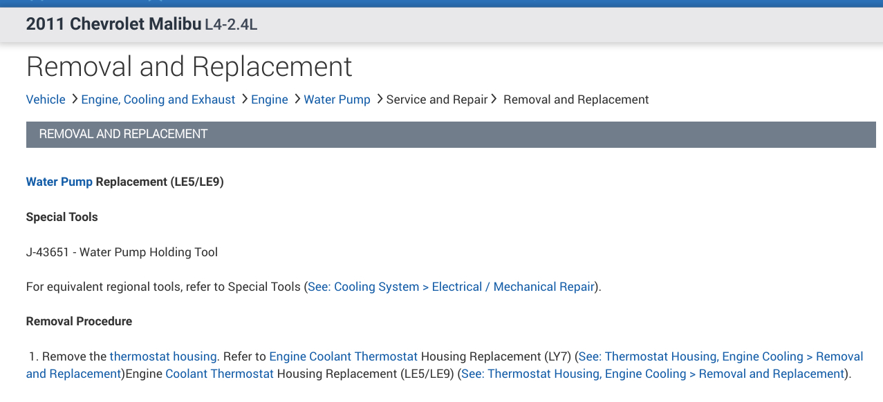

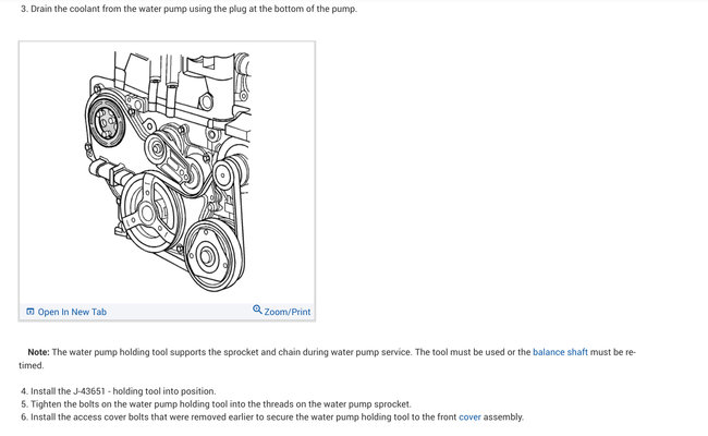

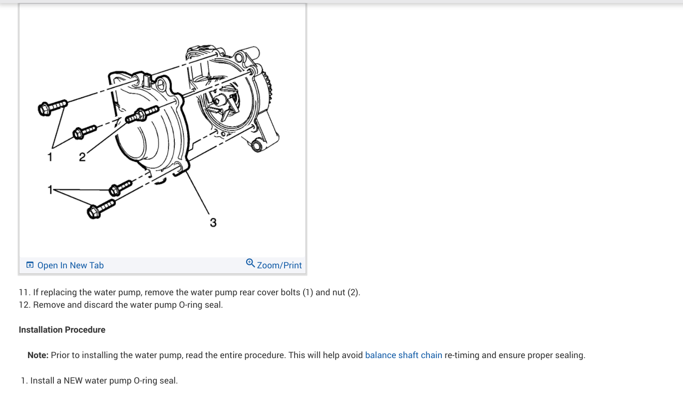

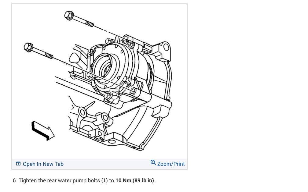

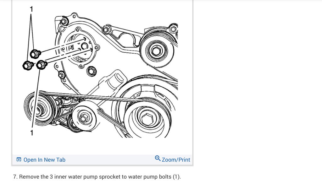

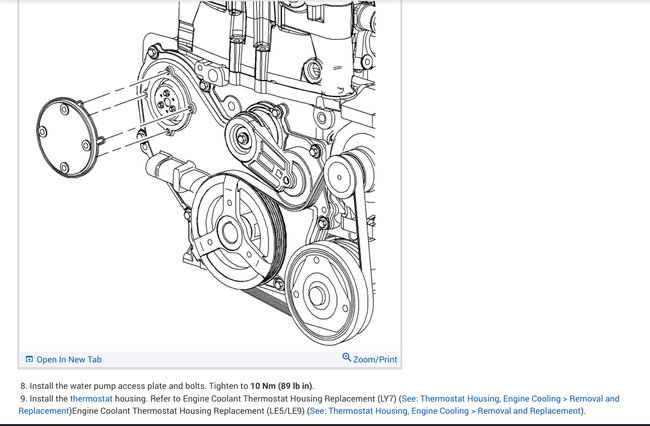

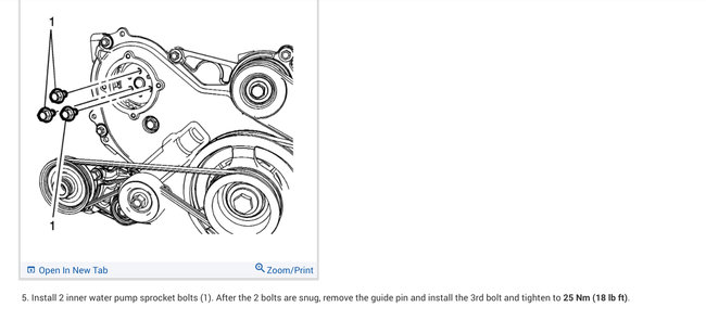

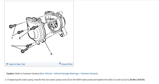

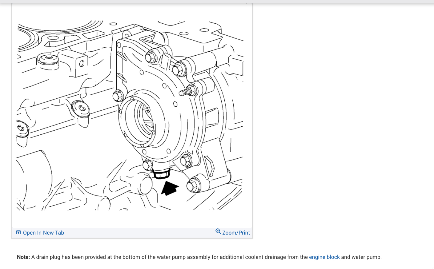

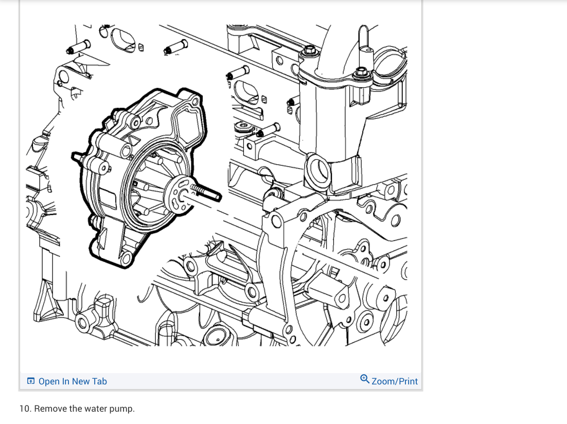

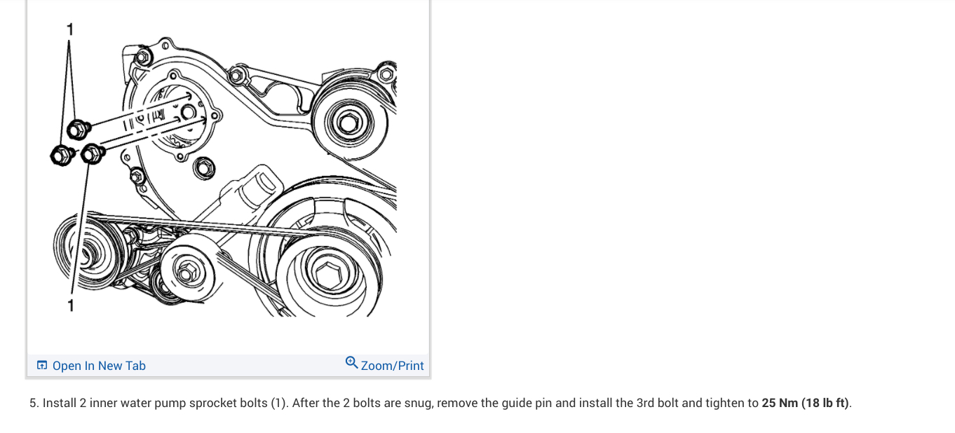

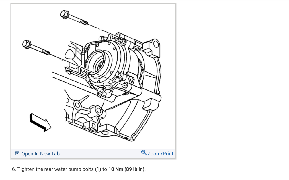

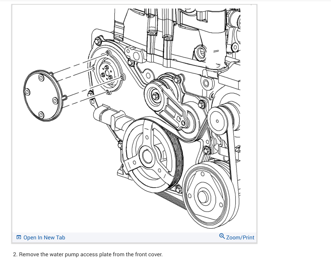

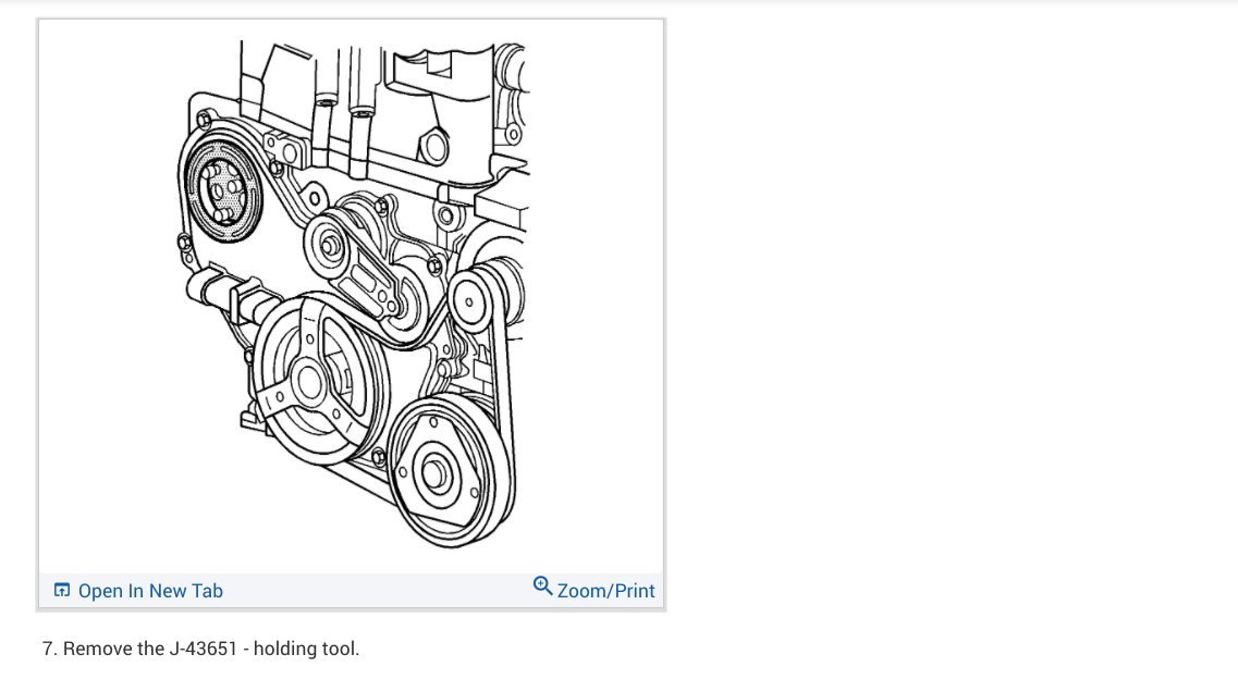

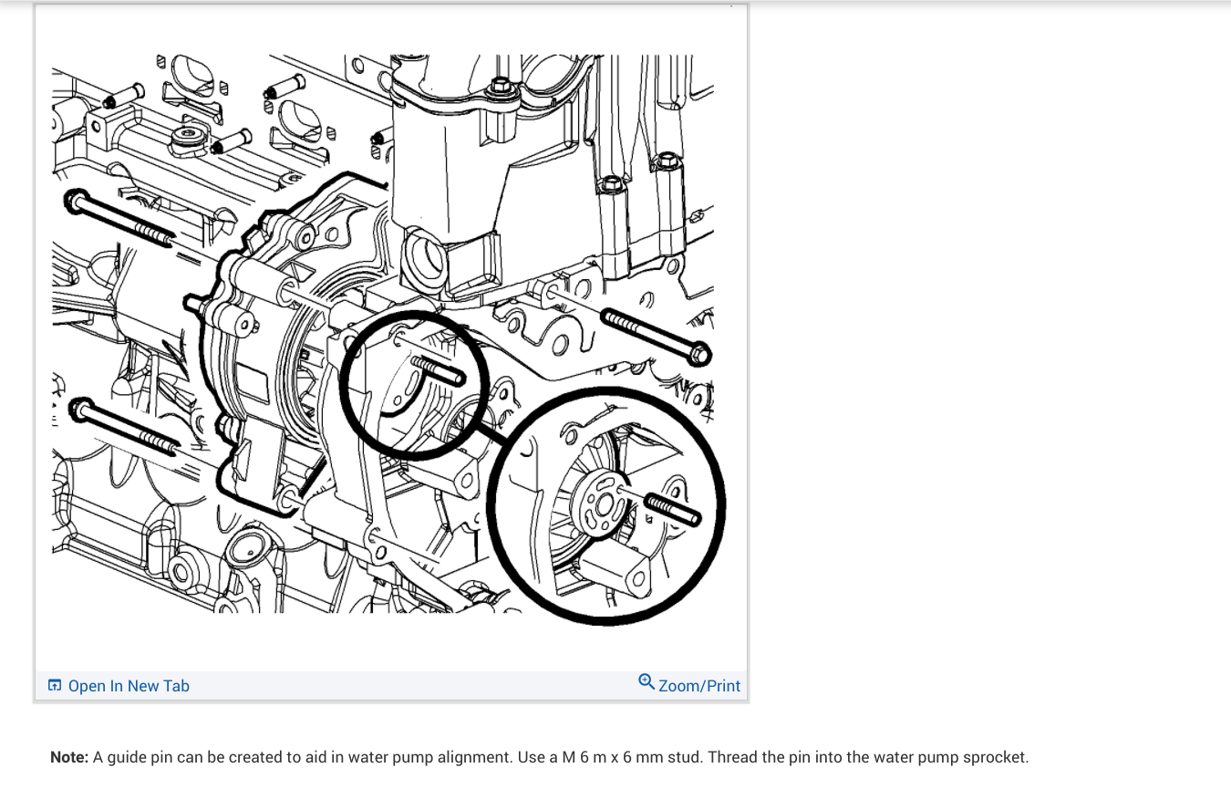

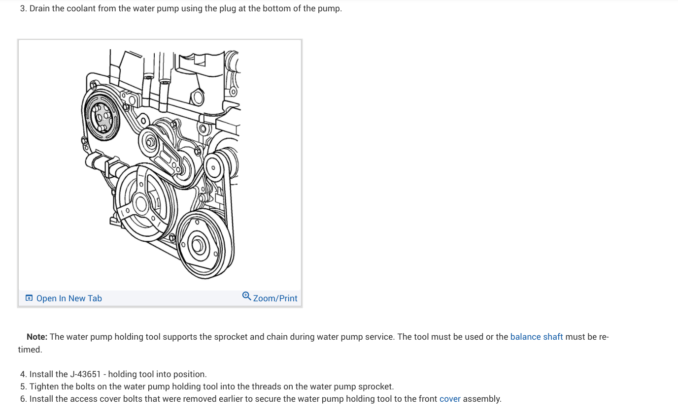

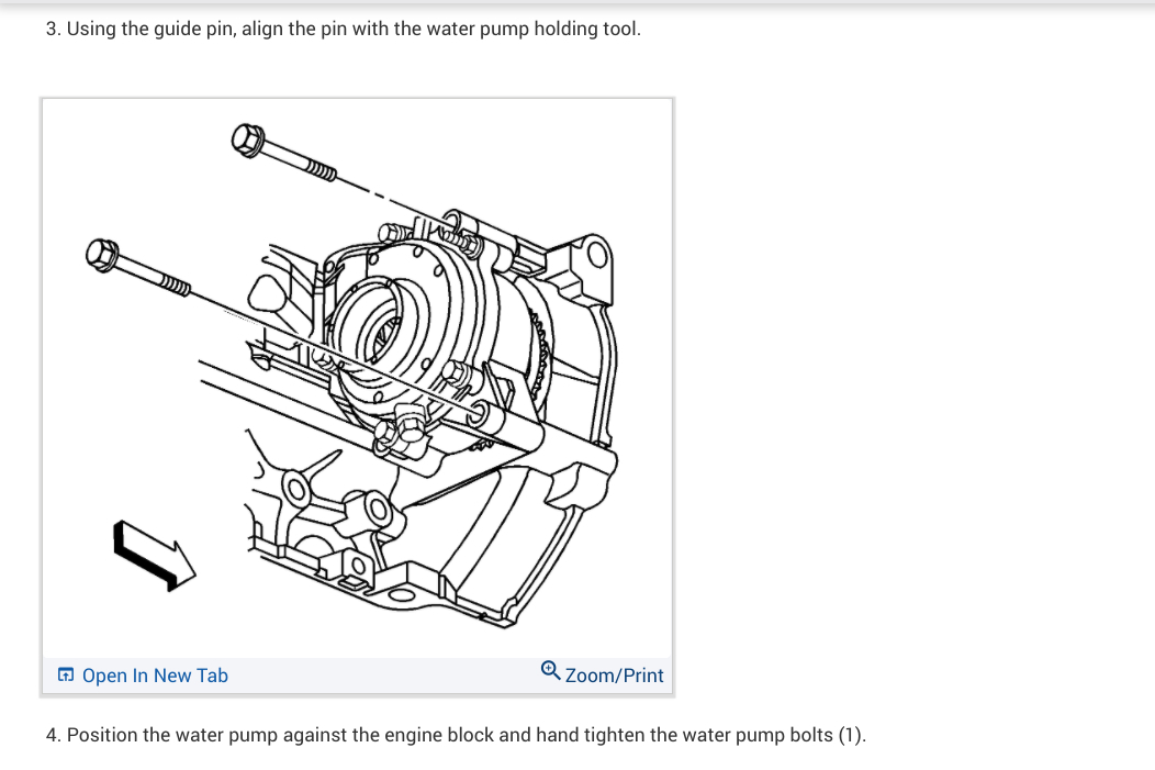

I would like to know exactly what water pump i need for the car listed above.
Jan 16, 2020 at 6:33 AM
SCGRANTURISMO
  • 4,897 POSTS
In the diagrams down below I have included the Original Equipment Manufacturer [OEM] part number for reference as well as the instructions for the removal and installation of the water pump for your vehicle. Please go through these guides and get back to us with how everything turns out.
Thanks,
Alex
