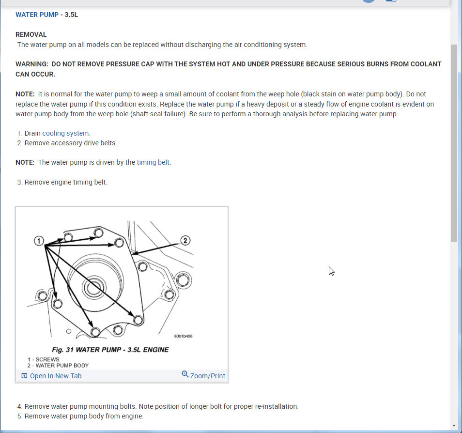

How do I go about removing the water pump?

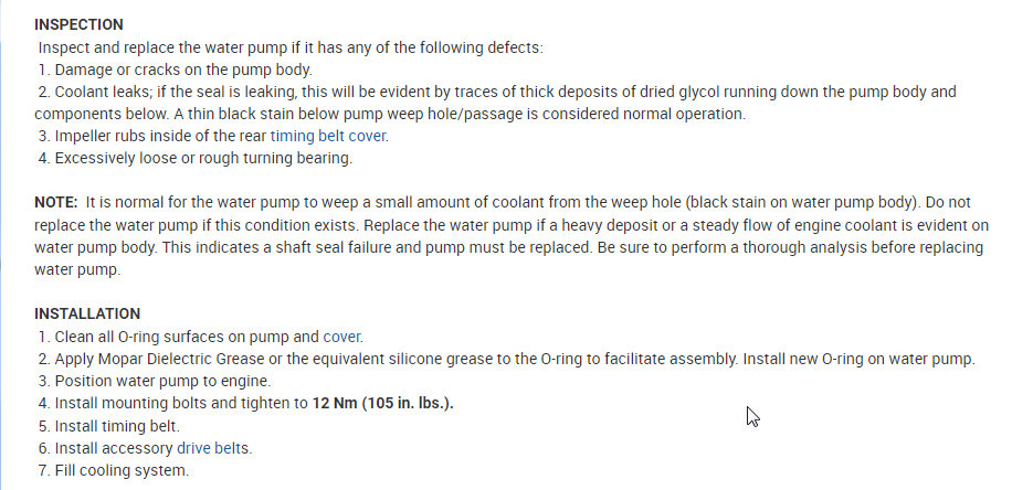

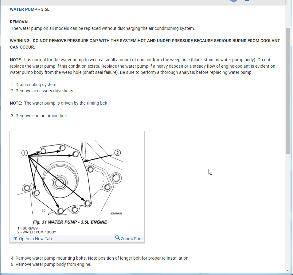

Here is a guide that will help with this as well:
https://www.2carpros.com/articles/water-pump-replacement
Below you will find the process from the manual on this engine. Let us know if you have other questions. Thanks
