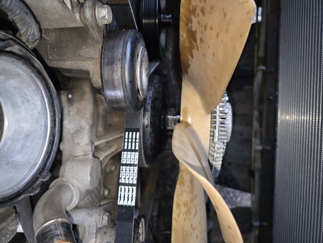

I'm having a very very hard time getting the fan clutch nut off of the pulley. Some people say that you turn it clockwise and some people say you turn it counterclockwise but the way the fan blades look, it looks like you turn it clockwise to loosen it. I cannot for the life of me loosen this nut. I cannot find a pulling range at any parts store. This pulley has four holes in it and supposedly it fits an M8 so you can use a long screwdriver or a pry bar to hold it while you try to turn the nut. I've also tried to put some heat to the nut and still didn't work. I've tapped my wrench with a hammer to try to shock it but nothing works. I even tried turning it counterclockwise and it still won't budge. I cannot hold the pulley well enough to even try to make a real effort to turn the nut. Strap wrenches doesn't work either. Well the Robert ones don't. My question is, it is reverse thread and you go clockwise to loosen it right? Also do you have any ideas on how I can get this fan clutch nut off? I'm changing the water pump

PACKERS27
  • 207 POSTS
How confident that it loosens counter clockwise, there seems to be alot of confusion about it mindless the internet as some goes left. Some goes right. Here's a pic
Dec 13, 2025 at 7:10 AM
STEVE W.
  • 15,351 POSTS
That goes on clockwise so to remove it it has to come off counterclockwise.

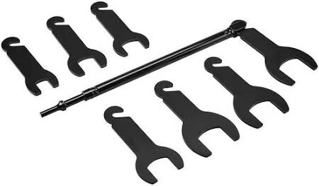

NAA, It just sensed that you were going to cut it off with a torch if it didn't move... I've had some that were VERY stuck, but I also have wrenches for them that most don't have. Those use an impact hammer to break them free.
Dec 15, 2025 at 7:04 AM
PACKERS27
  • 207 POSTS
Yeah I saw them today at a parts store but didn't have an air hammer. I was going to drill a small hole in the nut and use heat and PB Blaster to see if that would work but Im glad I got this off today

Just wanted to clarify that after everything I did, soaking it with WD40 and letting it sit for 12 hours, along with the proper pulley holder wrench made ALL the difference. Thank you guys so much
