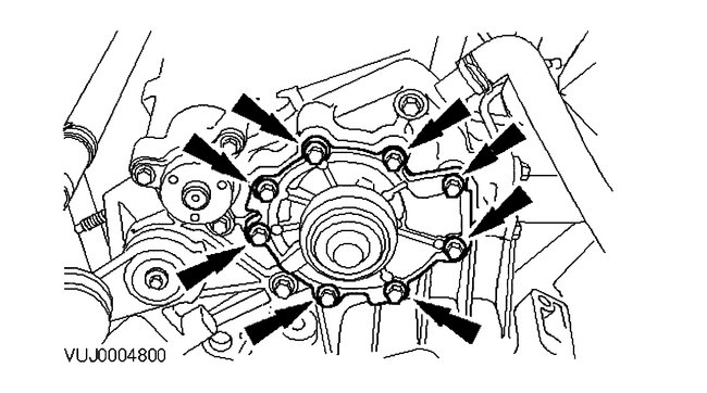

Do I need gasket sealer when fitting?
Jan 25, 2019 at 10:08 PM
  • 110,244 POSTS
No sealer is called for. Just make sure both surfaces are clean and dry. Make sure to tighten the bolts to the proper torque which is listed in the directions. The attached pictures correlate with these directions.
Here are the directions for removal and replacement:
WATER PUMP

See Picture 1

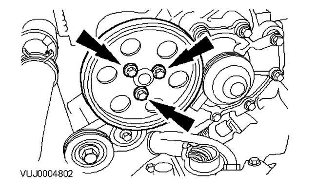

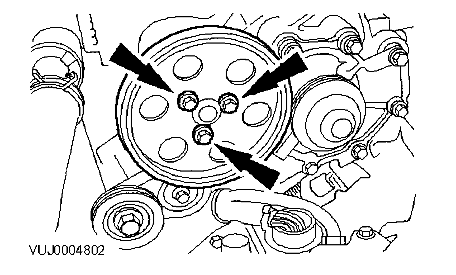

4. Remove the water pump drive pulley.
See Picture 2
5. Remove the water pump.
- Remove and discard the gasket.
Installation
See Picture 1
1. NOTE: Install a new gasket.
To install, reverse the removal procedure.
- Tighten to 10 Nm.
See Picture 2
2. Tighten to 11 Nm.
