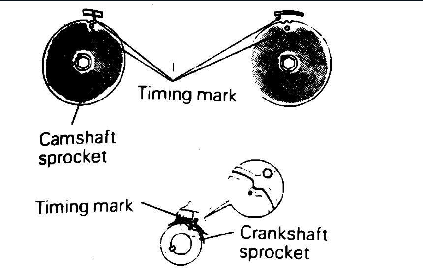

What happened after water pump change? If belts aren’t tight what happens? Will the car start?
Jul 12, 2023 at 4:53 PM
  • 110,194 POSTS
What belt are you referring to? If it is the timing belt, certainly if it isn't timed properly or tight, it won't start. Actually, if this is a DOHC or 24-valve engine, you will cause internal damage if the timing isn't correct.
If it is a SOHC, there are no interference concerns. I attached a pic below of a SOHC engine. Is that how you had the timing marks aligned?
See pic below.

Thanks just fixed the timing in my 93 dodge stealth es.
