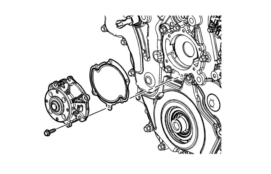

I am getting ready to change out my water pump on my own. Any advice before I start would be helpful. Please and thank you.
Jun 12, 2018 at 2:09 AM
Experienced Mechanic
52,796 POSTS
Good afternoon.
Remove the belt and then follow the prodeure below.
Drain all the coolant as well.
Good luck.

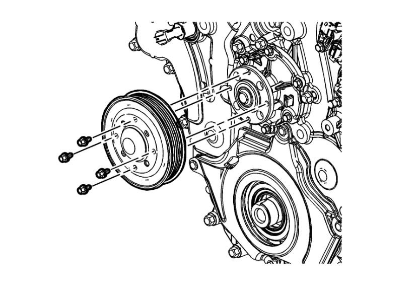

Water Pump Removal

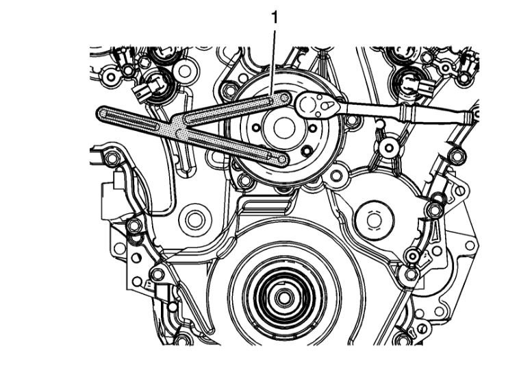

Tools Required
EN 46104 Water Pump Pulley Holding Tool
imageZoom/Print
1. Install the EN 46104 onto the water pump pulley.
imageZoom/Print
2. Remove the water pump pulley bolts.
3. Remove the water pump pulley.
