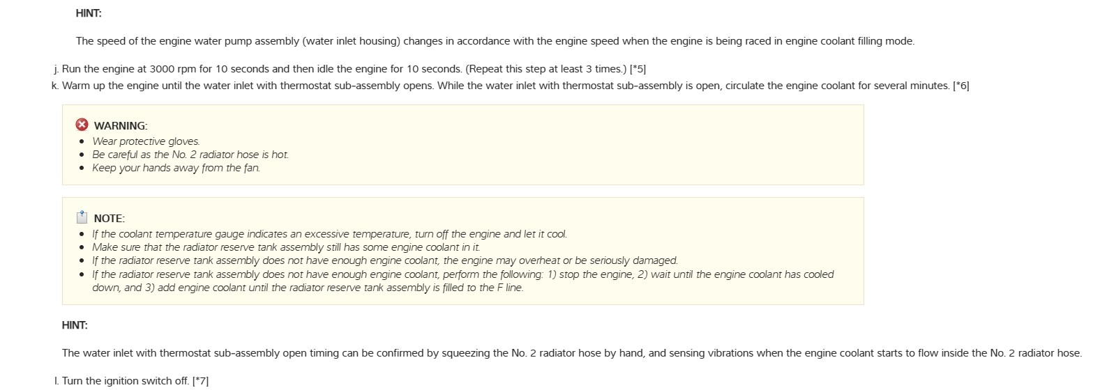

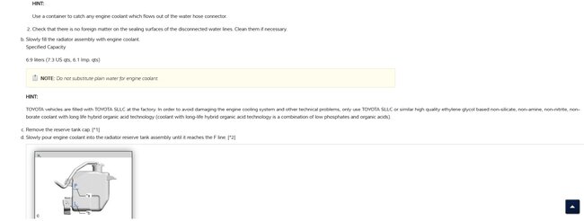

No heat after replacing the water pump?
2018 TOYOTA CAMRY
76,000 MILES • 2.5L • 4 CYL • 2WD • AUTOMATIC
MGULLEY
Water pump.
Mar 11, 2023 at 3:36 PM
BRENDON S
  • 653 POSTS
Good morning, MGULLEY,

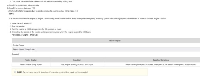

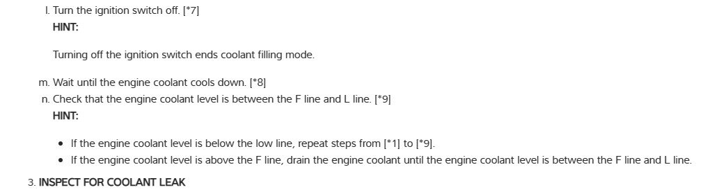

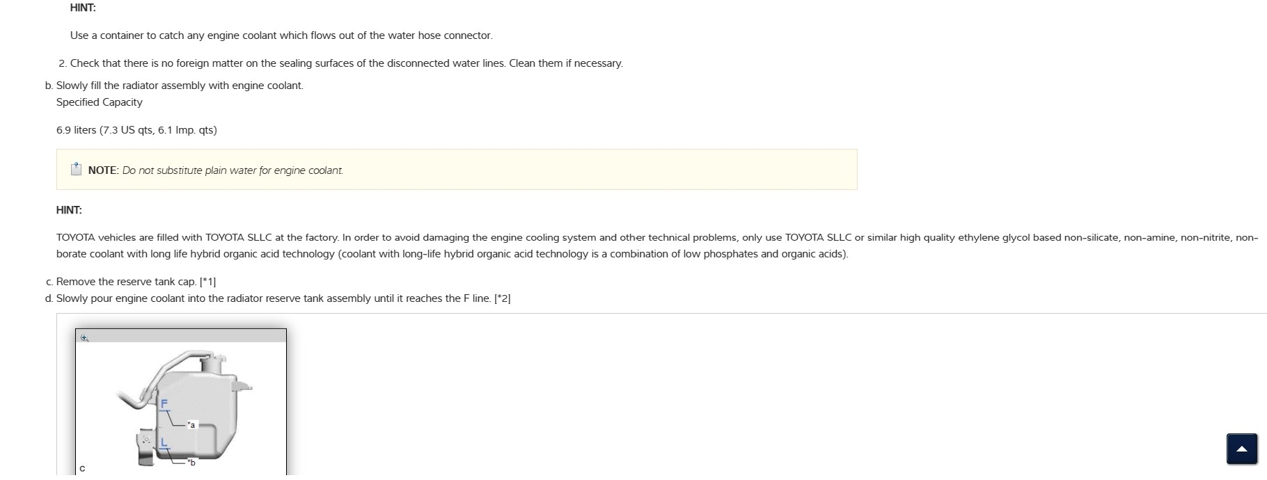

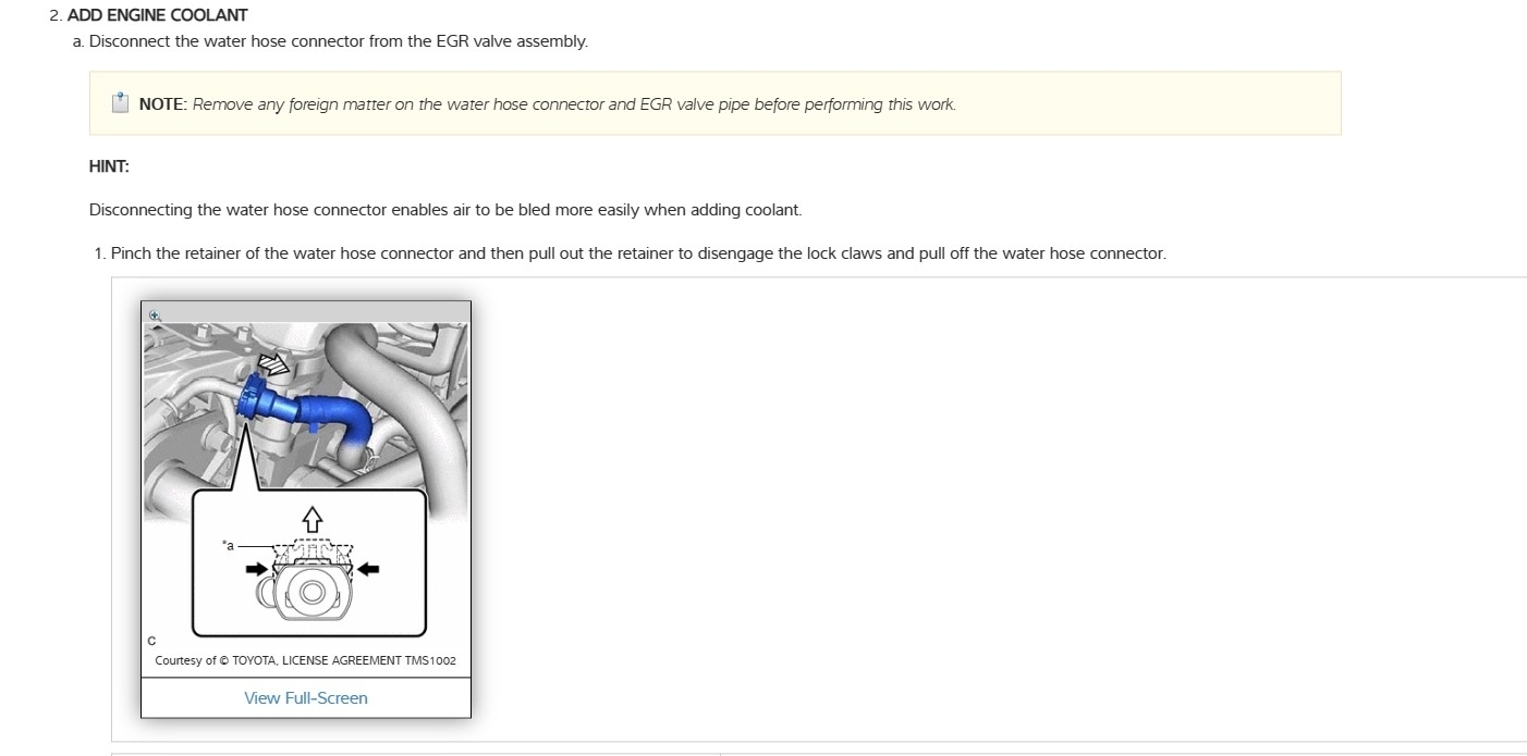

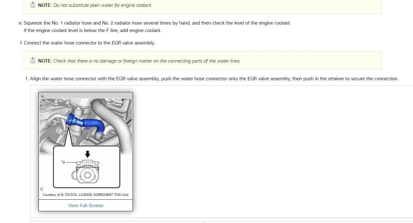

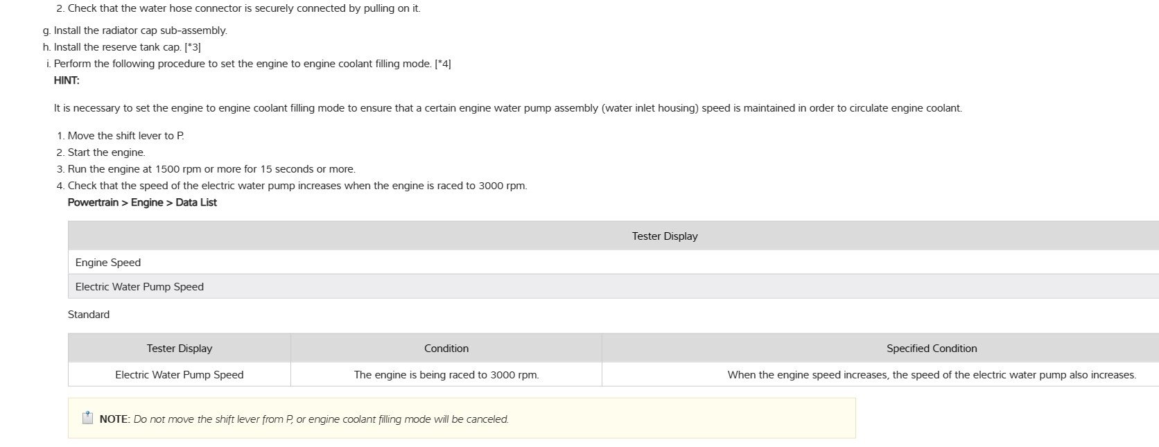

It sounds like you might have air in your cooling system. Toyota has a certain procedure to bleed the air out of the coolant system.
I have added this procedure for you. Let me know if I can help in any other way.
Thank you,
Brendon
