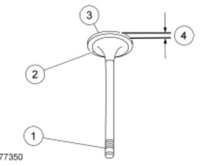

Just want to know if the water pump goes will the head need replacing? The belt had about ten teeth missing but did not snap. It is in a garage at the moment and they are saying they have changed the head because one of the rods was bent.
Oct 26, 2018 at 8:17 AM
Good evening.
You have what is called an interference engine. This means that when the timing belt fails and the engine timing is off, the pistons will hit the valves and damage to the valves is the result.
This is why it needs to be replaced. There is valve damage from the timing belt failure.
The head has to be removed and inspected for the valves. They can repair the head rather than just replacing it but that is up to the shop.

Thanks Roy. The water pump failed causing the belt to lose teeth. Would it not be easier changing the valves rather than the head?
Oct 26, 2018 at 9:18 AM
You have to remove the head to access the valves. It is up to the shop as to whether they will do a valve job or replace the head. I always did a valve job as it is cheaper than replacing the head.
