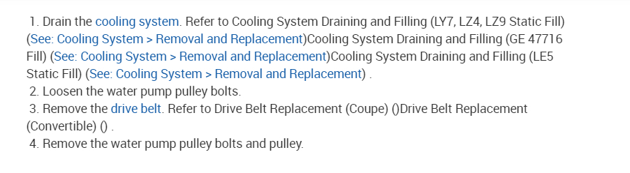

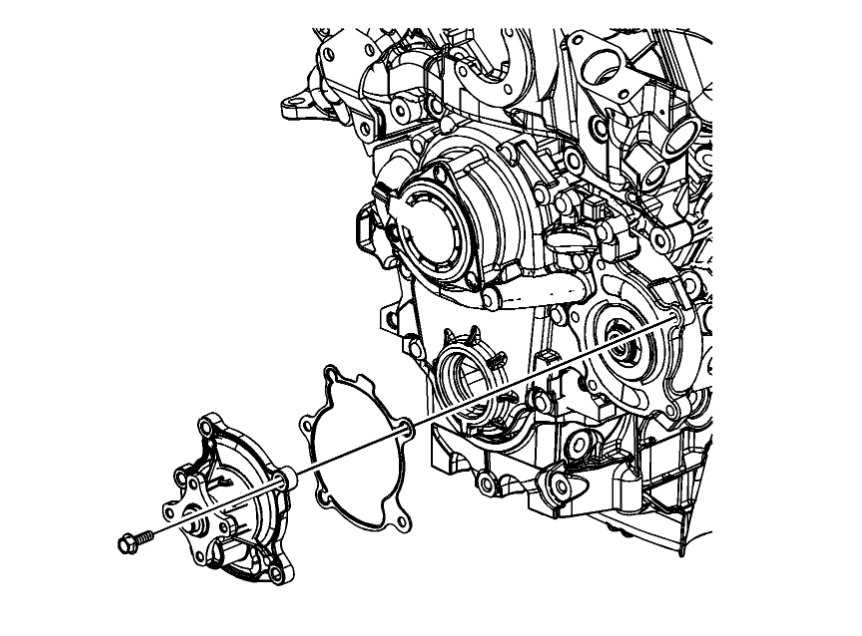

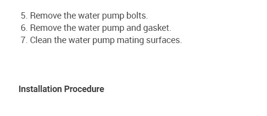

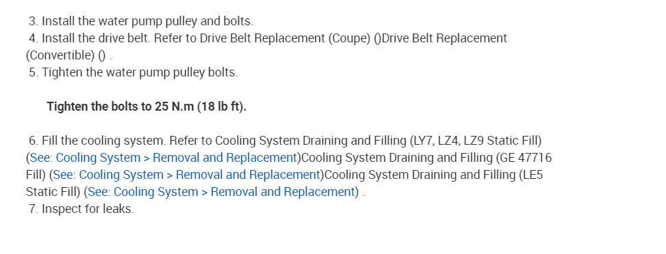

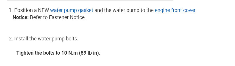

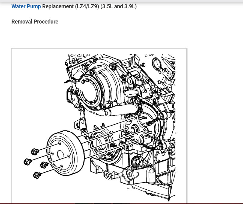

Do you have any diagrams for the water pump and surrounding area?
Nov 18, 2019 at 7:01 PM
SCGRANTURISMO
  • 4,897 POSTS
In the diagrams down below I have included the removal and installation of your vehicle's water pump from the vehicle manufacturer. These factory instruction guide comes complete with diagrams showing the location of the water pump and surrounding components. Please go through this guide and get back to us with how everything turns out.
