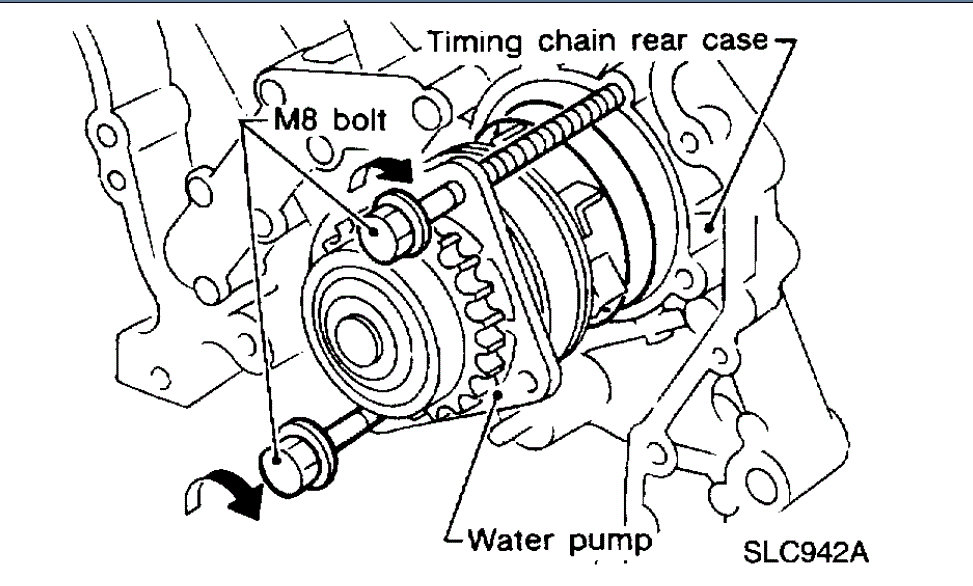

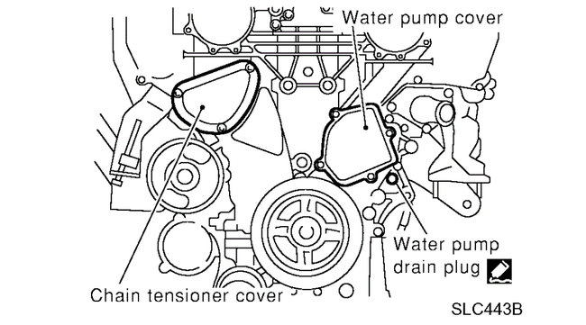

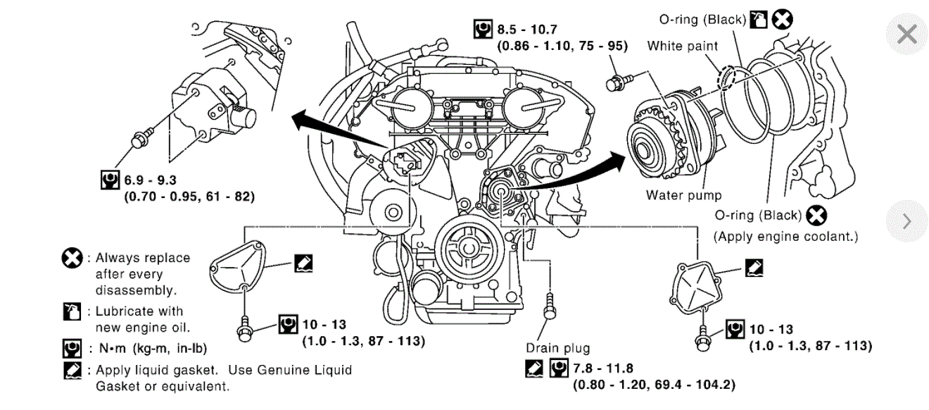

Can anyone to tell us where the water pump is in our car or a diagram of where it is located? can you please help us?
Aug 17, 2020 at 11:45 PM
Good morning,
I attached the location for you of the pump. It is driven by the timing chain in the motor. If you do this procedure, you need to be sure you do it exactly as the procedure suggests or the timing chain will be wrong and then engine will not run correctly.

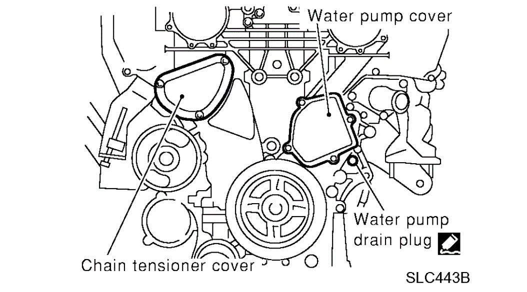

4. Remove water pump drain plug.
5. Remove chain tensioner cover and water pump cover.

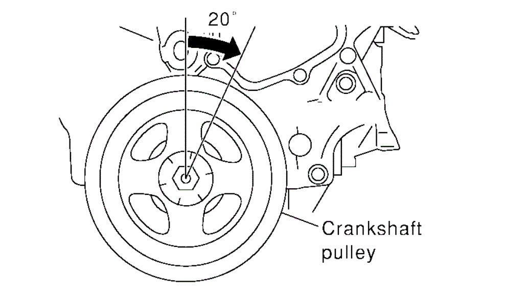

10. Turn crankshaft pulley approximately 20° clockwise so that the timing chain on the chain tensioner side is loose.

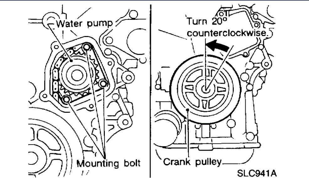

12. Loosen the 3 water pump fixing bolts. Secure a gap between water pump gear and timing chain, by turning crankshaft pulley 20° backwards.
13. Put M8 bolts [pitch: 1.25 mm (0.0492 inch) length: approximately 50 mm (1.97 inch)] to two M8-threaded holes out of 3 water pump fixing bolt holes.
