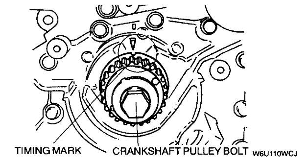

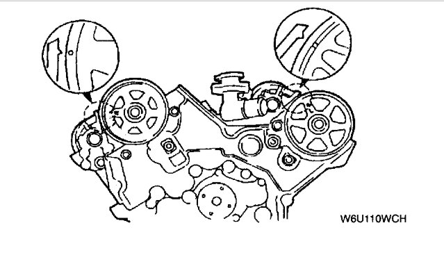

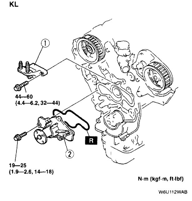

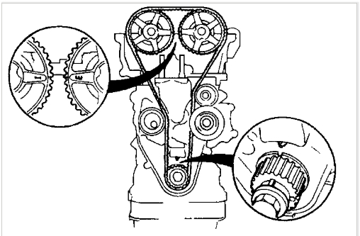

Yep, it can be frustrating the way they design things but we have to live with it. You need to remove the timing cover to get started, you might as well replace the timing belt too. Start by disconnecting the battery and draining the coolant. It is important not to install the timing belt too tight or too loose. If it is to tight it will make a whining noise while running, and too loose will make the belt fail. Here are the timing marks and the water pump replacement instructions. Check out the images (below). Let me know how it goes

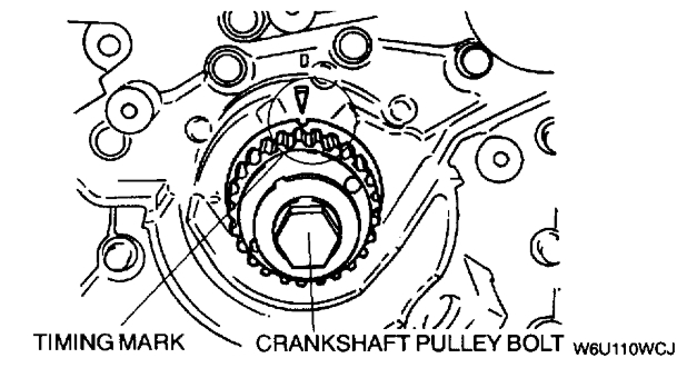

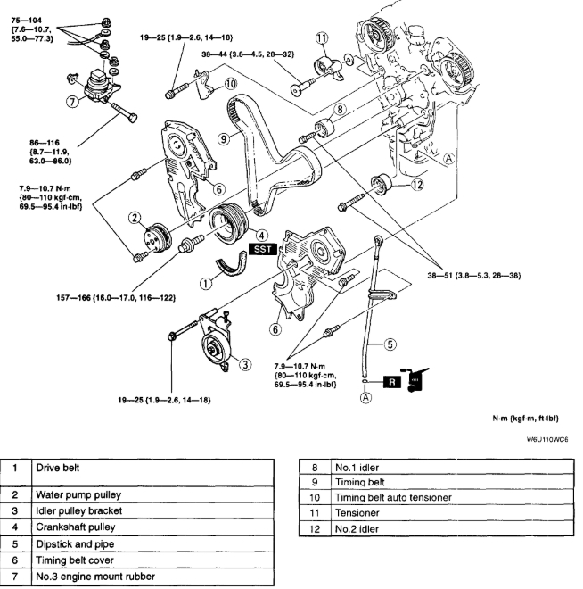

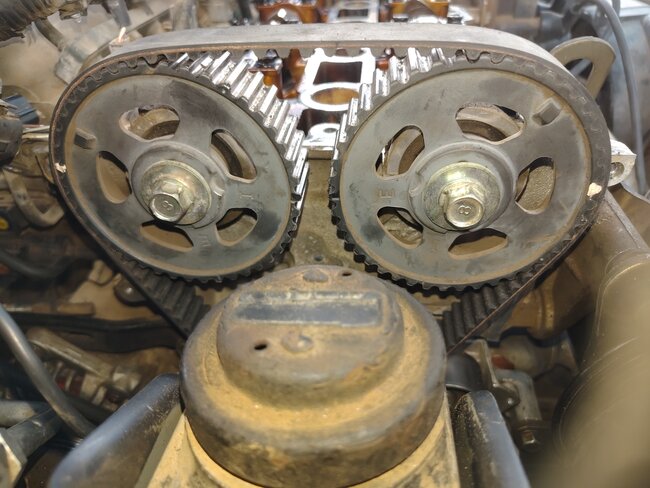

Ok as you can see in the pic my 2.0 inline 4 is deferent then the diagram you sent. And I can't find the timing marks so if you have a different diagram I could look at. Because this timing belt only has 1 idler pulley 1 auto tensioner then the harmonic balancer/crank pulley and the 2 on top

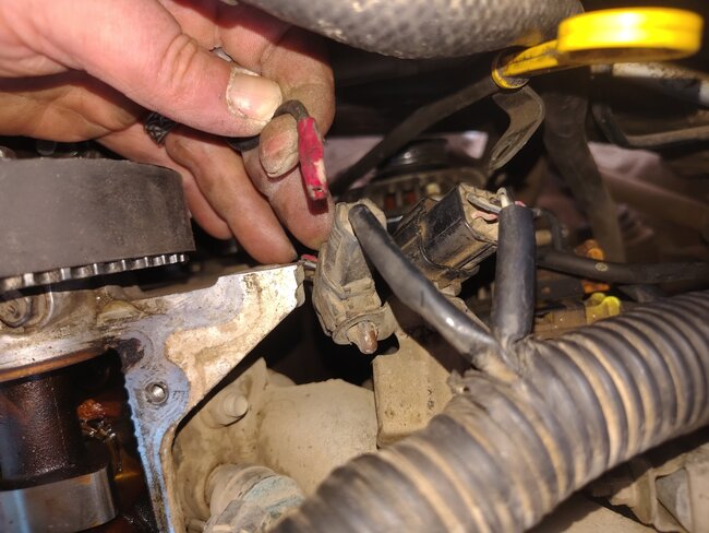

Also there are 2 plugs to the left one is a single red wire and it is not connected to anything do you know what it is by chance

The one I'm holding

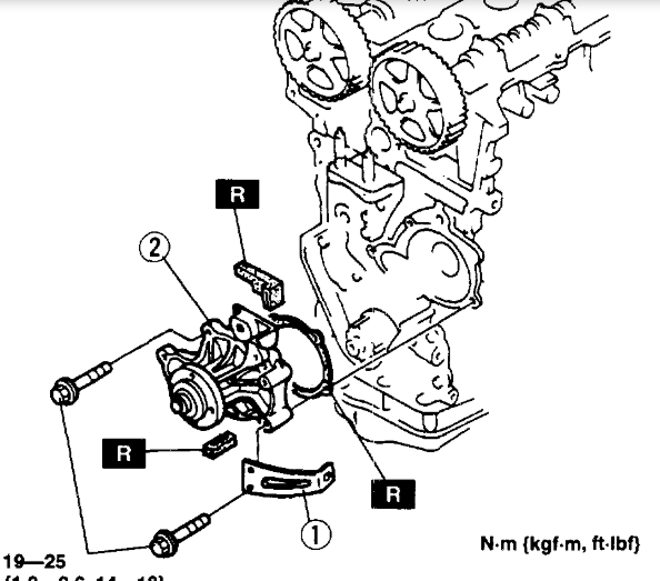

Yep, I didn't know the engine size, sorry about that. Here are the diagrams you needed. Also, I dont know what the wires go to but I would think they are from a sensor like a crankshaft sensor, but If I can see the color of the wires better I can look them up for you. Check out the images (below). Please let me know what happens.

Ok I got that together or started ran about 5 seconds then sounded like it gained a miss so she it off now it won't start. Noticed it jumped a tooth so lined it back up now it just cranks but won't fire. Pulled a plug and cranked it just to see and it's not getting any fire at all. Checked it's still in time but won't hit now. What happened? And those 2 plugs I asked about one has 4 wires it's connected the other has a single white wire going to the plug then a red wire in a black sleeve coming out the other side and it's not connected to anything.

Also that diagram I noticed "R" is a gasket on the back of the water pump but it has 2 more that I don't have anywhere? Are they absolutely necessary and if so how would I obtain them because AutoZone has no idea what I'm talking about.

Can you please upload a video of the engine cranking so I can hear it? I can tell you if the engine has compression or not. The crankshaft sensor is in the front of the engine so that can be the wiring issue you are talking about.
