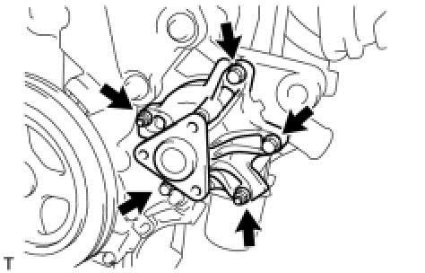

Was needing some torque specs and a how to instructions on changing water pump out.

First, here is a link that shows how in general one is replaced:
https://www.2carpros.com/articles/water-pump-replacement
Here are the directions specific to your vehicle. The attached pictures correlate with the directions.
1NZ-FE Cooling: water pump (for sedan): removal
1. Disconnect cable from negative battery terminal
2. Drain engine coolant see: coolant > removal and replacement > sedan
3. Remove engine under cover rh
4. Remove fan & generator v belt see: drive belt > removal and replacement > removal
5. Remove generator assembly see: alternator > removal and replacement > removal
6. Remove engine mounting insulator sub-assembly rh see: oil pump, engine > removal and replacement > removal

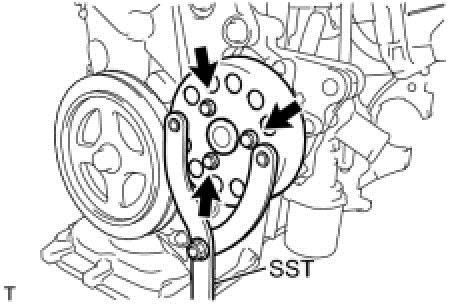

7. Remove water pump pulley
Picture 1
(a)Using SST, hold the water pump pulley.
SST : 09960-10010
09962-01000
09963-00700
(b)Remove the 3 bolts and remove the water pump pulley.
8. Remove engine water pump assembly
Picture 2
(a)remove the 3 bolts and 2 nuts and remove the engine water pump assembly and gasket.

2. Install water pump pulley
(a)provisionally install the water pump pulley with the 3 bolts.
(b)using sst, hold the engine water pump pulley.
Picture 3
sst : 09960-10010
09962-01000
09963-00700
(c)tighten the 3 bolts to the specified torque.
torque : 15 nm (153 kgf-cm, 11 ft-lbf)

The torque specs are included in the directions. Let me know if this is what you needed. If you additional information for the procedure, feel free to let me know.
