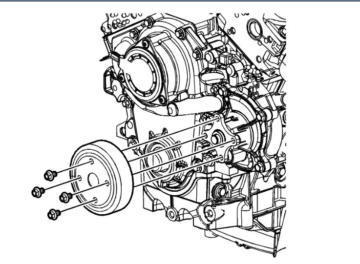

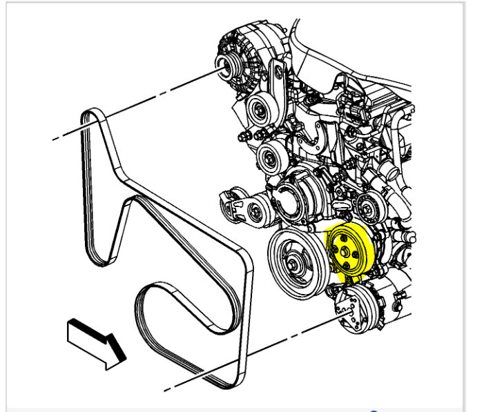

Where is the water pump located?
2009 PONTIAC G6
175,555 MILES • 3.5L • 6 CYL • AUTOMATIC
WELDERCHIC
I’m needing location of water pump.
Apr 23, 2023 at 7:19 AM
  • 110,236 POSTS
The pump is at the front of the engine. It is turned by the serpentine belt along with the other belt-driven accessories.
If you look below, I attached two pictures to help you locate it. Also, here is a link you may find helpful. It explains in general how to replace the water pump.
https://www.2carpros.com/articles/water-pump-replacement
