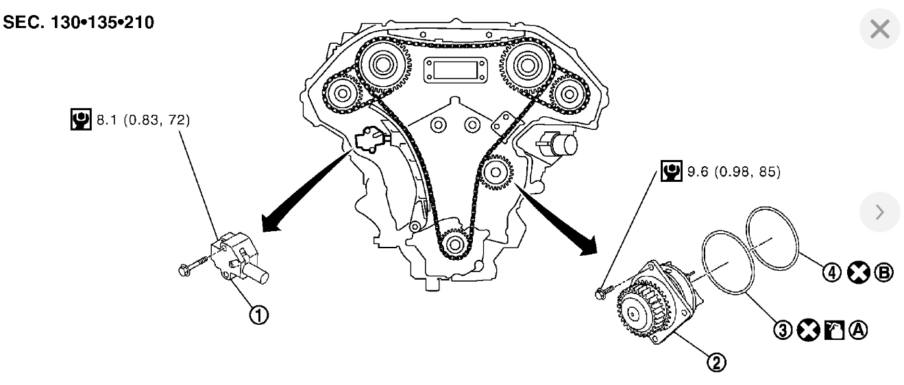

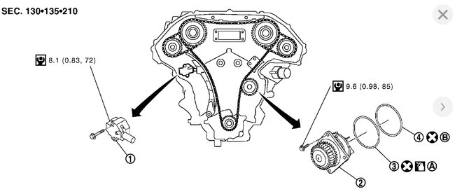

I am having a problem locating the water pump. Any help?
Aug 18, 2018 at 5:48 AM
Good afternoon.
The water pump is under the front engine cover. It is driven by the timing chain.
Will you be attempting this repair yourself?
It is a big job to perform.
