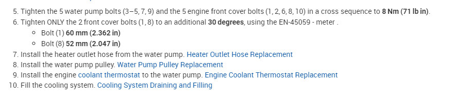

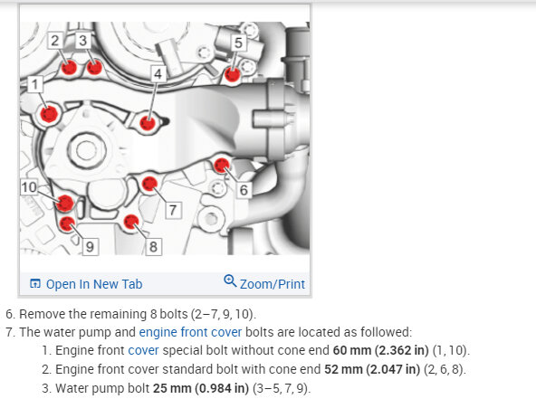

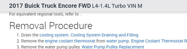

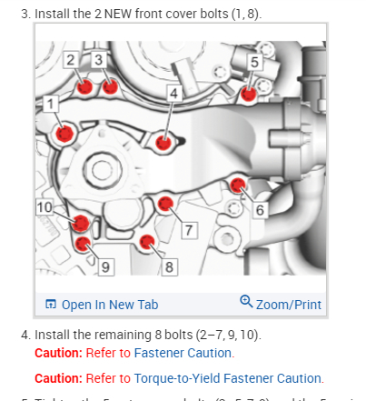

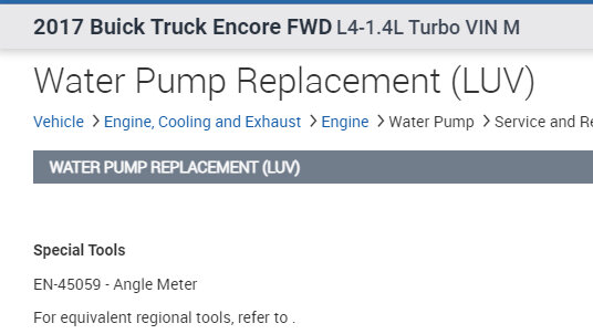

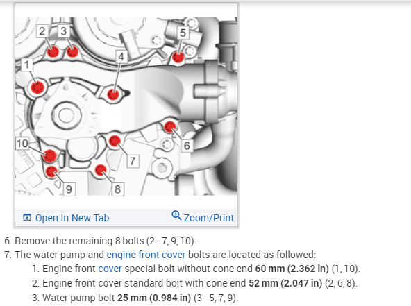

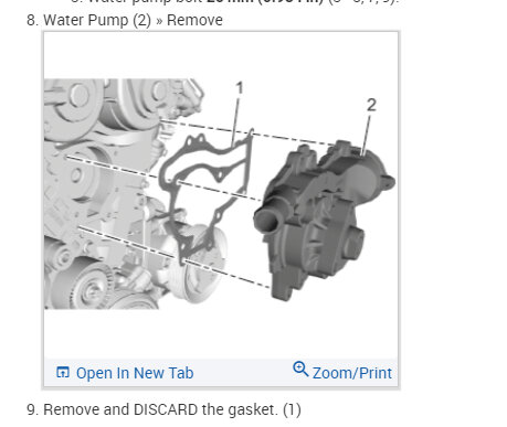

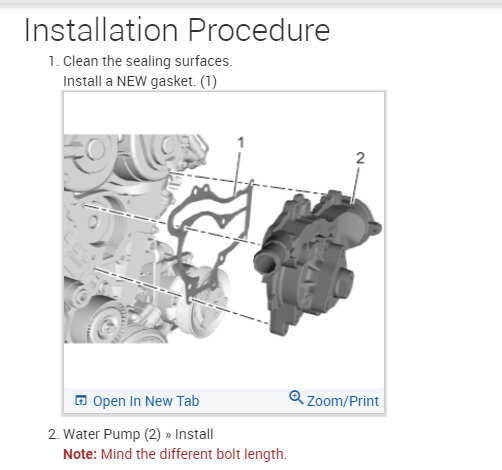

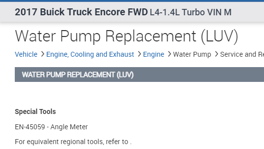

The bearing is non-serviceable. They are sealed inside the pump. When they fail, the pump needs to be replaced as a unit.
I attached the directions below for you.
