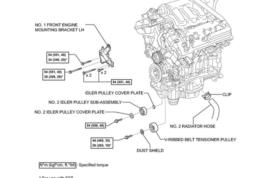

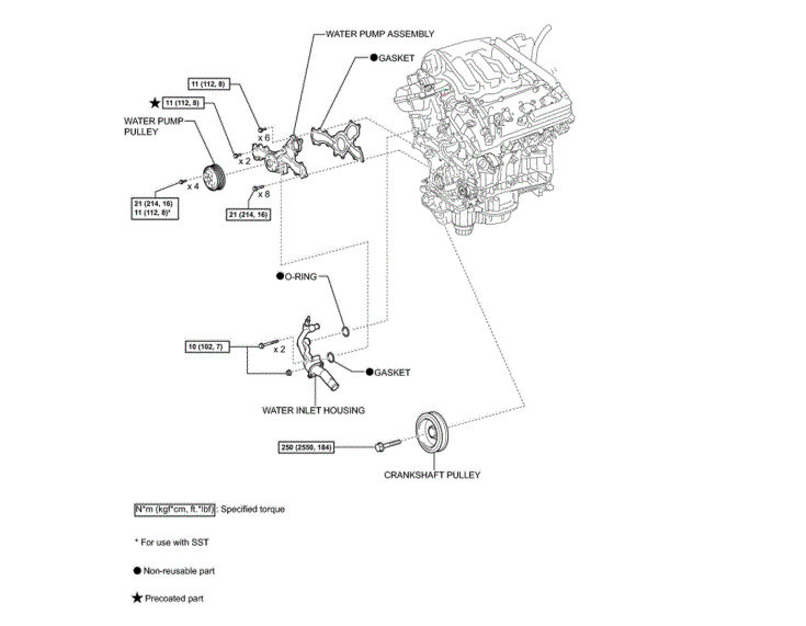

Mechanic while working on A/C suspects that water pump is moist from surface it is not leaking drops but wet from outside. so you think it is time to replace water pump now? how much would it cost?
Jul 23, 2020 at 8:23 AM
Good evening,
Yes, I would replace it.
The time is 6 hours and the parts are about $150.00.
https://www.2carpros.com/articles/water-pump-replacement
https://www.2carpros.com/articles/how-a-timing-belt-works
That equates to about $700.00 to $900.00 depending on your area.
