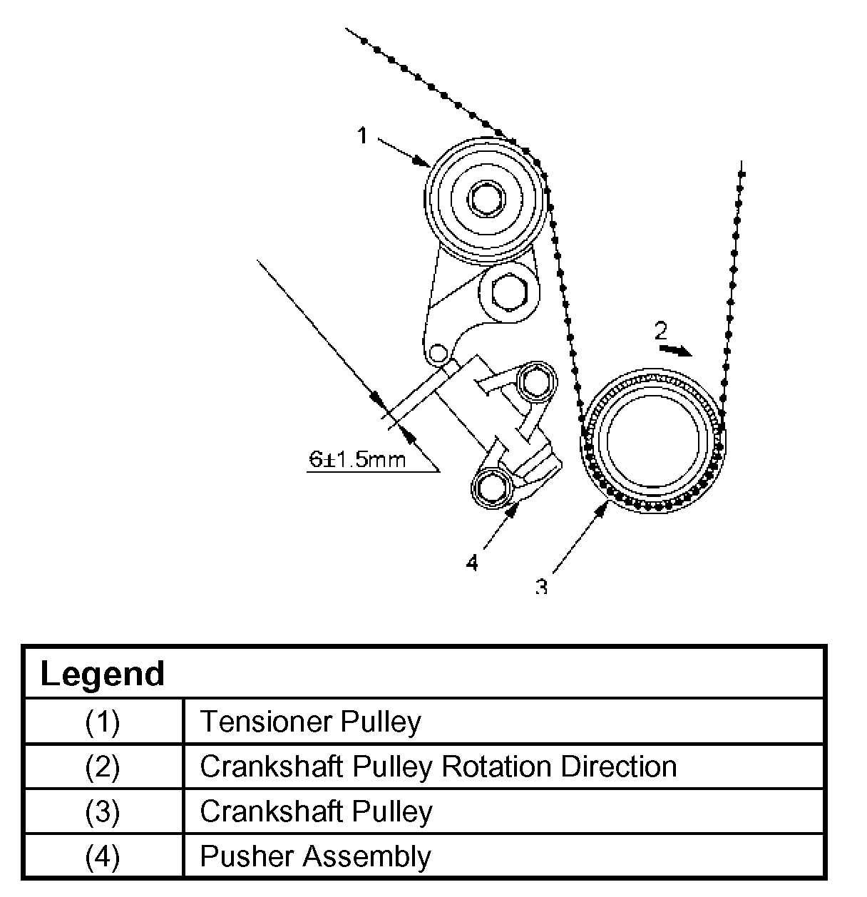

3. Remove radiator upper fan shroud from radiator.
picture 1

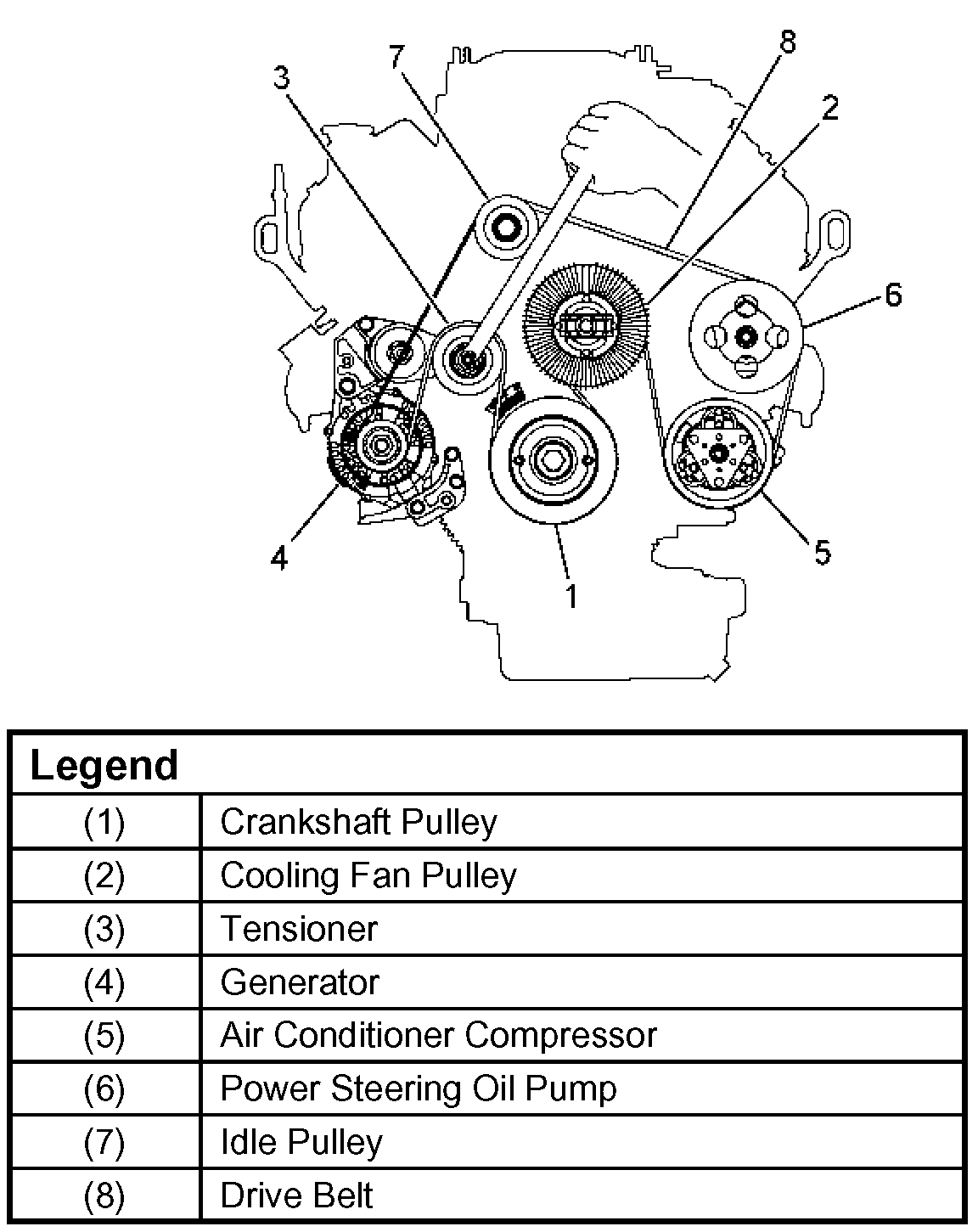

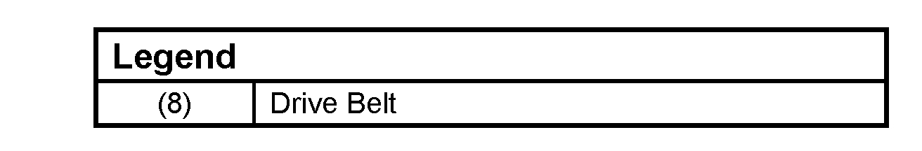

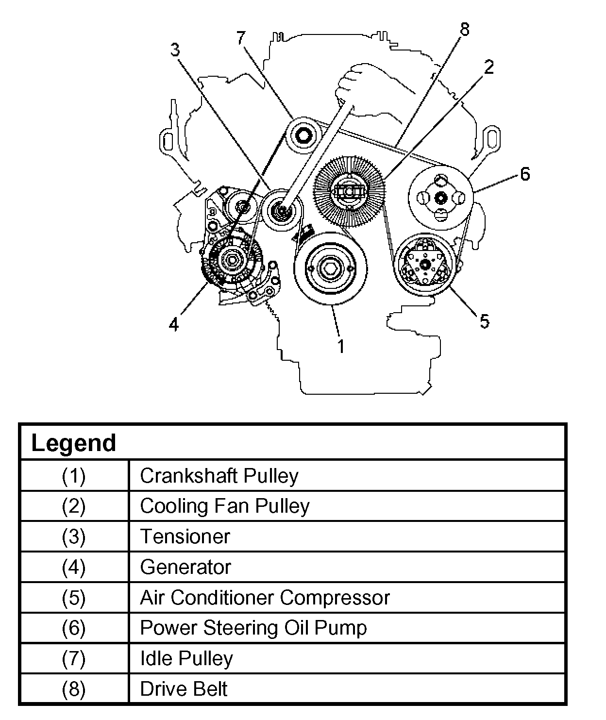

4. Move drive belt tensioner to loose side using wrench then remove drive belt.
5. Remove cooling fan assembly four nuts, then the cooling fan assembly.
6. Remove cooling fan drive pulley assembly.
7. Remove idle pulley assembly.
8. Remove serpentine belt tensioner assembly.
9. Remove crankshaft pulley assembly using J-8614-01 crankshaft holder, hold crankshaft pulley remove center bolt, then the pulley.

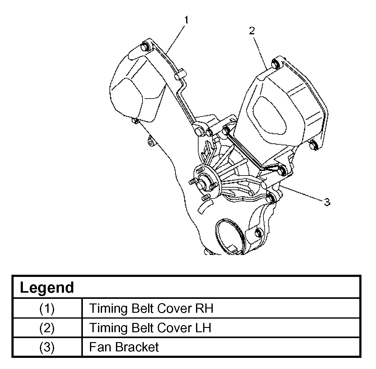

11. Remove right side timing belt cover and left side timing belt cover.

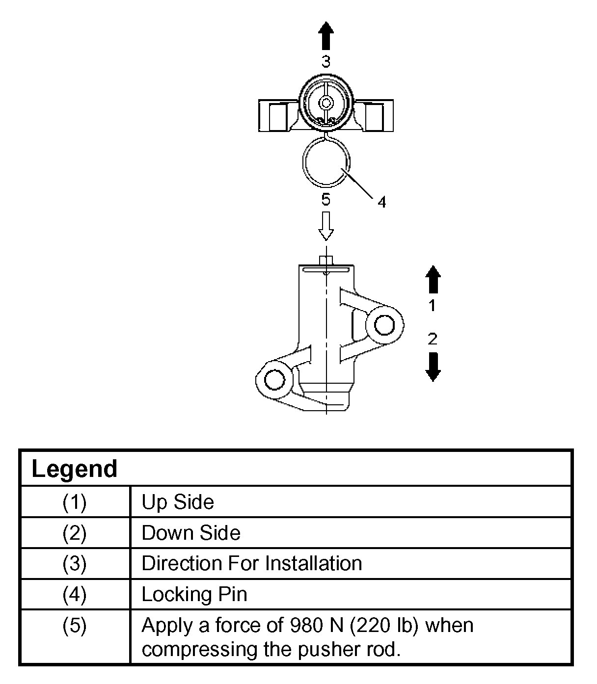

12. Remove fan bracket.
picture 2

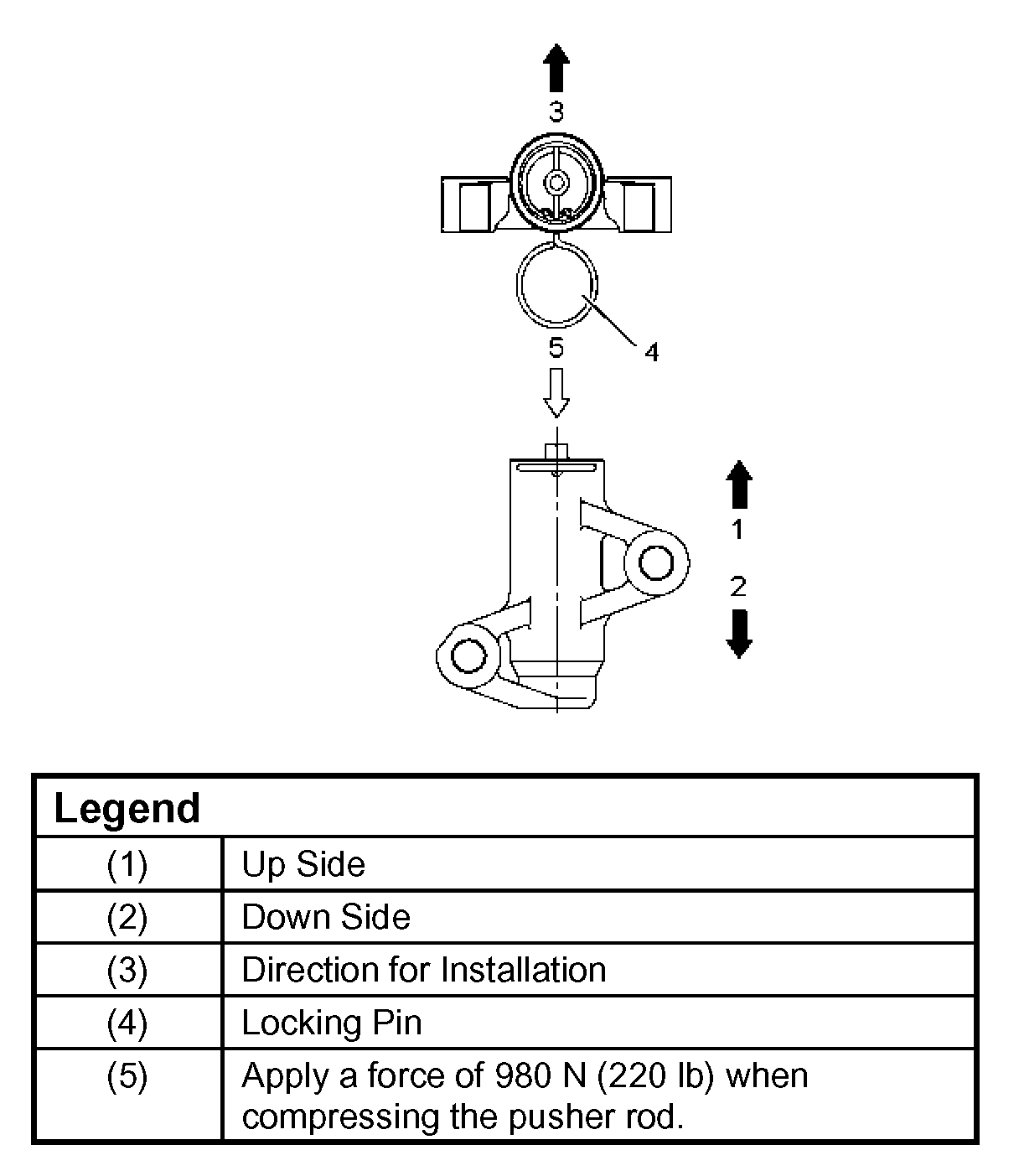

13. Remove pusher.
CAUTION: The pusher prevents air from entering the oil chamber. Its rod must always be facing upward.

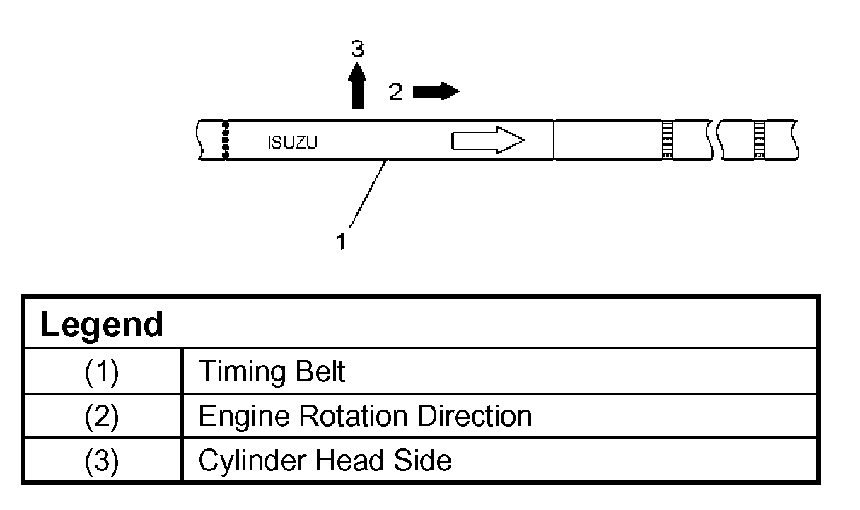

14. Remove timing belt.
CAUTION:
1. Do not bend or twist the belt, otherwise its core could be damaged. The belt should not be bent at a radius less than 30 mm (1.2 inch).
2. Do not allow oil or other chemical substances to come in contact with the belt. They will shorten the life.
3. Do not attempt to pry or stretch the belt with a screw driver or any other tool during installation.
4. Store timing belt in a cool and dark place. Never expose the belt direct sunlight or heat.

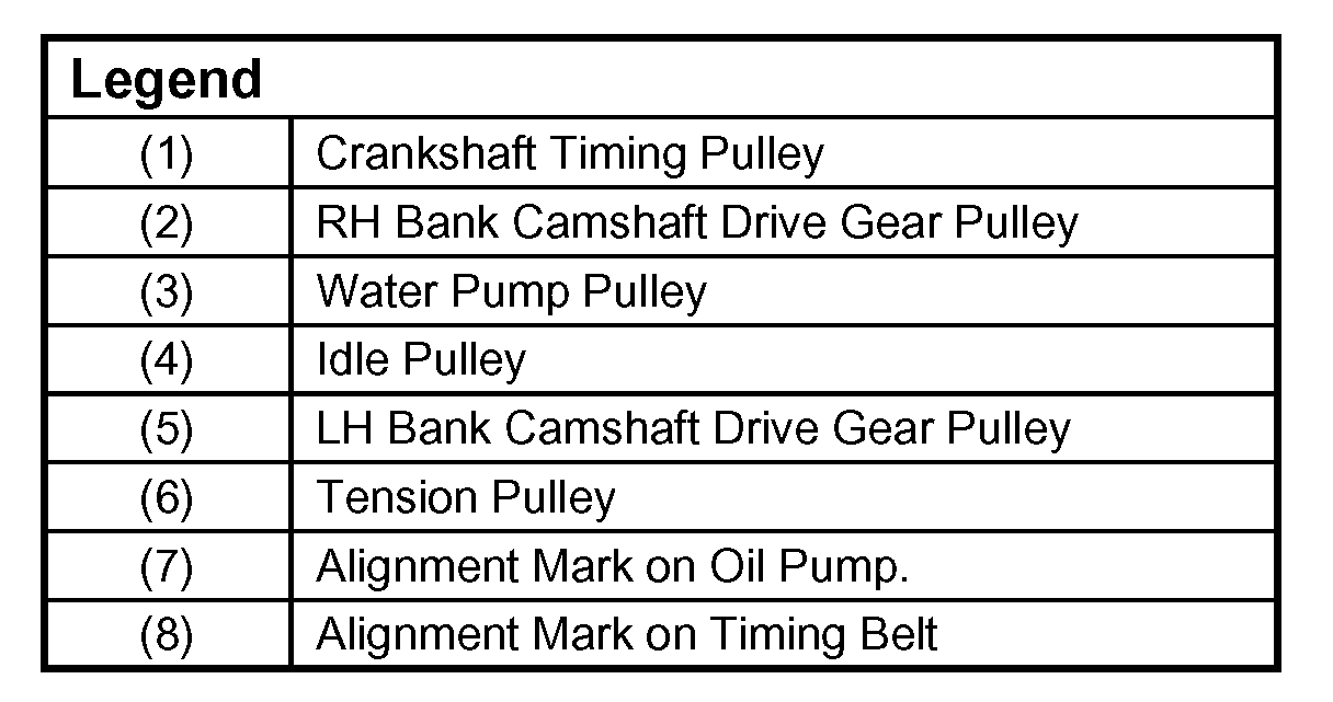

Installation
picture 3
picture 4
picture 5

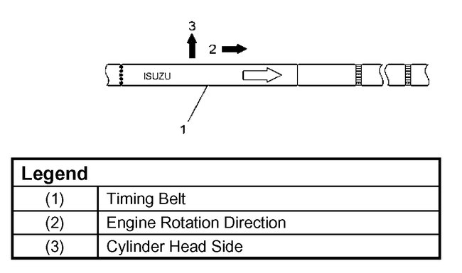

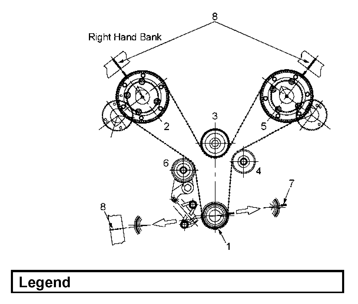

Note: For correct belt installation, the letter on the belt must be able to be read as viewed from the front of the vehicle.

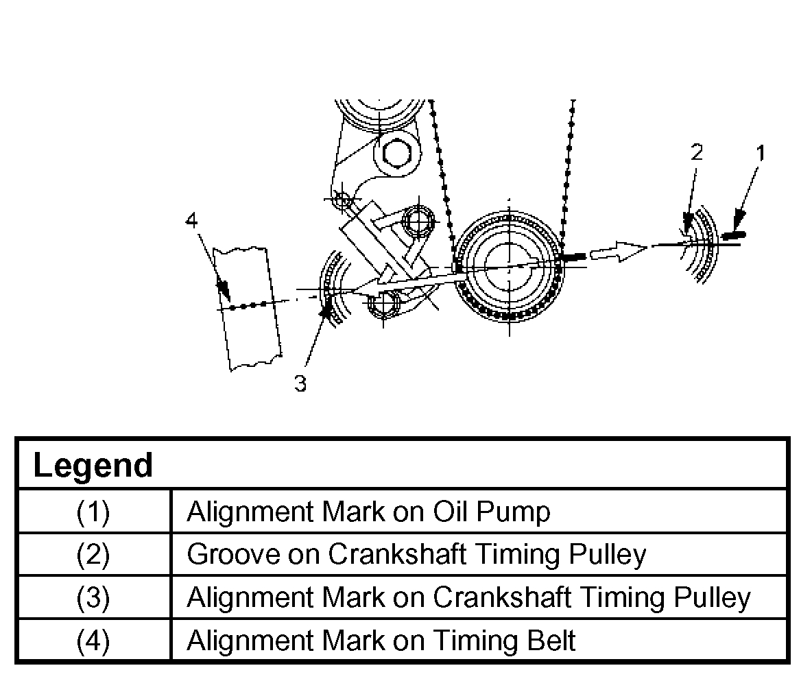

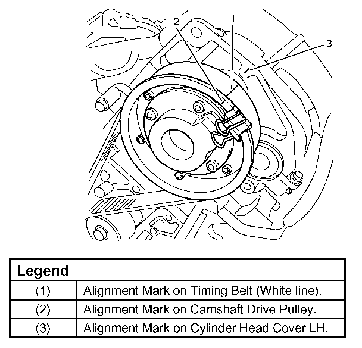

1. Install timing belt.
picture 6
1. Align groove of crankshaft timing pulley (2) with mark on oil pump (1).
Align the mark on the crankshaft timing pulley (3) with alignment mark (white dotted line) on the timing belt (4).
Secure the belt with a double clip or equivalent clip.
Note: When timing marks are aligned, No.2 piston will be on Top Dead Center.

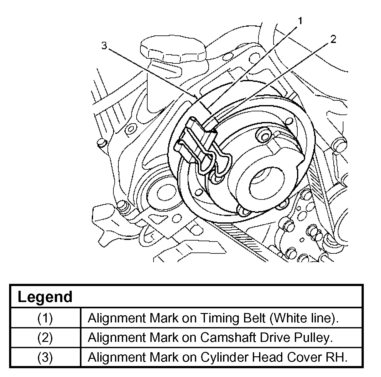

2. Align the alignment mark on the RH bank camshaft drive pulley (2) to the alignment mark of the cylinder head cover RH (3).
The camshaft pulley alignment mark should also align with alignment mark on the cylinder head cover.
picture 7
3. Align the alignment mark (white line) on the timing belt (1) with alignment mark on the RH bank camshaft drive pulley (2) (on the left side as viewed from the front of the vehicle) and put the timing belt on the camshaft drive pulley.
4. Align the alignment mark on the LH bank camshaft drive pulley (2) to the alignment mark of the cylinder head cover LH (3).
picture 8
5. Align the alignment mark (white line) on the timing belt (1) with the alignment mark on the LH bank camshaft drive pulley (2).
When aligning the timing marks, use a wrench to turn the camshaft drive pulley, then set the timing mark between timing belt and camshaft drive pulley and put the timing belt on the camshaft drive pulley.
Note: It is recommended for easy installation that the belt be secured with a double clip or equivalent clips after it is installed to each pulley.

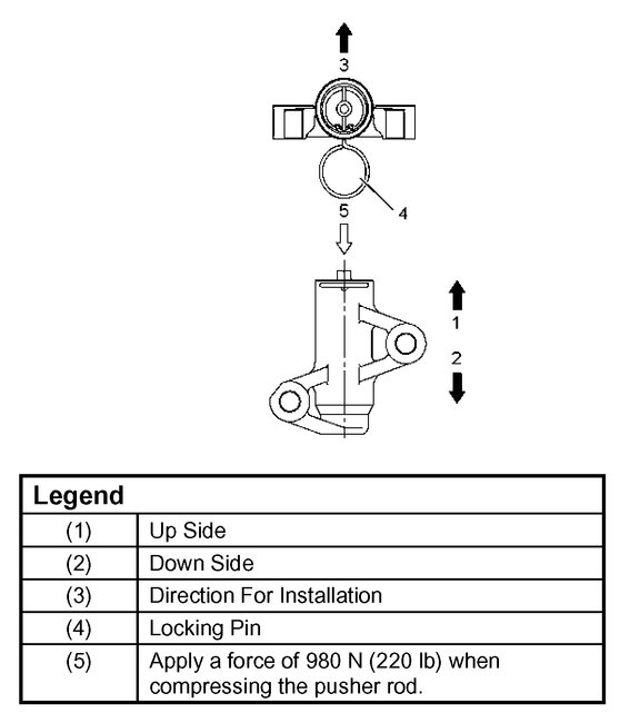

2. Install pusher and tighten bolt to the specified torque.
Torque: 25 Nm (18.4 ft. lbs.)
1. Install the pusher while pushing the tension pulley to the belt.
picture 9
2. Pull out pin from the pusher.
Note: When reusing the pusher, press the pusher with approximately 100 Kg to retract the rod, and insert a pin (1.4 mm (0.055 inch) piano wire).
picture 10
After release the push rod from the locking pin, the rod projection is approximate 6 mm (0.2362 inch).

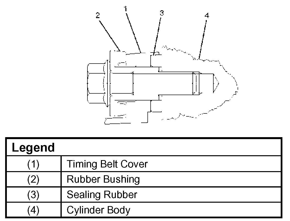

4. Install timing belt cover.
Remove crankshaft pulley that was installed in step 1 item 5.
Tighten bolts to the specified torque.
Torque: 19 Nm (14 ft. lbs.)

7. Move drive belt tensioner to loose side using wrench, then install drive belt to normal position.

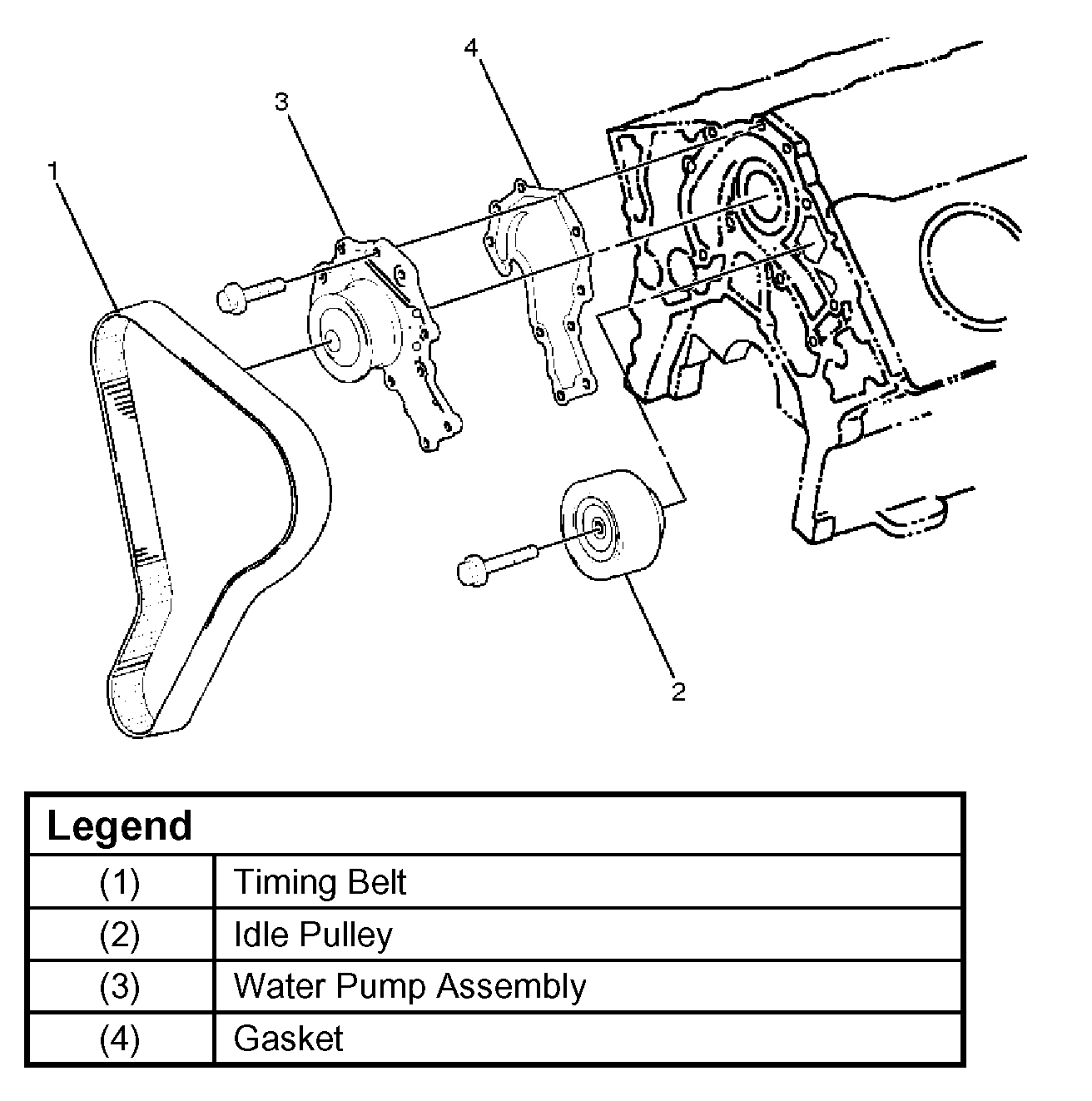

Now for the simple part. Replacing the water pump.
Water Pump
picture 15
Water Pump and Associated Parts
Removal
1. Disconnect battery ground cable.
2. Drain coolant.
3. Radiator hose (on inlet pipe side).
5. Remove idle pulley.
6. Remove water pump assembly.
7. Remove gasket.
Inspection
Make necessary repair and parts replacement if extreme wear or damage is found during inspection. Should any of the following problems occur, the entire water pump assembly must be replaced.
^ Crack in the water pump body
^ EC leakage from the seal unit
^ Play or abnormal noise in the bearing
^ Cracks or corrosion in the impeller
Installation

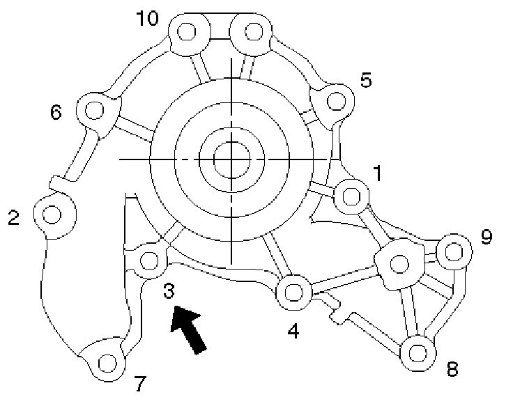

1. Install gasket, clean the mating surface of gasket before installation.
picture 16
2. Install water pump assembly and tighten bolts to the specified torque.
^ Tightening order
The tightening order are in the illustrate.
Note: To prevent the oil leakage, apply the LOCTITE 262 or an equivalent, to the arrow marked fixing bolt thread.
3. Idle pulley
^ Install idle pulley and tighten bolt to the specified torque.
Torque: 52 Nm (38.4 ft. lbs.)
4. Timing belt
^ Install timing belt.
5. Connect radiator inlet hose and replenish EC.
6. Connect battery ground cable.
