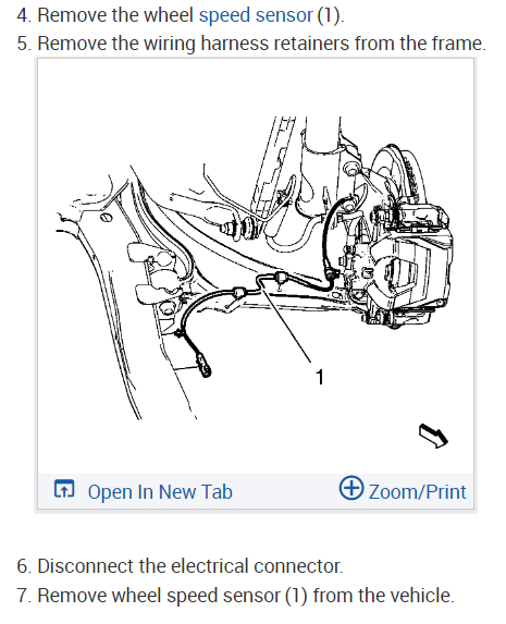

So, I got my water pump replaced and now my traction control light is on, engine light, and it says to service stability on the dashboard. As I was driving it seemed to jump and make a sound and there is oil in a lot of places but when I checked my oil it was full.
Sep 18, 2024 at 1:18 AM
  • 55,433 POSTS

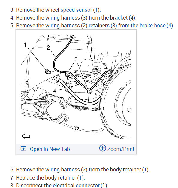

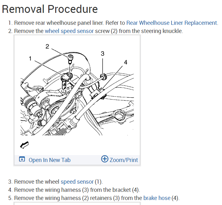

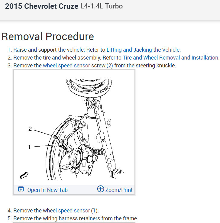

They must have damaged the wiring to the ABS system when the car was on the rack, I would use a flashlight to see if any of the wheel speed sensors have the wires torn out.
Here is a guide to help you raise the car up:
Here are the locations of the wheel speed sensors. If they look okay let's run the codes to see which ones are stored:
https://www.2carpros.com/articles/anti-lock-system-testing-and-repair-abs
Please go over these guides and get back to us. Check out the images (below). Please upload pictures or videos in your response of any problems so we can see what to help you with.
