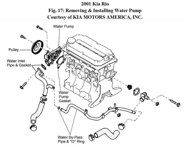

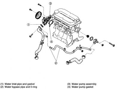

This is a 1.6l, not a 3.6l and here are the instructions as well as a diagram.
Caution: Do not disassemble water pump assembly. If a problem is found, replace assembly as a unit.
1.Disconnect negative battery cable.
2.Remove drive belt.
3.Remove timing belt.
4.Remove power steering pump in order to remove water inlet pipe.
5.Remove components in the order shown in illustration. See Figure.
6.Installation procedure is reverse of removal.

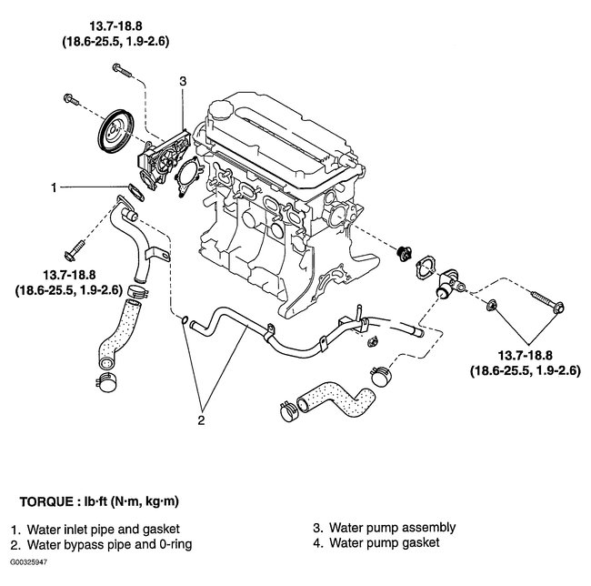

Replacing timing belt and also water pump. I need the torque specs for the pump it self.
Jul 16, 2020 at 11:21 AM (Merged)
BLUELIGHTNIN6
  • 16,542 POSTS
Water pump bolts torque to 14 - 19 Ft. Lbs. (19 - 26Nm)
Water pump pulley bolts torque to 9 - 13 Ft. Lbs. (12 - 17Nm)

Removal Caution Do not disassemble water pump assembly. If a problem is found, replaced assembly as a unit. 1.Disconnect negative battery cable. 2.Remove drive belt. 3.Remove timing belt. 4.Remove power steering pump in order to remove water inlet pipe.
https://images.2carpros.com/forum/automotive_pictures/12900_w_2.jpg
5.Remove components in the order shown. https://www.2carpros.com/kpages/auto_repair_manuals_alldata.htm

Ony standard procedures that requires timing belt removal.
WATER PUMP
Removal
Disconnect negative battery cable. Drain coolant. Remove accessory drive belt. Remove timing belt. Remove power steering pump. See
Fig. 17 . Remove water inlet pipe and gasket. Disconnect water bypass pipe and "O" ring. Remove water pump drive pulley. Remove water pump bolts, and remove water pump. Remove gasket and clean gasket mating surface of engine block.
Installation
Ensure all gasket mating surfaces are clean. Install water pump gasket on water pump. Install water pump. Tighten bolts to specification. To complete installation reverse removal procedure.
