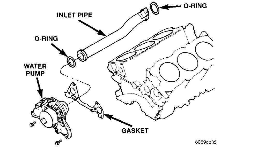

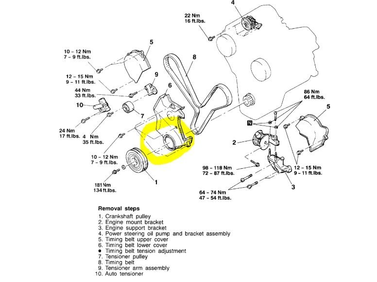

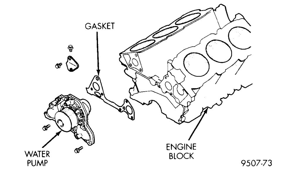

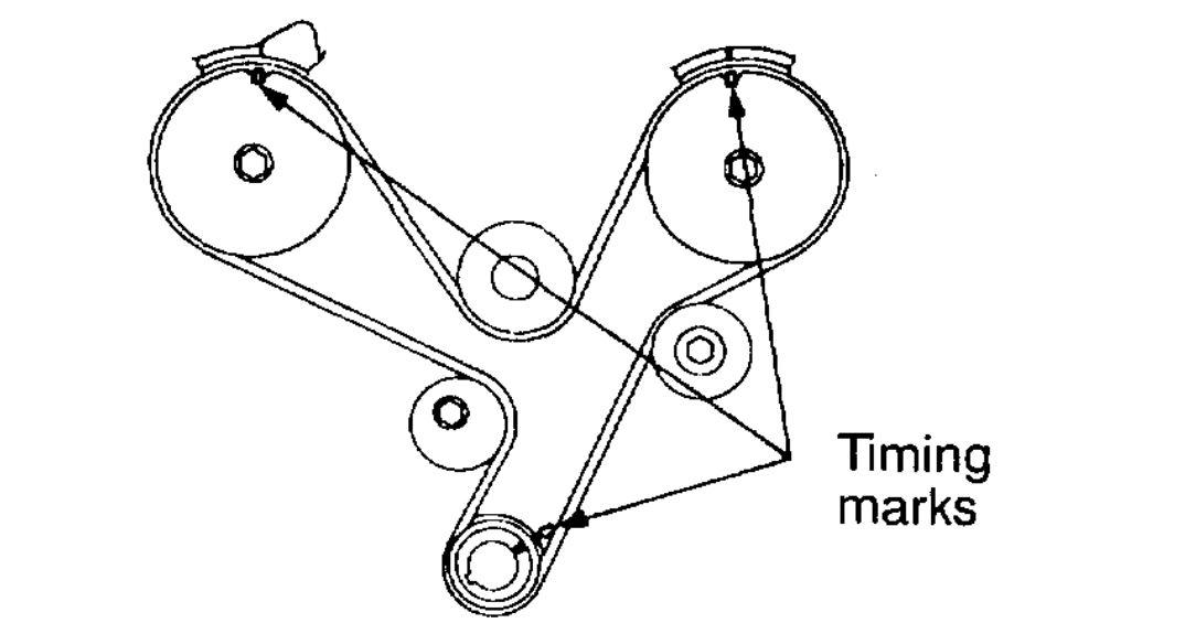

Can I replace the water pump without removing harmonic balancer? Very limited on tools and resources.
Jun 11, 2019 at 9:55 PM
Experienced Mechanic
52,796 POSTS
Good morning,
No, you cannot. The front cover has to be removed to access the pump and the cover is behind the balancer.
It would be highly recommended to replace the bet since you are at that point. You need to release the belt to remove it.
