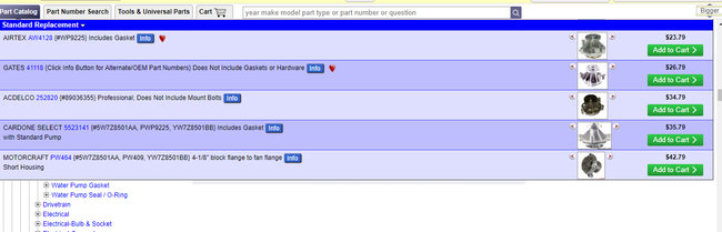

I would like to know what is the best brand water pump to install on my car.
Nov 27, 2018 at 3:30 AM
Good morning,
I attached the brands from rockauto for you to view. All the brands I listed are good as long as they are new, not re-manufactured.
Do not use the Cardone pump. That is not new.

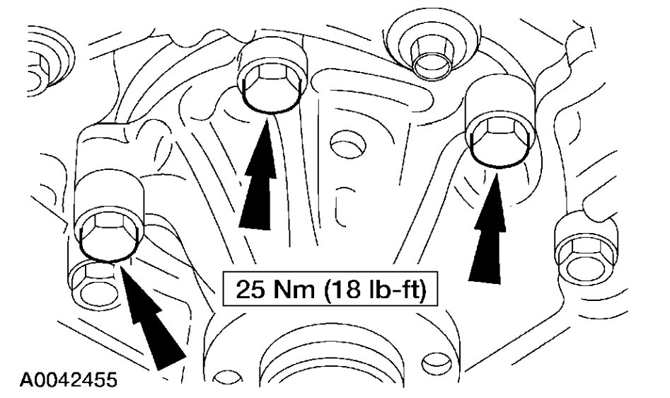

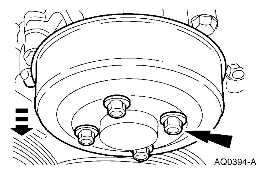

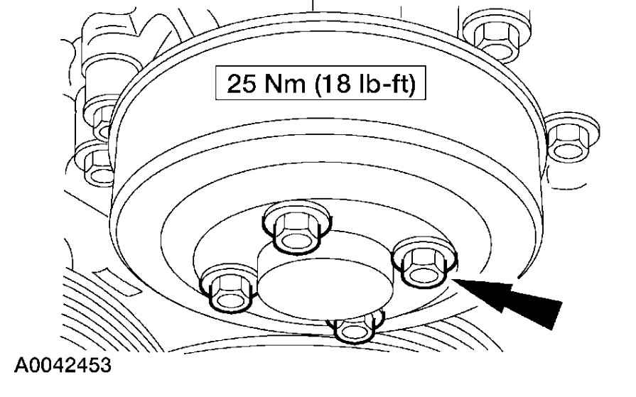

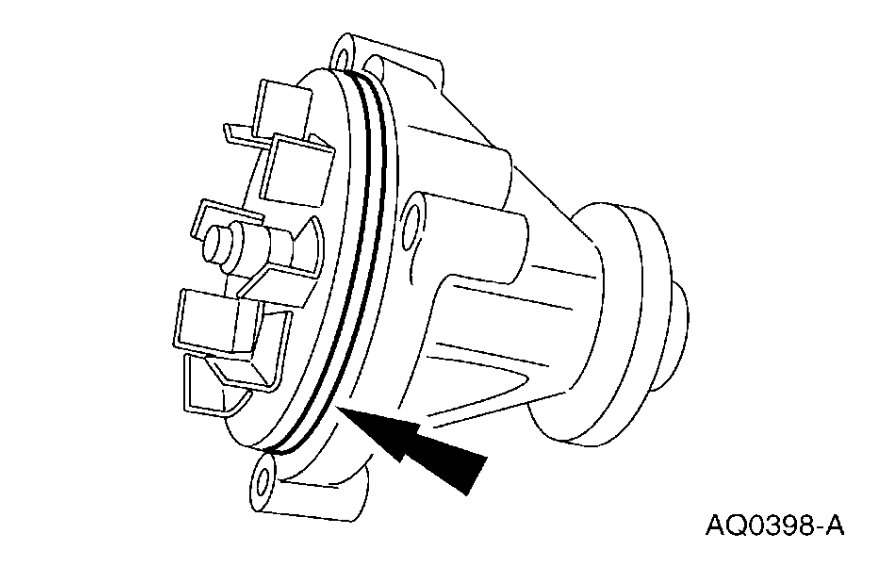

Removal and Installation
1. Drain the cooling system.
2. Loosen the coolant pump pulley bolts.
3. Remove the accessory drive belt.
4. Remove the bolts and the coolant pump pulley.
5. Remove the bolts and the coolant pump.
^ Discard the O-ring seal.
6. CAUTION: Do not rotate the coolant pump housing once installed in the engine. Damage to the O-ring seal can occur, causing the coolant pump to leak.
NOTE: Install a new O-ring seal and lubricate with the clean engine coolant.
To install, reverse the removal procedure.
7. Fill and bleed the cooling system.

I did not get the list of the brands.
Nov 27, 2018 at 5:39 AM
It is in the first attachment I sent you. I just opened it up and the pumps and brands are there.
Motorcraft would be my first choice.
Nov 27, 2018 at 5:44 AM
FLIPPA334
  • 42 POSTS
A short water pump or long?
Nov 29, 2018 at 11:43 AM
Short.

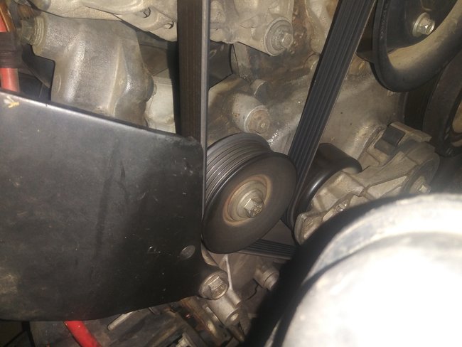

The pulley at the top on the engine is squeaking. What is the official name for that particular pulley so I can replace it?
Nov 29, 2018 at 5:22 PM
Can you post a picture of the pulley?
Nov 29, 2018 at 5:25 PM
FLIPPA334
  • 42 POSTS
This is the one I am referring to.
Nov 29, 2018 at 5:38 PM
That is called an idler pulley.
Nov 29, 2018 at 5:59 PM
FLIPPA334
  • 42 POSTS
Is it the drive belt idler pulley?
Nov 29, 2018 at 6:02 PM
Yes it is.
