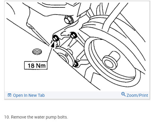

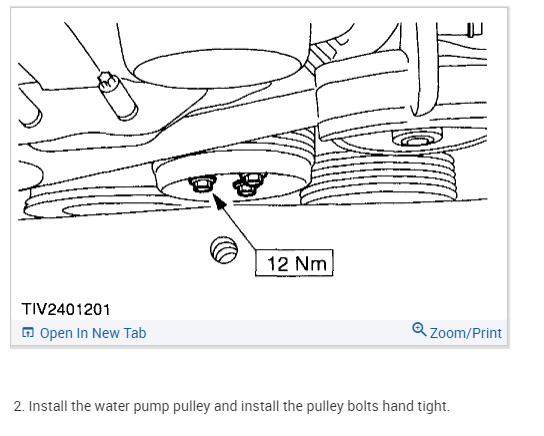

Where is the water pump located and how to change water pump?
Sep 15, 2023 at 1:29 PM
  • 110,194 POSTS

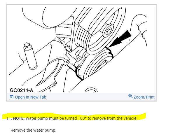

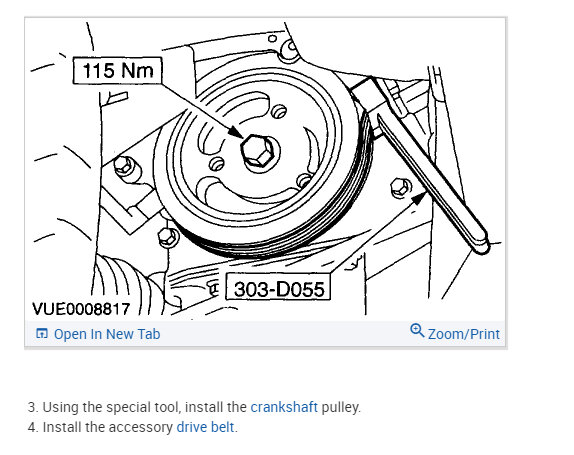

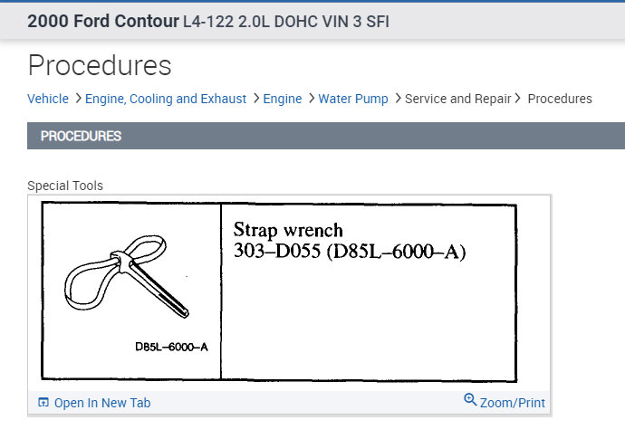

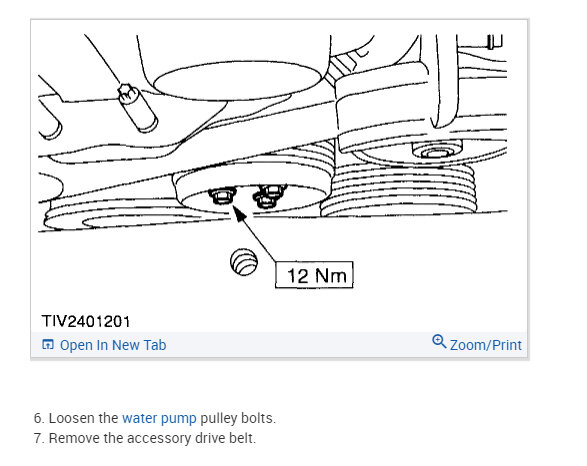

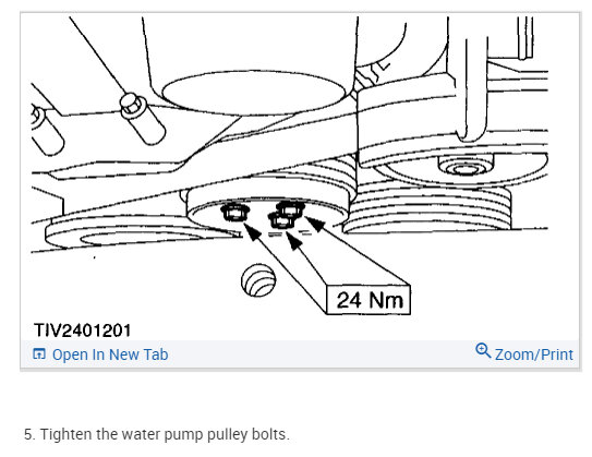

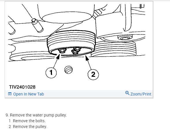

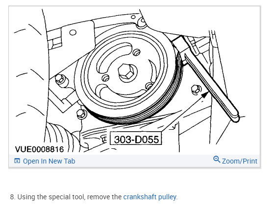

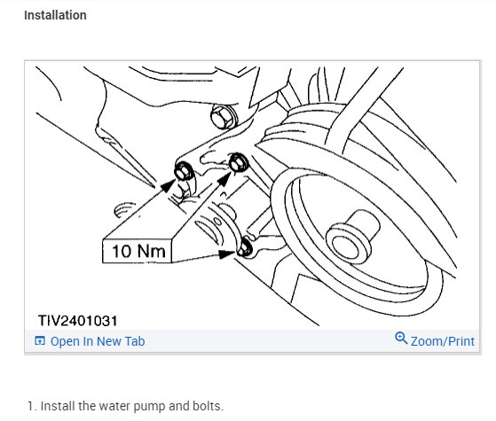

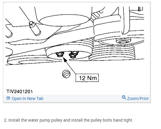

The water pump is located right above the crankshaft pulley and is driven by the serpentine belt.

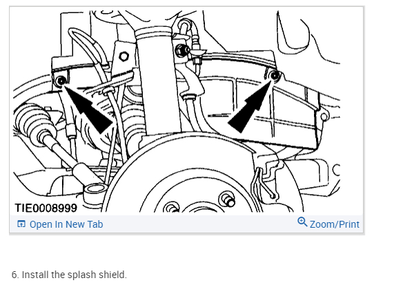

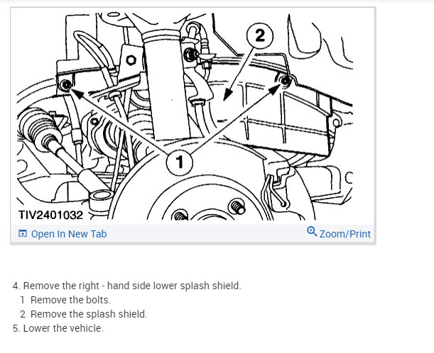

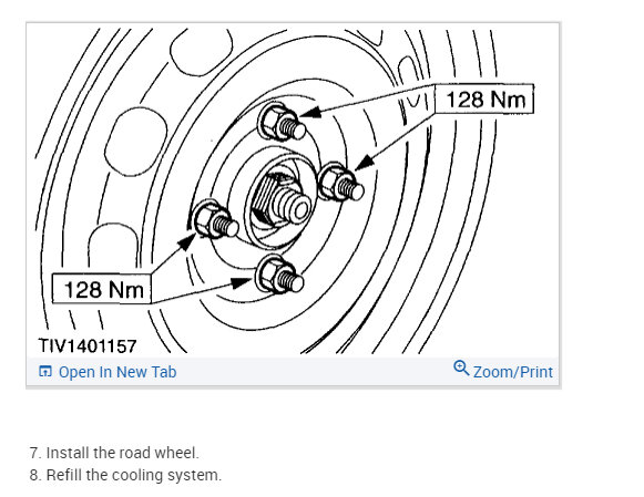

I attached the directions below for replacing it. This one is a little bit of a pain. LOL Not that it is hard to remove, but there is little room to work. You will need to remove the passenger-side front tire, so make sure the vehicle is safely supported.
Also, you will need to remove the splash shield from the vehicle. See directions. Once those things are done, the crankshaft pulley will need to be removed to make room to access and remove the pump from the vehicle.
If you look below, I attached the directions specific to this vehicle. Take a look through them and let me know if it helps or if you have questions.
