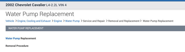

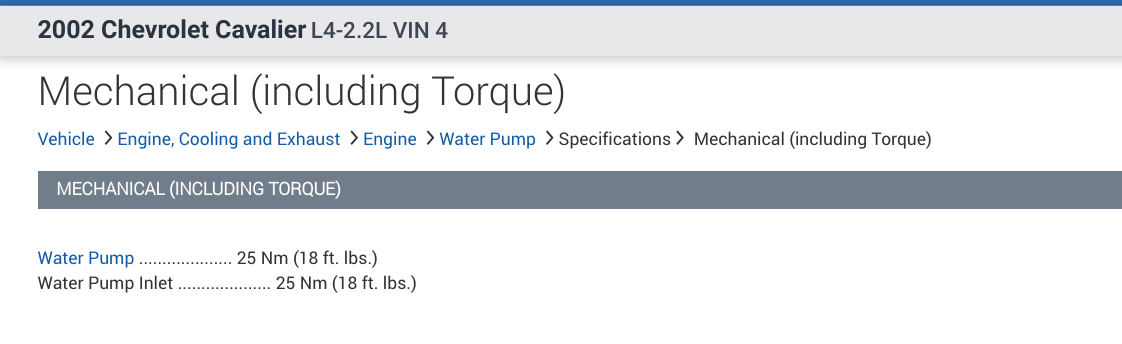

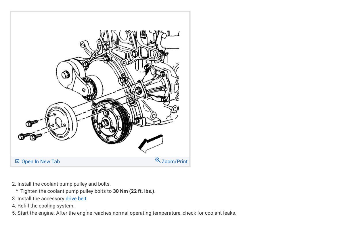

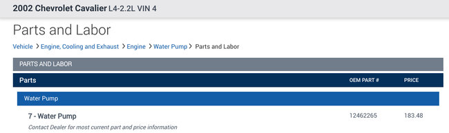

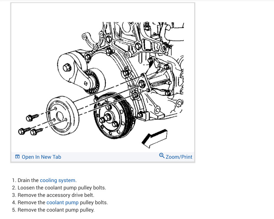

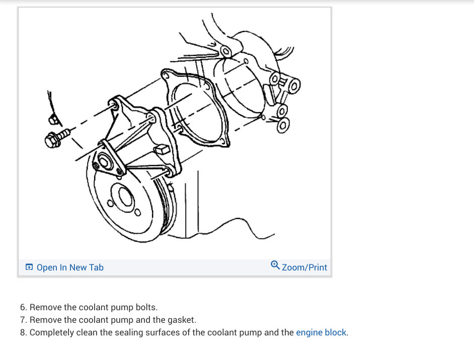

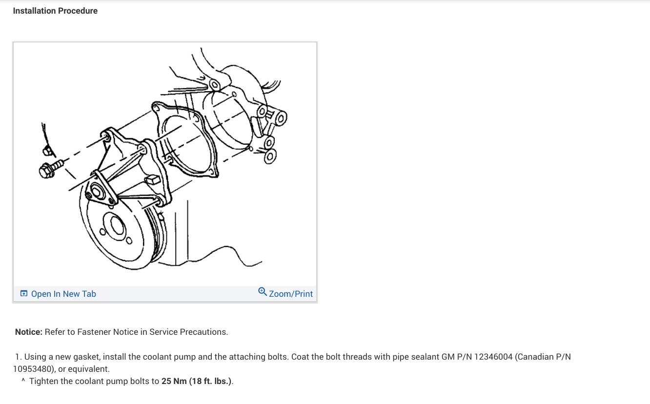

Need a diagram of the water pump.
Dec 28, 2019 at 4:59 PM
SCGRANTURISMO
  • 4,897 POSTS

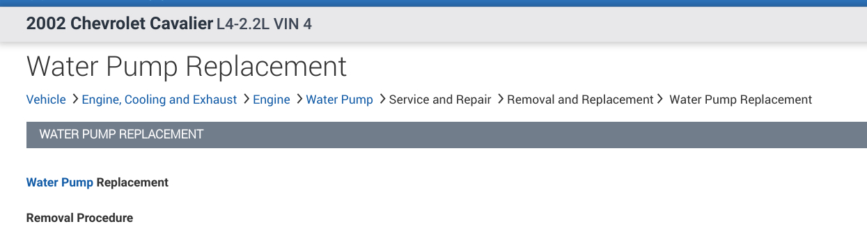

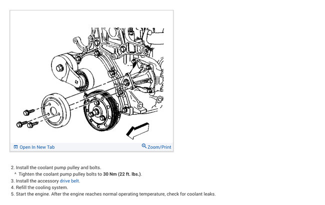

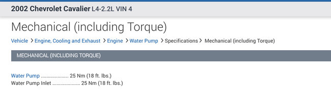

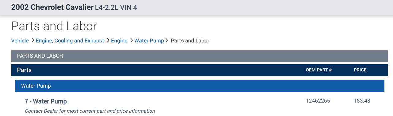

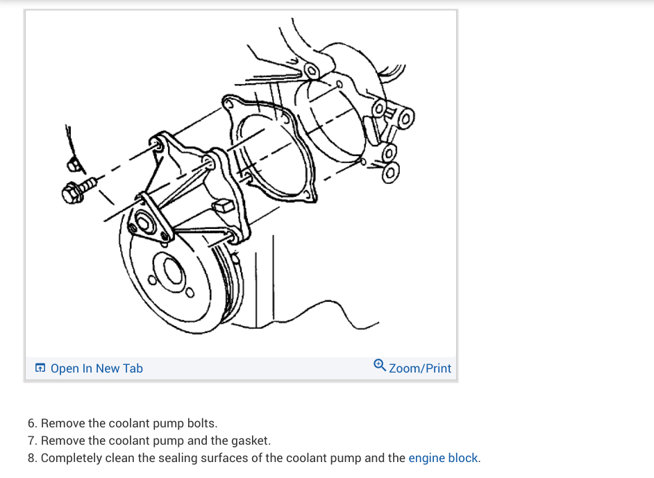

In the diagrams down below I have included the Original Equipment Manufacturer[OEM] part number, for reference, and the instructions for the removal and installation from the vehicle manufacturer for your vehicle, including diagrams. Please go through these guides and get back to us with how everything turns out. I hope this helps. Happy Holidays.
