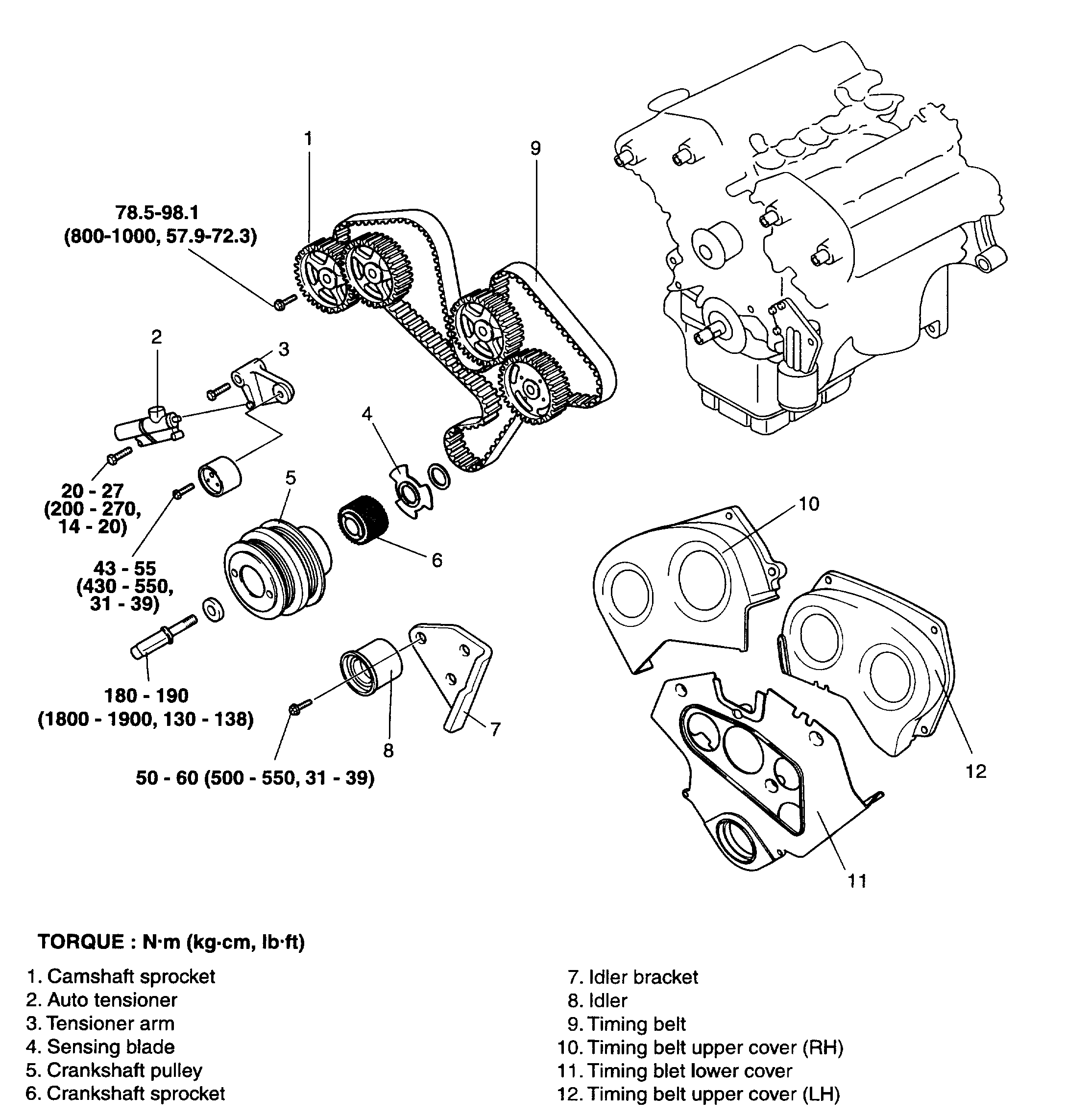

COMPONENTS
NOTE: Please refer to Campaign Bulletin: KT2007070901 regarding Crankshaft Bolt Replacement.
REMOVAL

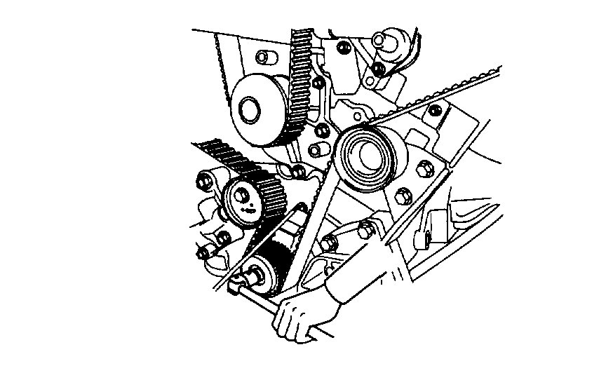

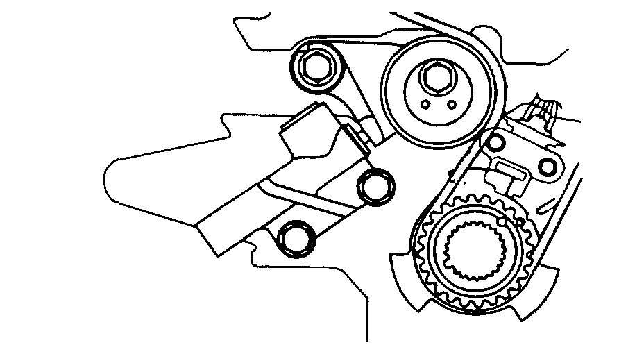

1. Using a [16 mm], rotate the tensioner arm clockwise (about 14°) and remove the belt from the pulley.
2. Remove the power steering pump pulley, idler pulley, tensioner pulley and crankshaft pulley.
3. Remove the upper and lower timing belt covers.

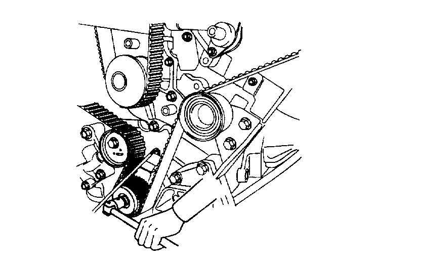

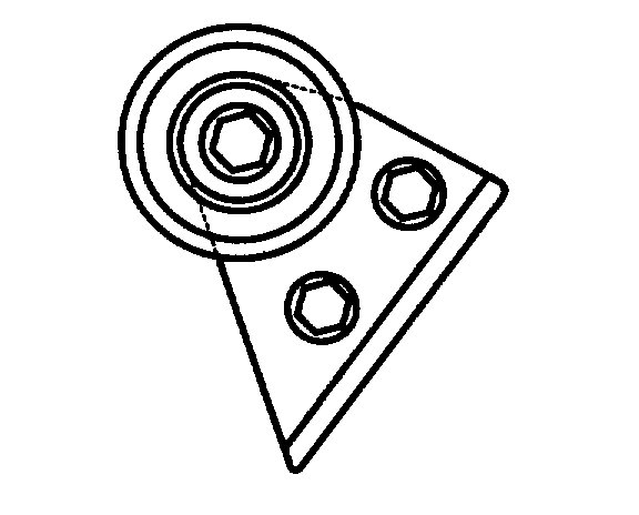

pic 2

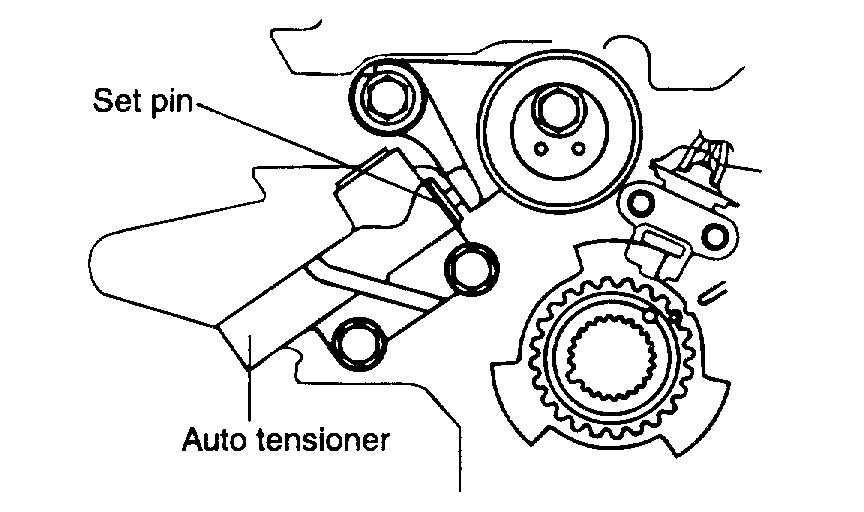

4. Remove the auto tensioner.

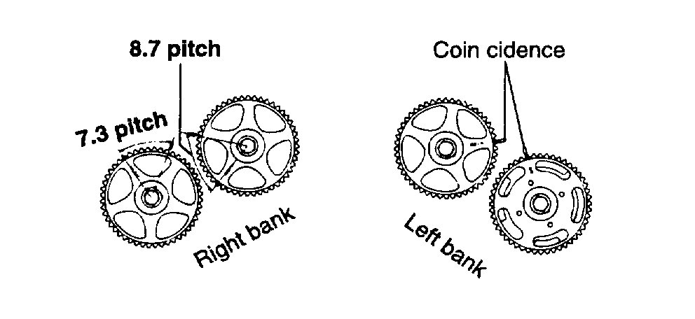

pic 3

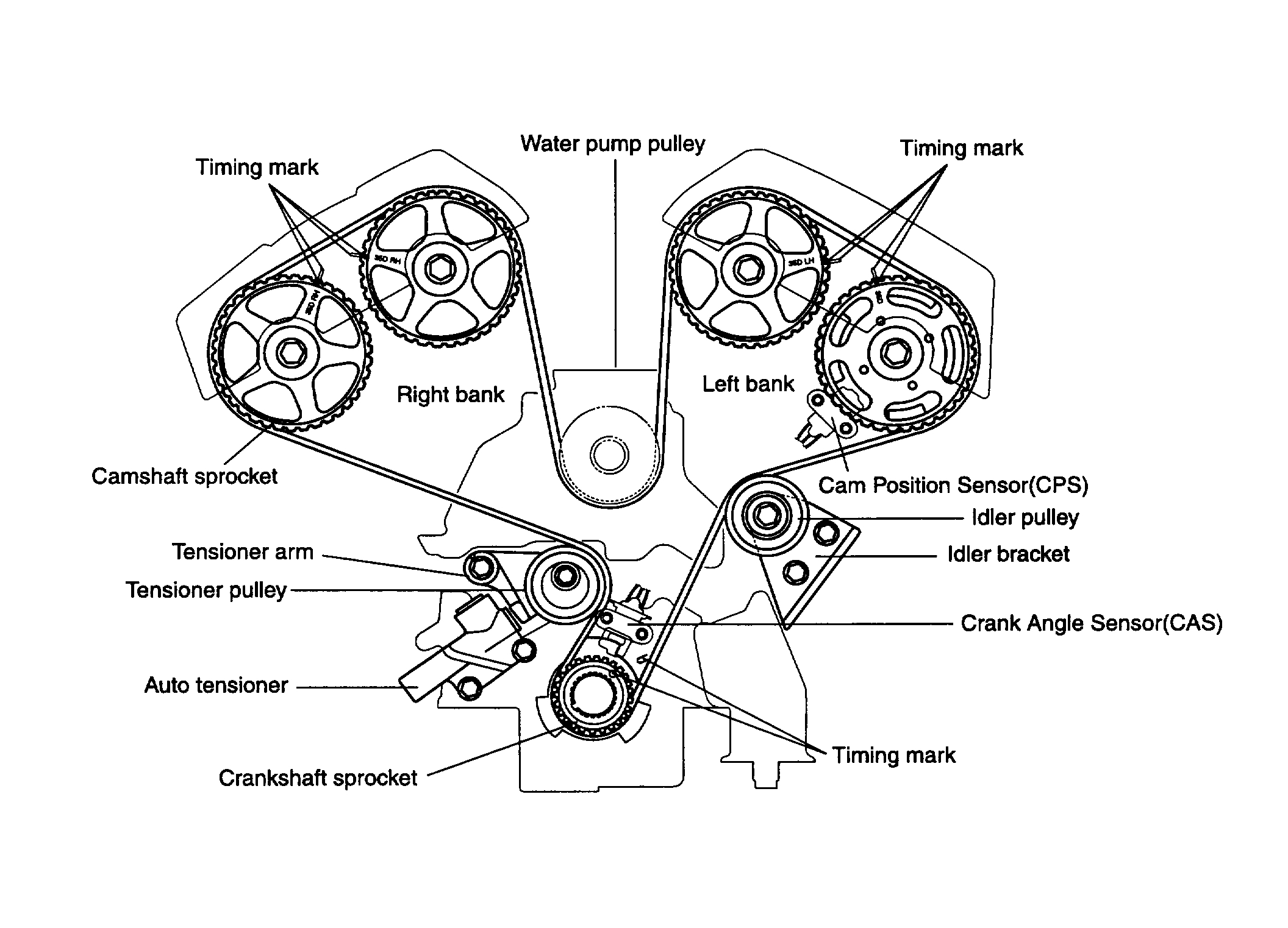

NOTE: Rotate the crankshaft clockwise and align the timing mark to set the No. 1 cylinder's piston to TDC (compression stroke). At this time, the timing marks of the camshaft sprocket and cylinder head cover should coincide with each other.
5. Unbolt the tensioner to remove the timing belt.
NOTE: If you plan to use the timing belt again, mark the rotation direction on the belt so you reinstall it correctly.

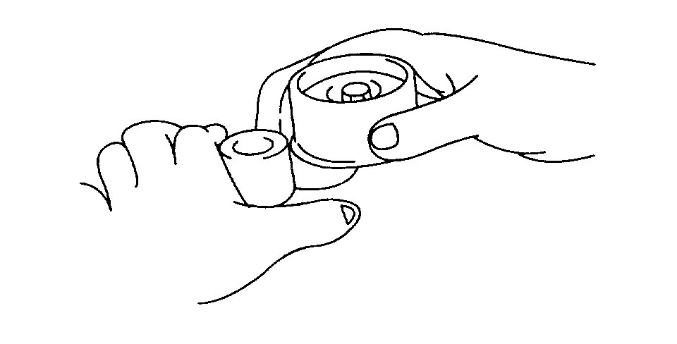

pic 4

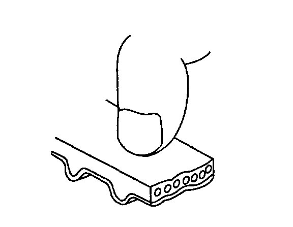

1) Hardened back surface of rubber Back surface is shiny, non-elastic and so hard that when the nail of your finger is pressed into it, no mark is produced.

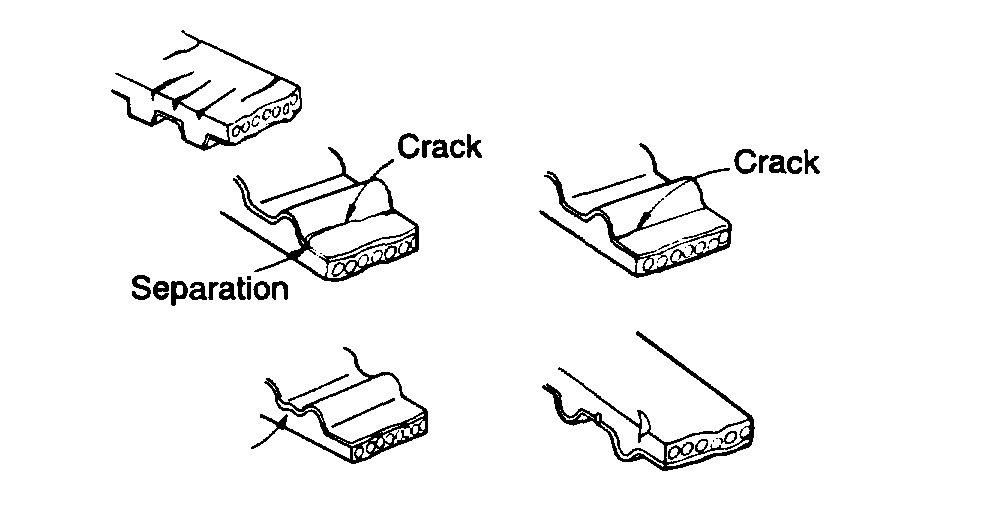

2) Cracked back surface of rubber.

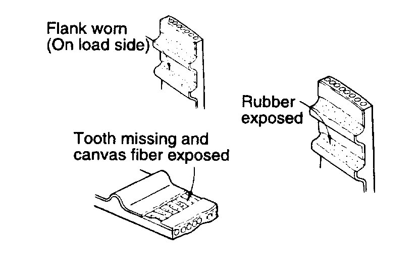

4) Teeth are badly worn out.
Initial stage: Canvas on load side of the tooth flank worn (fluffy canvas fibers, rubber gone, color changed to white, and unclear canvas texture)
Last stage: Canvas on the load side of the tooth flank worn down and rubber exposed (tooth width reduced).
pic 7
5) Missing tooth

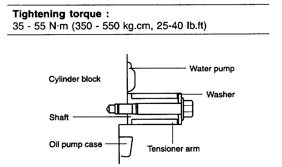

2. Install tensioner arm, shaft and plane washer to cylinder block.
Tightening torque: 35 - 55 Nm (350 - 550 kg-cm, 25 - 40 ft. lbs.)

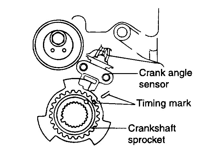

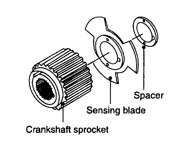

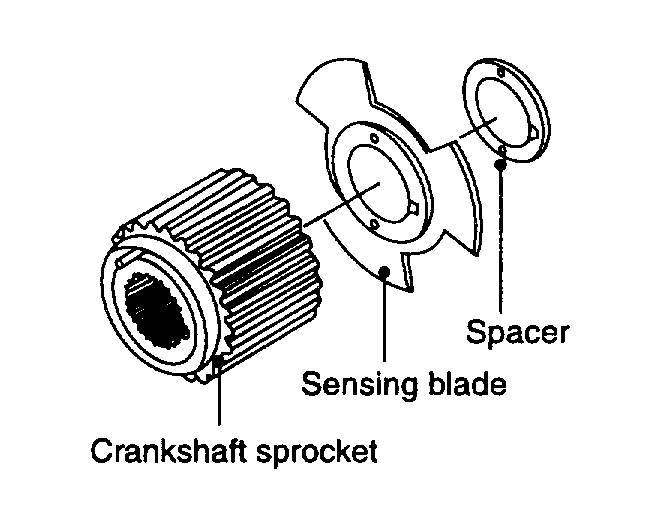

3. Install crankshaft sprocket and align the timing mark.
pic 13
CAUTION: Be careful not to bend crankshaft sensing blade.

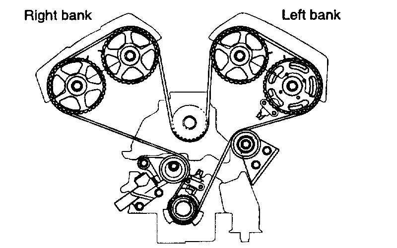

4. Install camshaft sprocket and adjust initial installation state as illustration.
pic 15

6. Align the timing marks of each sprocket and install the timing belt in this order. Crankshaft sprocket --> Idler pulley --> Exhaust camshaft sprocket (LH) --> Intake camshaft sprocket (LH) --> Water pump pulley --> Intake camshaft sprocket (RH) --> Exhaust camshaft sprocket (RH) Tensioner pulley
pic 17
NOTE:
- In this step, No. 1 is in TDC (Compression stroke)
- Do not insert fingers.
7. After installing the timing belt, reconfirm the timing mark.

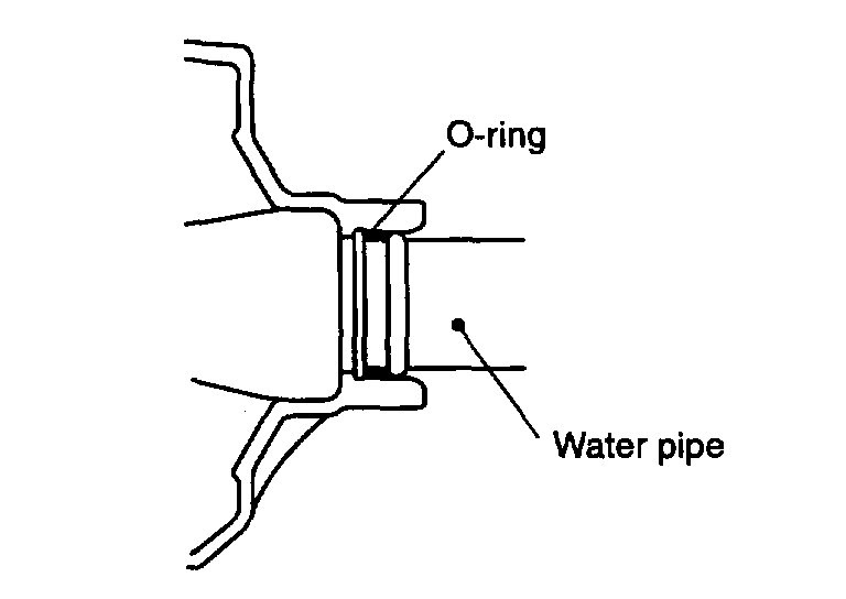

2004 Kia Truck Sorento V6-3.5L
ENGINE COOLANT PUMP
pic 18
COMPONENTS
REMOVAL

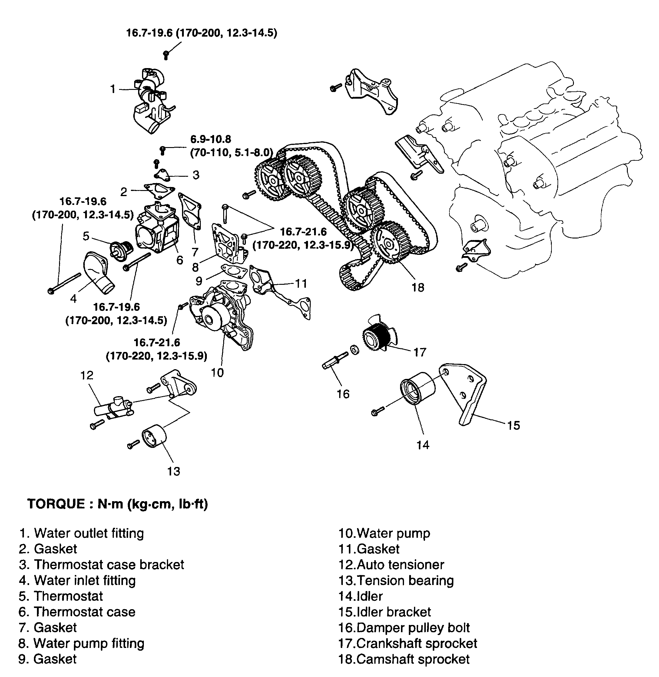

1. Using the drain plug, drain the coolant.
2. Remove the drive belt and the engine coolant pump pulley.
3. Remove the timing belt cover, the auto tensioner and idler pulley.
4. Remove the water outlet fitting, the thermostat case and the water pump fitting.
5. Remove the engine coolant pump mounting bolts.

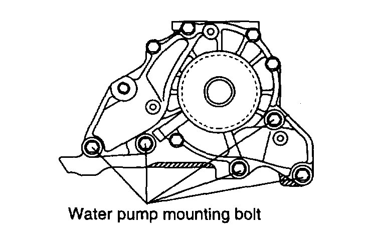

pic 19
6. Remove the engine coolant pump assembly from the cylinder block.
INSPECTION
1. Check the engine coolant pump for cracks, damage or wear, and replace the pump assembly if necessary.
2. Check the bearing for damage, abnormal noise and sluggish rotation and replace the pump assembly if necessary.
3. Check the seal it for leaks and replace the pump assembly if necessary.

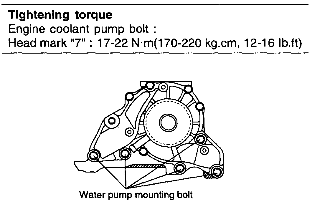

2. Install the new engine coolant pump gasket and pump assembly. Tighten the bolts to the specified torque.
Tightening torque
Engine coolant pump bolt:
Head mark "7": 17 - 22 Nm (170 - 220 kg-cm, 12 - 16 ft. lbs.)

I know most of what was said, but do you have to remove the thermostat housing to replace the complete water pump ?
Jul 5, 2019 at 11:14 PM
  • 110,240 POSTS
Welcome back:
Yes, that all needs removed.
