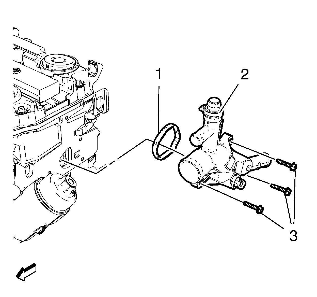

Evidently the water outlet valve housing is leaking, will stop leak sealant help?

Chances are the outlet is either cracked or the o-ring has failed. I don't feel a sealant will fix the issue. The part needs removed and inspected to determine the actual cause.
Here are the directions for replacing the part. The attached pics correlate with the directions.

7. Disconnect the engine coolant temperature sensor (water outlet) wiring harness connector.
pic 1
8. Remove the 3 water outlet bolts (3).
9. Remove the water outlet (2) and the water outlet seal ring (1).

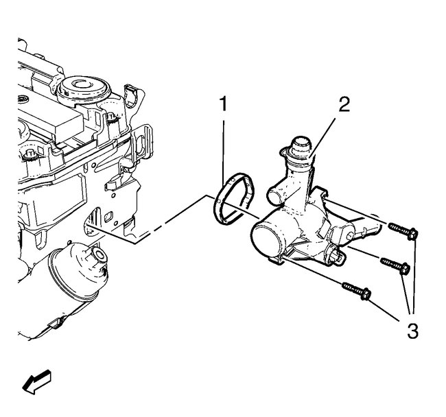

Installation Procedure
1. Clean the sealing surfaces.
pic 2
2. Install the water outlet (2) and a NEW water outlet seal ring (1).
Caution: Refer to Fastener Caution See: Vehicle > Technician Safety Information > Fastener Caution.
3. Install the 3 water outlet bolts (3) and tighten to 8 Nm (71 lb in).
