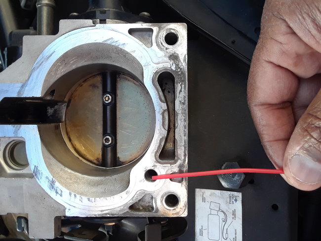

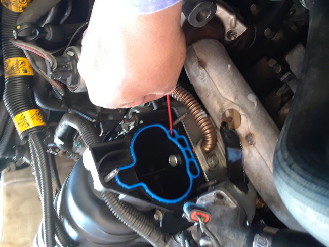

Thank you for your reply. Consider the screenshot. On the intake manifold near the EGR stovepipe there are 2 round ports through which coolant should flow. There is 1 oval port through which coolant should not flow. I understand that gases should through it. On my engine when I add water to the radiator I hear water gurgling up into the engine and flowing out the three ports near the EGR stove pipe. How can this be? This evident without the upper intake plenum attached.
May 10, 2021 at 12:03 PM
LHALL510314
  • 10 POSTS
The red straw indicate where water is flowing through. No water should flow through here, correct?
May 10, 2021 at 12:07 PM
That would indicate the lower manifold is allowing the water up that port.
May 10, 2021 at 12:08 PM
If you add air to that port from a compressor, does it go to the cooling system?
If that is for the EGR, no, it should not have water there.

When the throttle body is attached and I add water to the radiator water flows through this port and into the air snorkel.

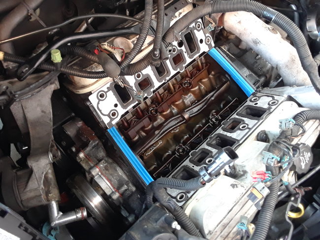

When I remove the lower intake manifold I see intake runners and water jackets on the cylinder heads. On the rear bank cylinder head I see a small port tucked up high that is not a water jacket. It seems to be a air channel. The lower intake manifold gasket makes space for it; does not block it off. Seems like if water flows through it is a tell that the head gasket is done???

Consider the rear bank cylinder head. Lower intake manifold gasket is in place. There is a round hole on the gasket between the intake runner and the water jacket. Why is there a hole there? I think water is come through that hole through the lower intake manifold through the upper intake plenum and through the throttle body. But why?
May 10, 2021 at 12:39 PM
Okay, the picture is way too small to see any of the ports you have identified.
I would remove the plugs on the rear and air up each cylinder to see if air or coolant comes up that passage. If it does, then you may and I mean may have either a head gasket or cracked head.
