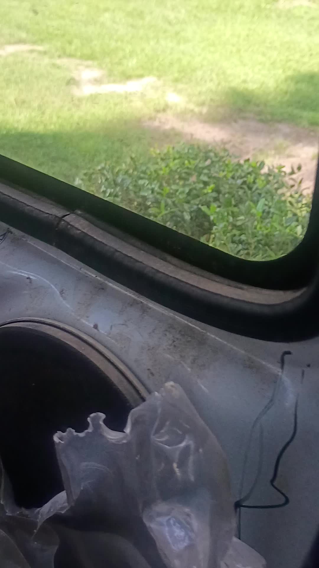

The black marker marks are where I have seen water runs but you can see other spots that have water runs around it all. It's been sitting 10 years without the trim on lol
Sep 10, 2026 at 5:54 PM
STEVE W.
  • 15,351 POSTS
Those all look like the glass seals are bad. Not surprising given the year of the vehicle. The roof though is likely the rear brake light or if someone added marker lights on the roof. For the glass seals, open them and clean the lip of the seals and with them open apply some silicone spray by putting it on a rag and wiping it into the seal. Do that a few times and gently try to reform the seal so it sets tighter to the glass frames. Look at the hinges as well as the pins can wear and the glass doesn't fully seal.

Ok so my friend came out to help me figure out the leaks with a garden hose sprayer set to the jet setting and I sat inside while he started from the bottom of the seams and worked his way around those and then the windows and the brake light. The back cab seams have multiple leaks on both sides. He said he's going to get some kind of seam sealer or something to fix it. I'm going to send you a quick picture of both of those seams and you'll probably see what he is talking about
Sep 19, 2026 at 11:35 AM
STEVE W.
  • 15,351 POSTS
Not uncommon. If they are cracked on the exterior you can go after them with a wire wheel and remove the old sealer and treat any rust in the seam with Ospho, then use a flowable seam sealer and reseal them. Most body shop supply places will have the correct stuff. If you mask off the areas around the seams in a nice even size you can clean out the sealer, put in some black replacement and make them into a "feature".
