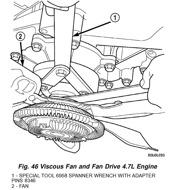

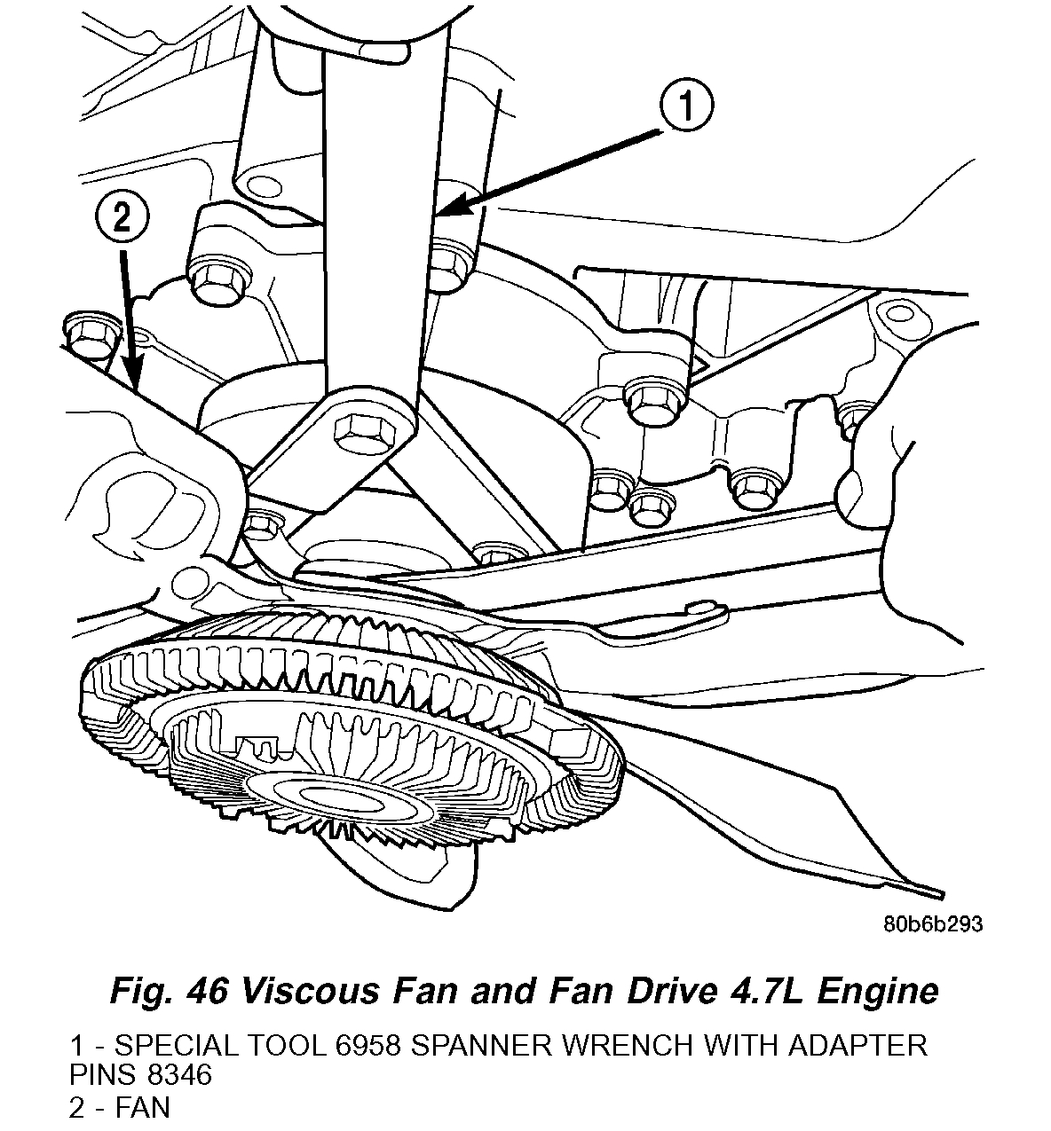

3. Remove fan/viscous fan drive assembly from water pump. Do not attempt to remove fan/viscous fan drive assembly from vehicle at this time.
Warning: constant tension hose clamps are used on most cooling system hoses. When removing or installing, use only tools designed for servicing this type of clamp. Always wear safety glasses when servicing constant tension clamps.
Caution: A number or letter is stamped into the tongue of constant tension clamps. If replacement is necessary, use only an original equipment clamp with matching number or letter and width.
4. If the water pump is being replaced, do not unbolt the fan blade assembly from the thermal viscous fan drive.
5. Remove the radiator fan.

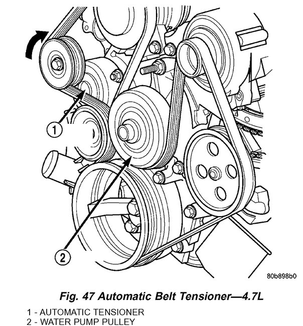

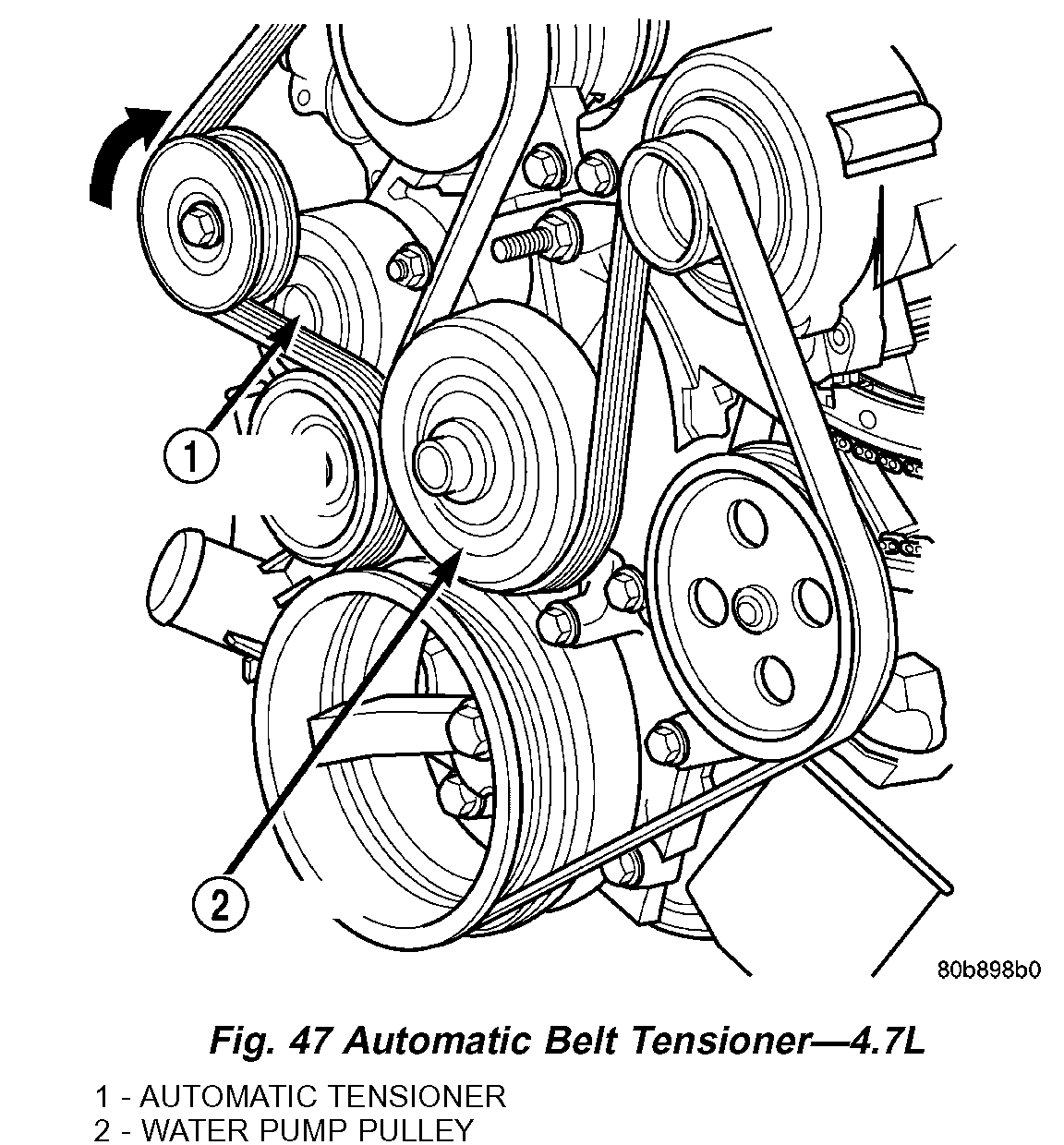

6. Remove accessory drive belt.

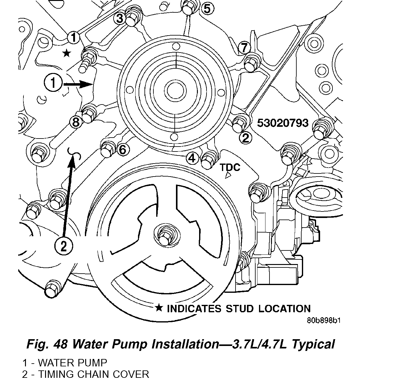

1. Clean the gasket mating surfaces.
pic 3
2. Using a new gasket, position water pump and install the mounting bolts. Tighten the water pump mounting bolts to 58 Nm (43 ft. lbs.).
3. Spin the water pump to be sure that the pump impeller does not rub against the timing chain case/cover.

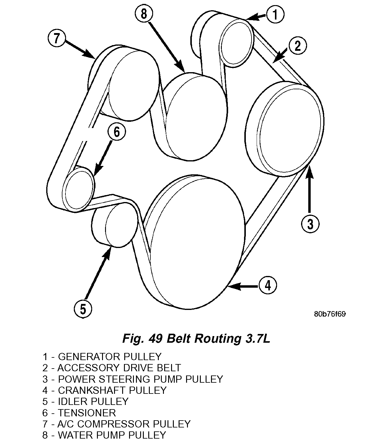

5. Relax the tension from the belt tensioner. Install the drive belt.
pic 4
Caution: When installing the serpentine accessory drive belt, the belt must be routed correctly. If not, the engine may overheat due to the water pump rotating in the wrong direction. Refer to figure for the correct belt routing. Or, refer to the Belt Routing Label located in the engine compartment. The correct belt with correct length must be used.
