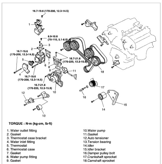

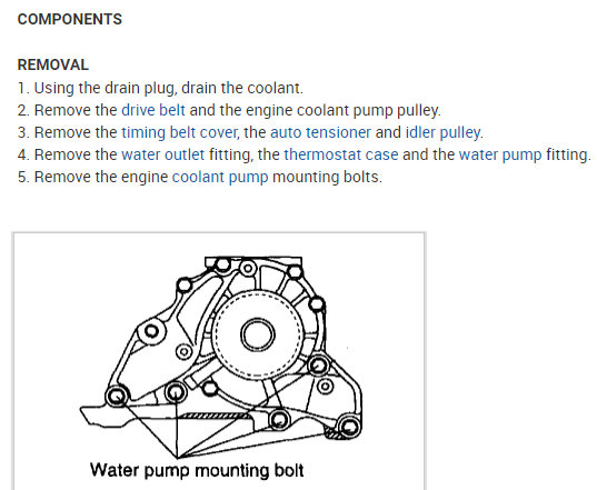

A friend of ours checked and it appeared to be coming from the water pump. Is there a good website/video which explains how to change this on a 2006 kia sorento? I know it involves taking a lot of parts off the front.
Feb 5, 2021 at 9:26 PM
DANNY L
  • 5,648 POSTS
Hello again.

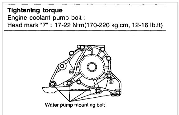

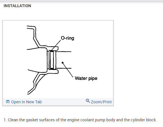

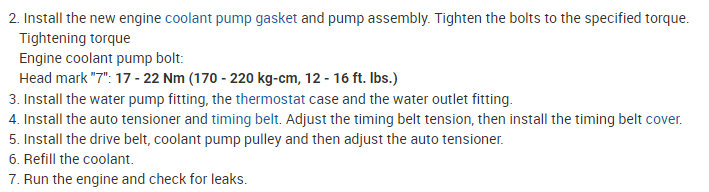

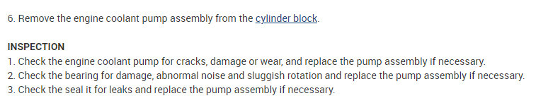

Yes, this kind of information is what our site provides. We are happy to help! Here are a few tutorials for you to view to get you started on water pump replacement:
https://www.2carpros.com/articles/symptoms-of-a-bad-water-pump
https://www.2carpros.com/articles/water-pump-replacement

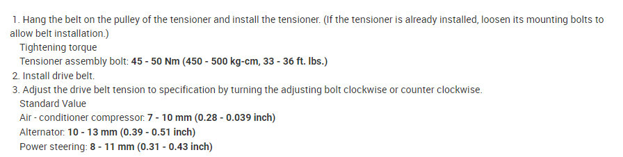

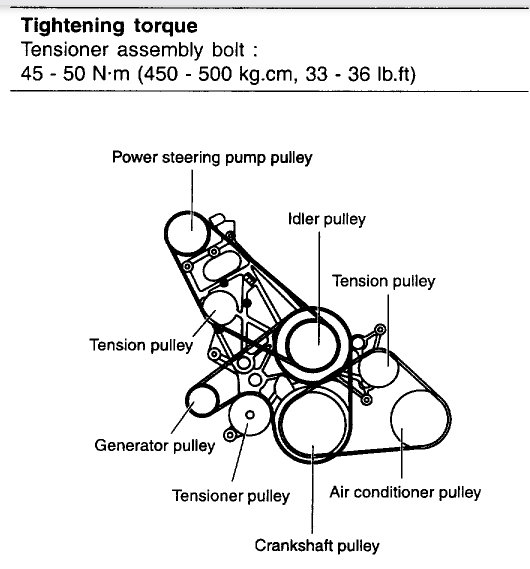

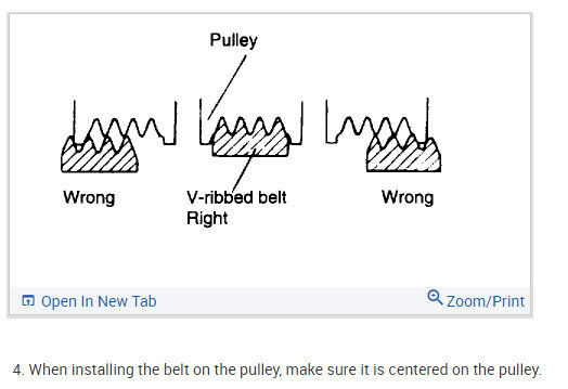

You will need to remove the serpentine belt to gain access for removal of the water pump. Here is a tutorial showing how to remove and replace a serpentine belt:
I've attached picture steps below on how to remove and replace both the serpentine belt and water pump on your vehicle. Let us know if you have any further questions on this issue. Hope this helps and thanks again for using 2CarPros.
