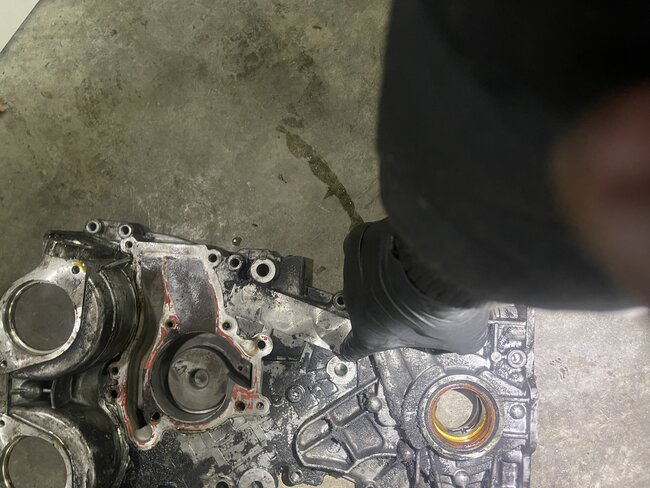

After finishibg the timing chain job including a new water pump car runs great then fan comes on even though its not running hot, no codes. I see water dripping from around the crank shaft pulley, checked the water pump hose that goes to water heater its fine checked around water pump am not seeing anything leaking. Checked thermostat not leaking. Also the reaervoir is full and boiling and the hose around it which has no clamps starting to leak some mist from the pressure. The low radiator hose going to thermostat is not full or that hot. Am not sure what is going on. Car was not running hor before the chain job

I removed the mount and the bracket again, turned out coming from a 12 mm bolt that comes already tightened on the new cover. Supposed to be a torx one but since its after market they used a 12 mm, only had to tighten it a bit and it stopped seeping. Its the bolt on top of where am pointing

But, there is no coolant in that part of the cover, are you sure it was not coming from the water pump? Does the timing cover have a crack in it?
Jan 21, 2026 at 1:00 AM
BHAMDOC1
  • 364 POSTS
no cracks, it's a new cover, there is a bolt in the original and the new cover that is below the water pump, not sure what it's for. it was just not tight enough, it sits right below the pump, ya am 100% sure it was from there and no more leak is coming from it

I don't know what the bolt is for, All I know is coolant is not there on the cover. If you remove the bolt is the hole sealed, can you look with a flashlight?
