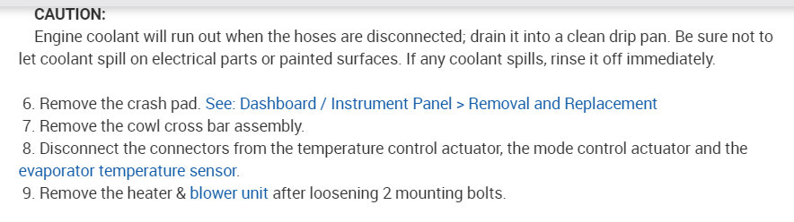

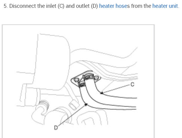

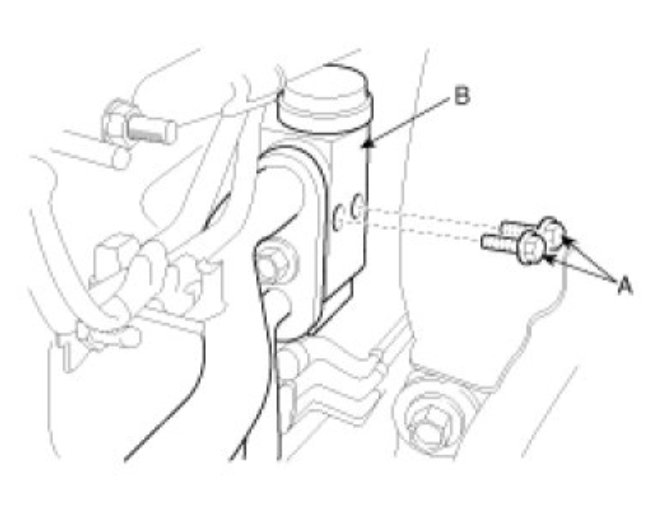

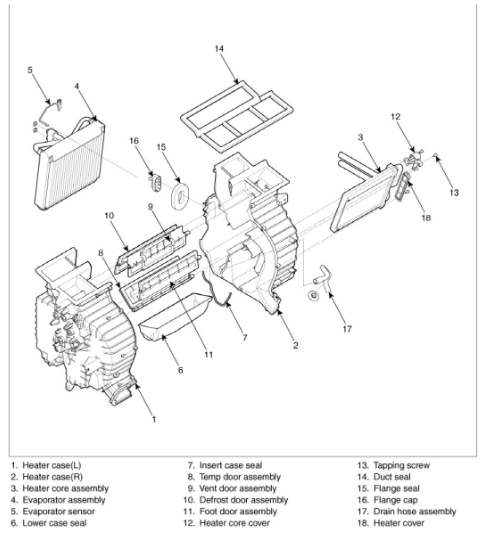

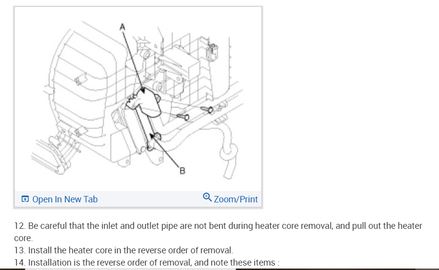

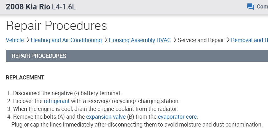

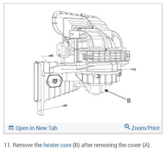

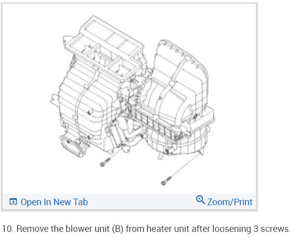

I have water leaking inside my car on the passenger side. it's coming from under the glove box.
May 28, 2020 at 8:36 AM
DANNY L
  • 5,648 POSTS
Hello, I'm Danny.

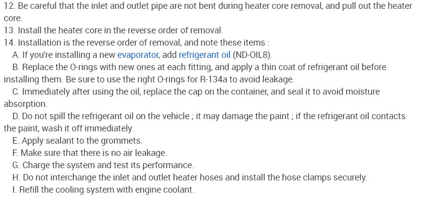

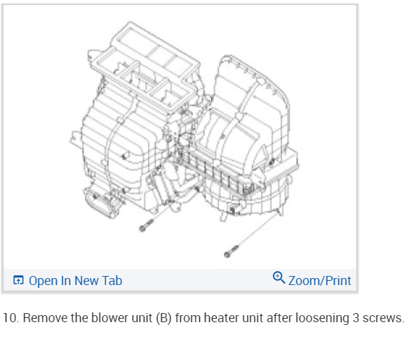

That sounds like you heater core located in the HVAC box is leaking.Here is a tutorial showing how to replace a heater core:
https://www.2carpros.com/articles/replace-heater-core
I've attached picture steps below on how to remove the HVAC box in your car. Hope this helps and thanks for using 2CarPros.
