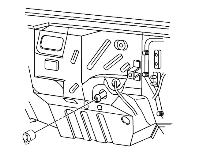

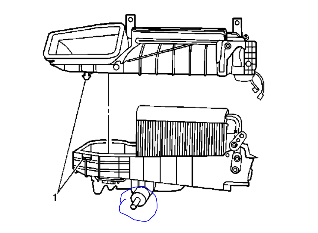

Where is A/C drain tube located?
2006 PONTIAC GRAND PRIX
206,202 MILES
BARRY YRD;EY
Water in car.
Aug 11, 2021 at 9:04 AM
Good morning,
It is under the hood at the bottom of the heater case. I attached 2 pictures for you to view of the location.
Let us know if you have any other questions.
Aug 11, 2021 at 8:56 PM
BARRY YRD;EY
thanks for the info seemed to work okay.
